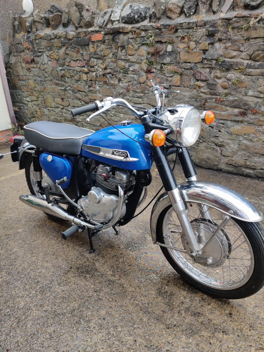

Yes Nick it is 12 volt and I went for the Boyer ignition also fitted a oil filter, the bike start easy even from cold and the handling is surprisingly good the bike is a pleasure to ride, cruising at 50 to 55 mph it feels very happy but I haven't gone over 60 mph as the new rings are still bedding in (only done 200 miles so far), happy that it is ready for the spring and the good weather :-)
Very nice! And I bet when…
Very nice! And I bet when its parked up, you get a lot of What bike is that??!!!
Thanks Mike, I have had some…
Thanks Mike, I have had some strange comments was even asked if it was a Harley Davidson don't think some people can read :-)
Lovely restoration job…
Lovely restoration job Steven and good colour match fro Polychromatic Blue - what colour code / paint did you use?

Thanks Nick, This is what…
Thanks Nick,
This is what was used
Pacific Blue/Lotus. OEM Code A68
The bike now has a front number plate as well so looking good.
