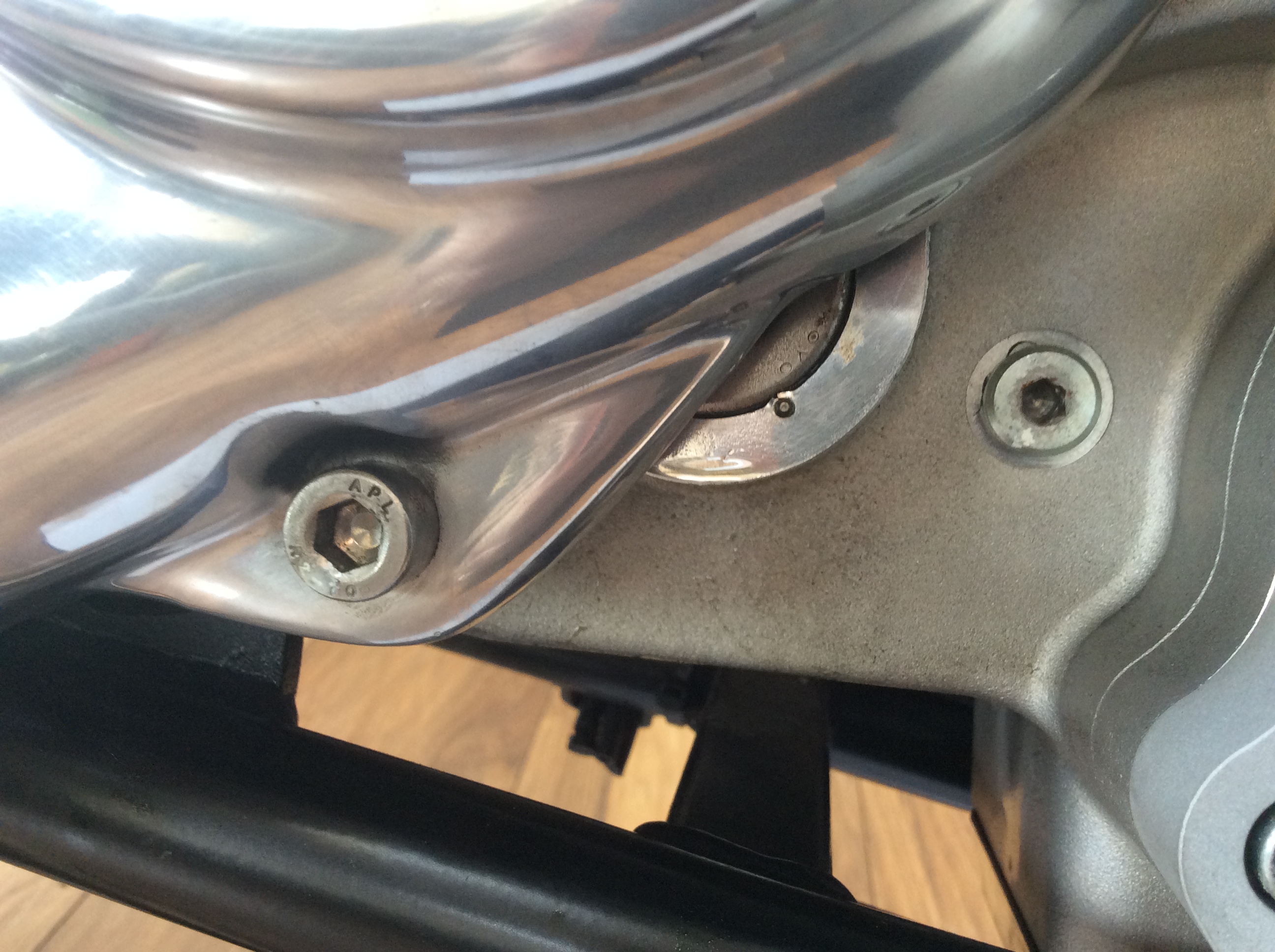

I’ve recently joined the world of Norton’s with a 2014 961SF which has the same issue. Remapping sounds the way to go - do you go through Norton for this or is there a list anywhere of approved establishments that do it?
Also the bike has only 1000mls but has two oil leaks. Under warranty so not too worried but the dealer I bought from has so far been unable to resolve the problems. 1 leak is from the front of the sump - new gasket they fitted hasn’t helped. The second is a bit of a mystery - see pic. Anyone any idea where this could be coming from?

Fixing a difficult commando: call Rob Jameson or Max Muller at Norton Central (01332 811988). Either gentleman will tell you exactly what needs to be done. Dealers seldom have much knowledge about the Nortons they sell. The receptionist will go seek out the guys if they are not immediately available. They always get you back.
961s went through a succession of changes through the years and it is difficult to keep up with the exact state of any one bike e.g. has yours had the oil non-return valve fitted or does it have the revised oil dipstick? The old dipstick caused peeps to put far too much oil in the engine which then p1sses it out wherever it can (usually into the airbox). I have no idea if this is relevant to a 2014 bike.
