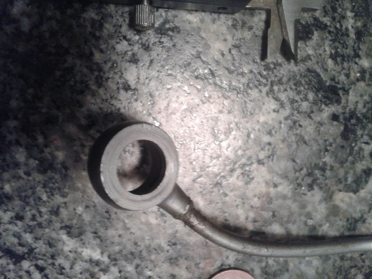

Re: banjo for the oil supply at the Rocker box
After reading a comment by Andy Marks about proper sealing of the washers to the banjo boltâ?I took a closer look and realized mine is a home-made banjo. It is thicker than the proper one and when fitted with the correct washers the supply hole will be blocked.
I can grind it down to the correct thickness by hand. Or swap it with the good one from the other end of the oil line, at the tank. But would prefer to find the correct part.
Attached are photos of the correct banjo which is currently at my oil tank end of the supply line.
I have the old part number; E3/699. This is for the entire pipe with the banjo connections at each end. The parts listing does not list the banjo alone.
Nobody seems to carry this part. Plenty of new and used Commando oil supply banjos but they are far smaller. The ES2 banjo is larger; roughly the size of the AMAL petrol banjo.
If anybody can suggest a source for a new or used banjo please advise
O.D. is 22.35 mm or 7/8"
I.D. is 14.3 mm or 9/16" (approx)
thickness 9.6 mm or 3/8"
Thanks again,
Grant MacNeill, Toronto

Not sure if you know that the washers need to be tight against the shaft of the banjo bolt, otherwise the oil goes straight through missing out the holes! I was thinking of trying some rings but never got around to it!
Dan
Thanks Dan. I see that now…
Thanks Dan. I see that now. I've got copper washers that fit the banjo bolt well so the small holes will truly meter how much oil is getting through.
my problem is that somebody made up their one banjo ...right diameter but too tall and the exit hole is blocked by the washer
really hunting for another correct banjo at the moment...if you have any ideas ?

Long story short...my buddy has turned a correctly sized one out of a chunk of brass so I'm OK

Thanks Andy My 1951 banjo…
Thanks Andy
My 1951 banjo bolt is perfect...it is the banjo that I need. decades ago a guy made one up by stacking two bushings, soldering them together and drilling a hole for the feed tube.
very funky but sort of worked. can't find another actual banjo but still looking
In the mean time I have a beautifully crafted aluminum one that my buddy turned for me which will do nicely for now
it was your comment about the washers needing to match the diameter of the bolt that made me notice the hole was almost entirely blocked. all is well now

I'm way past that point now; the one that my buddy made up on his lathe is going to work fine
that said, just today our main supplier here in Canada, Walridge Motors sent me a real Norton ES2 rocker-box Banjo...right part number and everything. No idea where he found it. see photo.
