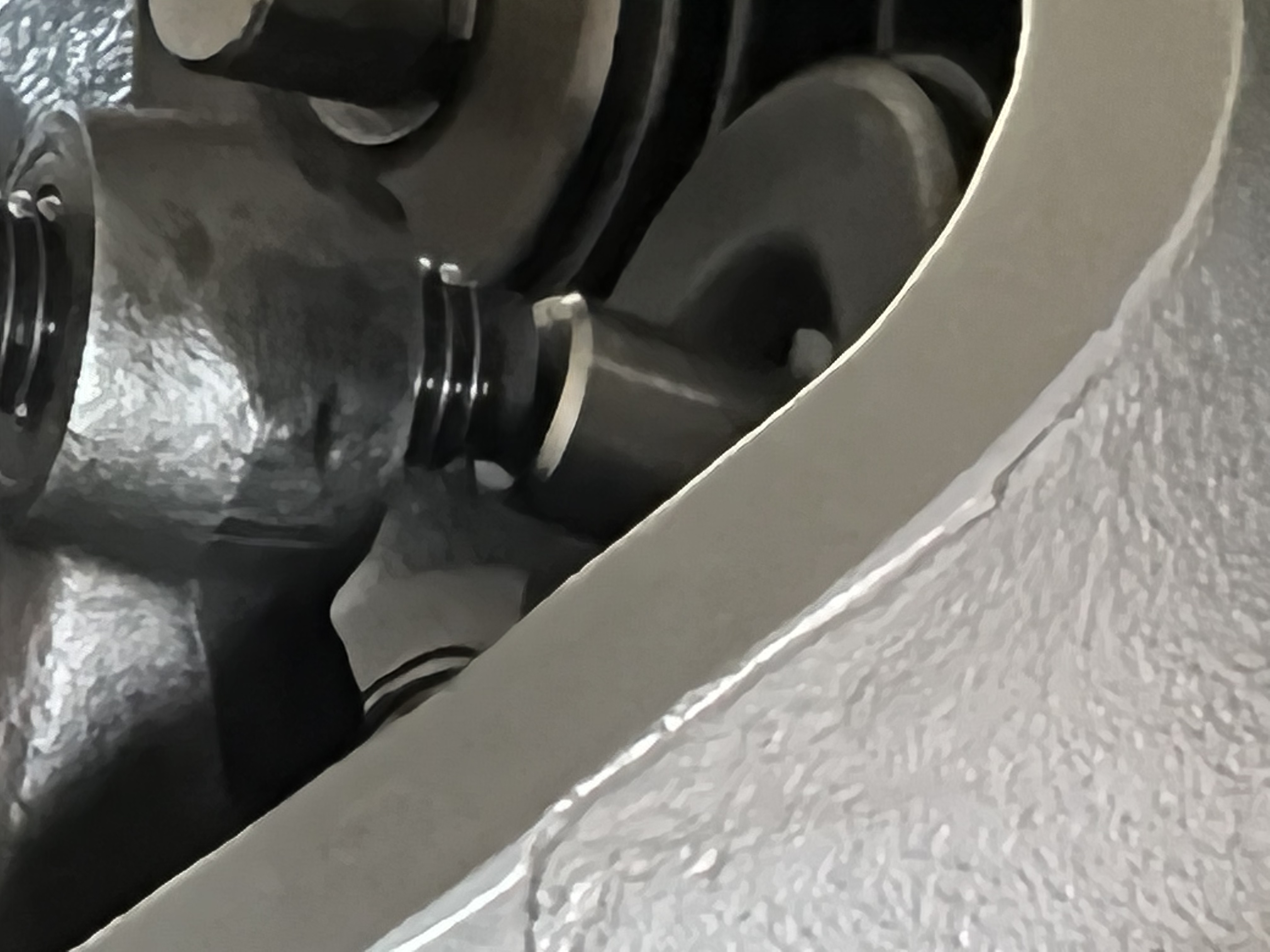

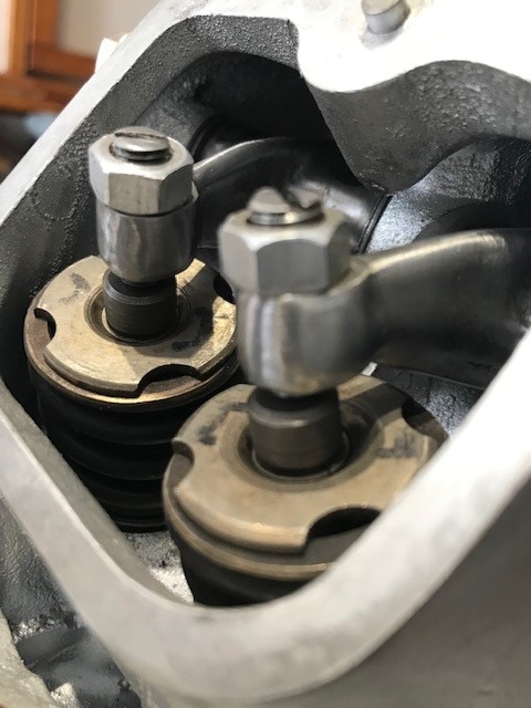

After shimming the rockers to centralise the adjusters on the valve tips in a left to right axis, I noticed that whereas the inlet adjusters contact the valve tips perfectly centrally in all axes, the exhaust adjusters contact at the inner edge of the tips - see photos (inlet photo first).  Nothing that can be done about the exhaust adjuster positioning, but is that intentional/normal?
Hi Andrew,
To improve valve alignment the valves can be shortened and hardened lash caps fitted, available from RGM.
Valves
Regards, Al
