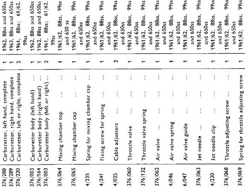

Thanks for the replies, I…
Thanks for the replies, I am just a little bit confused as Benjamin's post for optional twin carbs for 99 are 2x 376/67.
Alan's post for the carbs are 2x 376/220.
Can you tell me if the carbs are the same and only have different numbers or are they slightly different.

The carb that Alan listed,…
The carb that Alan listed, the 376/220, is for the 1961-62' 650ss model. The other carb, 376/67 is what was listed on the NON-SS model 99 that came from the works with the twin carb option or as parts over the counter for a dealer or owner to install.
Because the 99SS had higher compression than some of the standard Model 99s, and a more sporting camshaft fitted, it might need a carb outfitted with different jets etc..
My data is taken out of an actual parts book for the 1961 and 1962 Model 99 bikes. If your Model 99 is an earlier model than this, then the specification may be different and you should seek out the factory parts book and manual for it!
Also, after half a century in which someone could have altered the internals of your engine to who-knows-what specification, you might want to investigate what parts are actually in it so you can compare it's actual specification to what others and the factory did, which might help you get in the ballpark for jetting etc...

Sorry, my fault for being…
Sorry, my fault for being lazy. I thought Andy might not have the jet etc specs. It doesn't matter what the carb body is numbered (obviously as long as it is the right size). The option twin carb set up has the same spec as I have given. I agree with Ben that this is only a starting point. Fine tuning will need to be considered once she is run in.

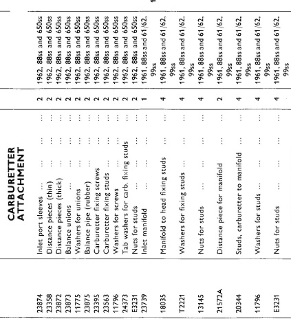

Hi Andy I a have attached…
Hi Andy
I a have attached page 55 from the parts book, page 57 to follow which might be helpful.
As you can see, Norton did not list any standard way to attach two carburettors to a 99SS head, which has polished 1 1/16" inlet ports with the studs vertically above each other. I expect that the 99 head came with smaller ports than the SS, but it looks like it can be opened up as they share the same casting. The inlet port sleeves listed will only fit downdraught heads. All three 99SS's I have ever seen had only single carburettors and manifolds, and I find it hard to believe that retrofitting single carbs could have ever been that popular!
RGM (I think) offer a twin carb adaptors for our type of heads.
The parts list does not include Amal jet sizes, but they look like Amal part numbers, and it might be possible to cross refer them to a specific throttle slide cutaway using Amal data. Unfortunately it says "Main jet (specify size)" on page 58, so that has to be tuned for the individual bike.

Steve Marshall, if you loo…
Steve Marshall, if you look at page 55 from your own parts book, part# 23739, it says is a manifold for the 88ss and 99ss.
This part did indeed look like a machined block of alloy, and manifolds like it were made and used by Norton to put twin carbs on motorcycles since the 1953 Daytona racers, long before there were any companies like RGM selling replica and aftermarket parts for Nortons. They are a simple part that is easy to replicate. Also of course they were made in different sizes over the years to fit the two different spacings between the studs of early and late Dominator heads.
Your parts list also has a quantity of Four studs to hold the manifold to the head, four studs being needed because it bolts onto the four holes above and below the two intake ports on the back of the cylinder head.

Ben, I think your comments are rather harsh but I agree about the manifolds. I had a look through mine. The earliest that I can date one is 1965. That is from a 1954 88 that had been used for club racing in the early 60s. It was my first Norton motorcycle and I acquired it in 1965. The vertical spacing of the holes for the studs on the head is 1.5 in. I have another that is identical but I acquired it later. I have always believed that these are Norton parts. I thought I had one but with 1.625 in spacing for the later head. Can't find it! That also I thought was Norton. The one on my running 99 is an RGM close copy and obviously also with 1.625 in spacing. I tried to upload some photos with good enough resolution to be useful. I failed. To give the purists apoplexy, I should point out that my 99 is a de-luxe, converted to cafe racer, and with one carb from a 650SS, and the other from a BSA sidevalve.

I have checked the Norton 1962 parts list at some length, and all the twin carb options are very specifically only for the 650SS and the 1962 88SS.
The earlier Nomad had a twin carb option with tubular stubs (see pic) and there were (and still are) twin carb adapters available for non-draught heads in the form of single alloy billets.
It has been said that all SS Dominators came with twin carbs, and I am virtually certain that is not correct in respect of the 99SS and 191 88SS. In fact I cannot find any documentary evidence suggesting that it was ever a catalogue option for the 99SS at all. If you have anything I would be very interested to see it. There is a 99SS with a single carb on eBay right now with good close ups.
Best Regards
Steve
Best Regards
Steve
