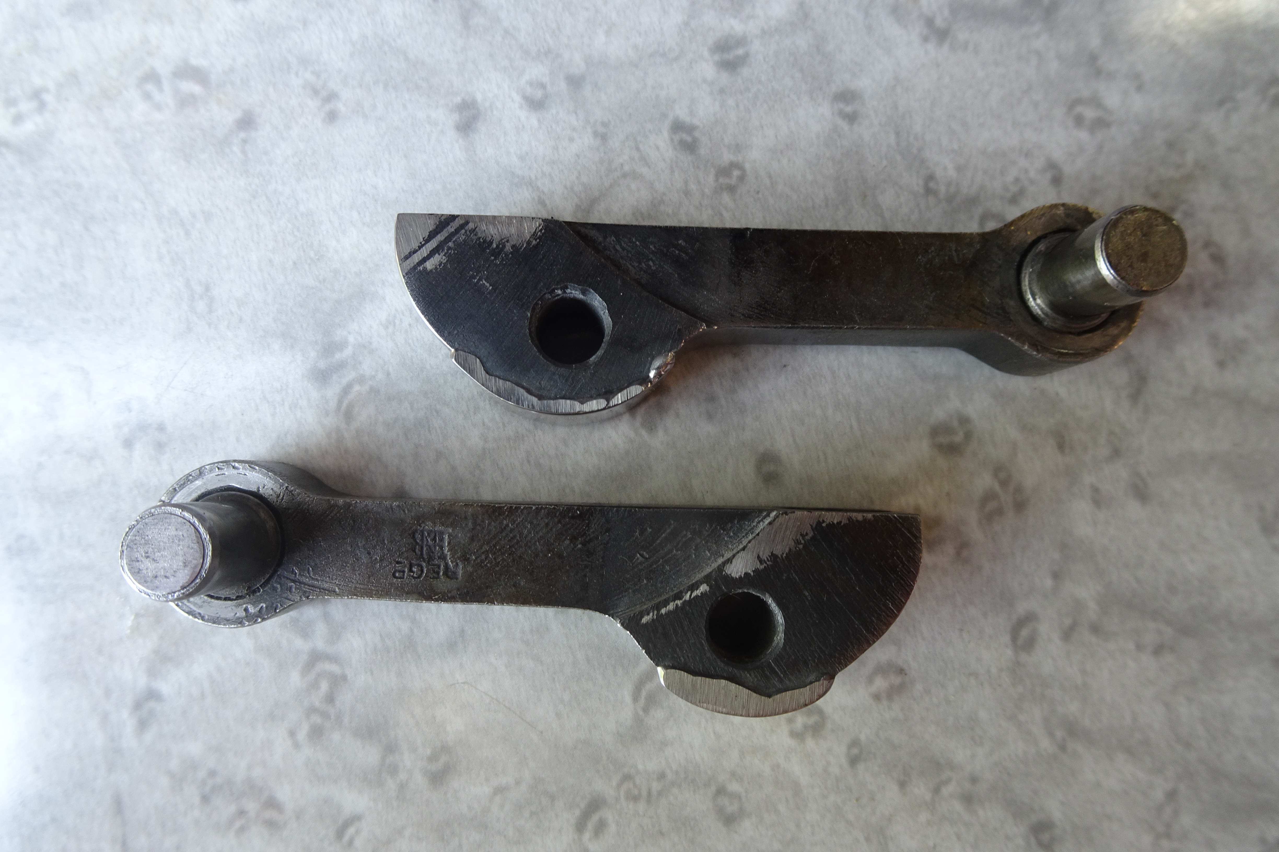

My 1931 Model 18 has worn cam followers. These are the radius type and the wear is causing the valve open duration to be extended due to the change in position of the cam to follower contact point. I have sent the cams and followers to Newman Cams for reprofiling. Ken Newman has asked me if I can supply a drawing of the follower, or a good example so that he can recreate the correct radius. Does anyone have information on the follower profile, or a good example follower that Newman could copy?

Thanks Jon for highlighting those, I hadn't spotted them. They are not an exact match for mine, not shown on my photo is a socket on the upper face which locates the end of the pushrod. Would have been good if the seller had shown a side view to compare the profiles, but I could request that.

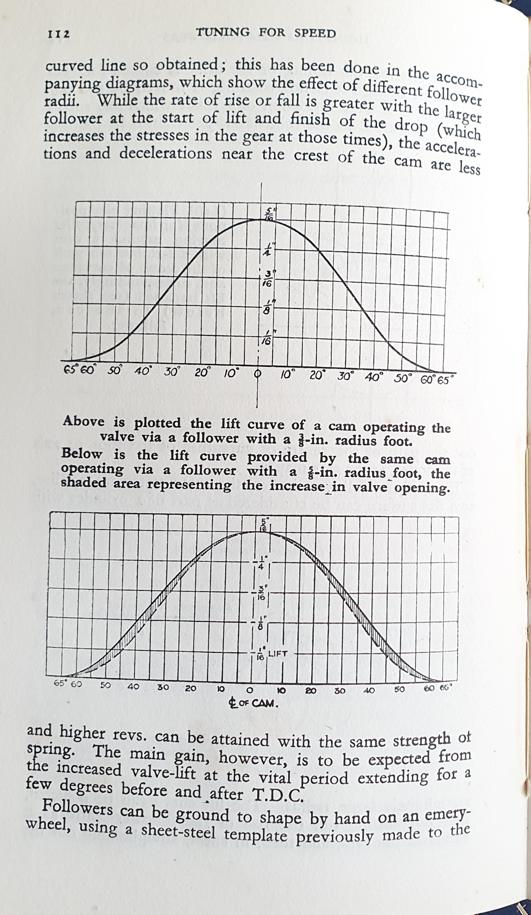

A couple of pages from 'Tuning for Speed' on cam follower profiles.  Also warning that case hardening might be desirable.
Note he points out that changing from flat to curved followers doesn't change timing (because lift starts at the same place when the cam lift point reaches top dead centre).

I am trying to resolve a valve timing anomaly which may or may not be responsible for reduced power from the Model 18. The open durations of both valves are longer than they should be, by approx 30 degrees for the exhaust, 20 degrees for the inlet. Thinking there was something odd about the cams I swapped them for another set. It made little or no difference to the timing figures. In "Tuning for Speed" Chapter 11 Phil Irving describes how wear on radiused cam followers can extend the valve open duration (as described in an earlier post). As an experiment I wired a strip of .008" shim to the exhaust follower, covering the worn area. The shim stayed in place long enough to check the timing figures over 1 cycle. The exhaust values were restored almost to maintenance book values. From that I think it will be worth having the followers restored to original profile, or at least a close approximation.

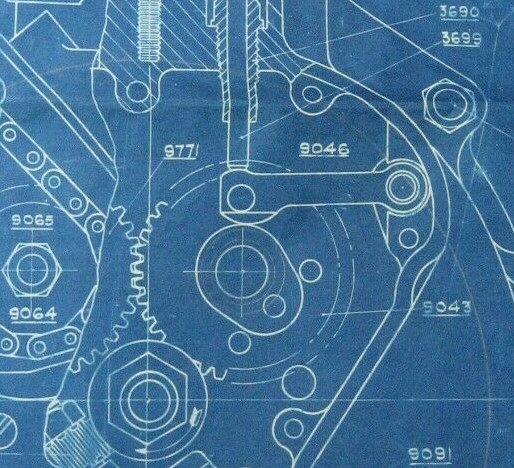

Some time back, there was a spare parts WD16H Engine blueprint on eBay. I was outbid but managed to get some better scans from the buyer.
Obviously, a different period and engine so probably irrelevant and not dimensioned anyway, but it would be a shame not to share if there might be some information useful to someone who knows what they're doing.

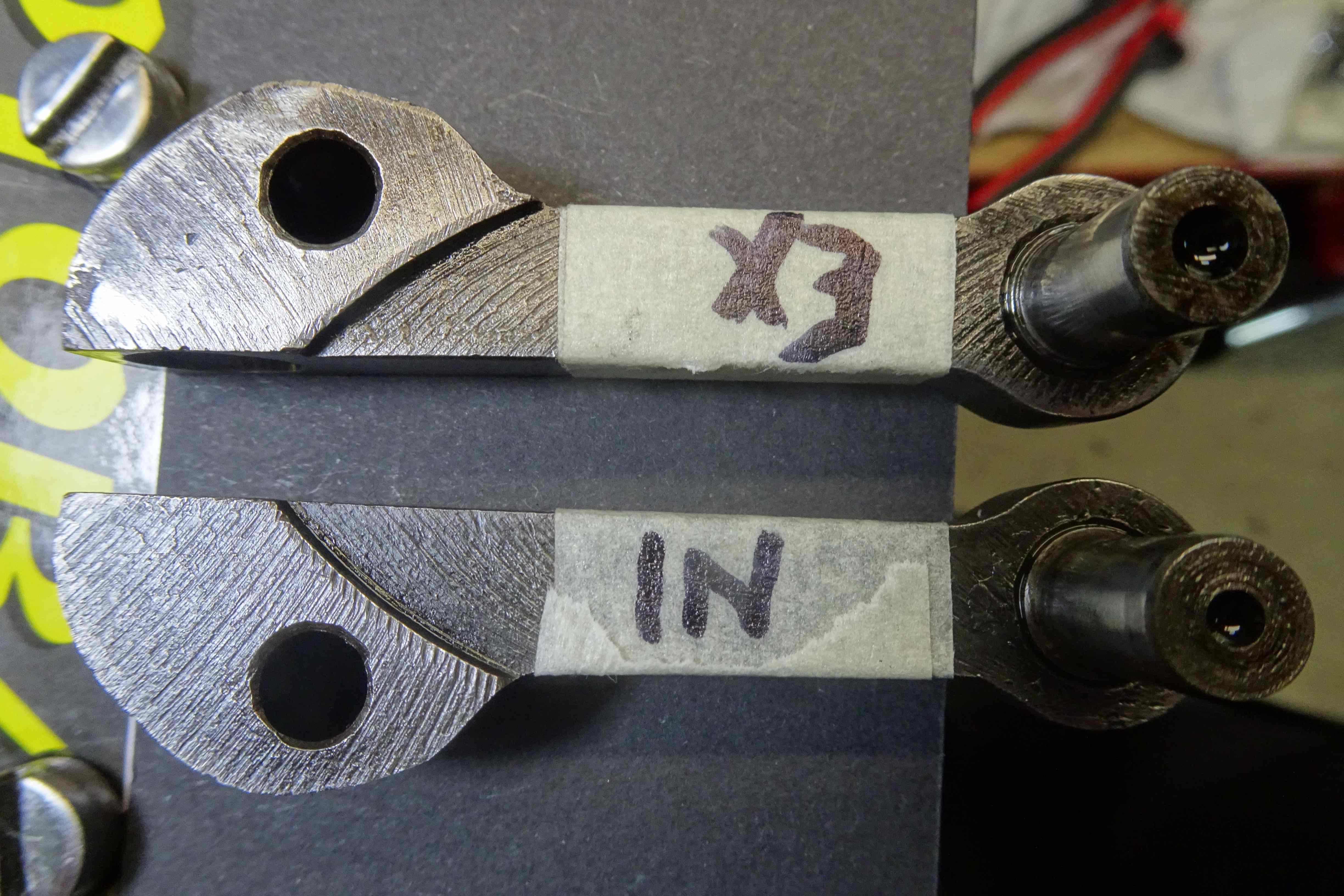

Today we measured the best portions of 3 followers using radius gauge.  I have a link somewhere on the effects on combustion of late and early valve operation.  Will send it for interest value.
I have spoken to Newmans this morning and given them the 15/32" figure. Ken must have had my follower somewhere close by as he was able to say that mine is nearer 1/2" but not a constant radius. He will do as we discussed, build up the worn area then regrind to a close estimate of the original profile.
Richard's blueprint highlights another possible area of confusion. The part numbers on the blueprint of the later engine are the same as the earlier engines eg 9046 is the cam follower/rocker for the early 30s sidevalves and for the later engine shown above. There must have been several versions of the original detail drawings, plus information either on the drawing or in a separate document indicating the model year or engine number to which they apply. One less worry for us as we don't have the drawings anyway.

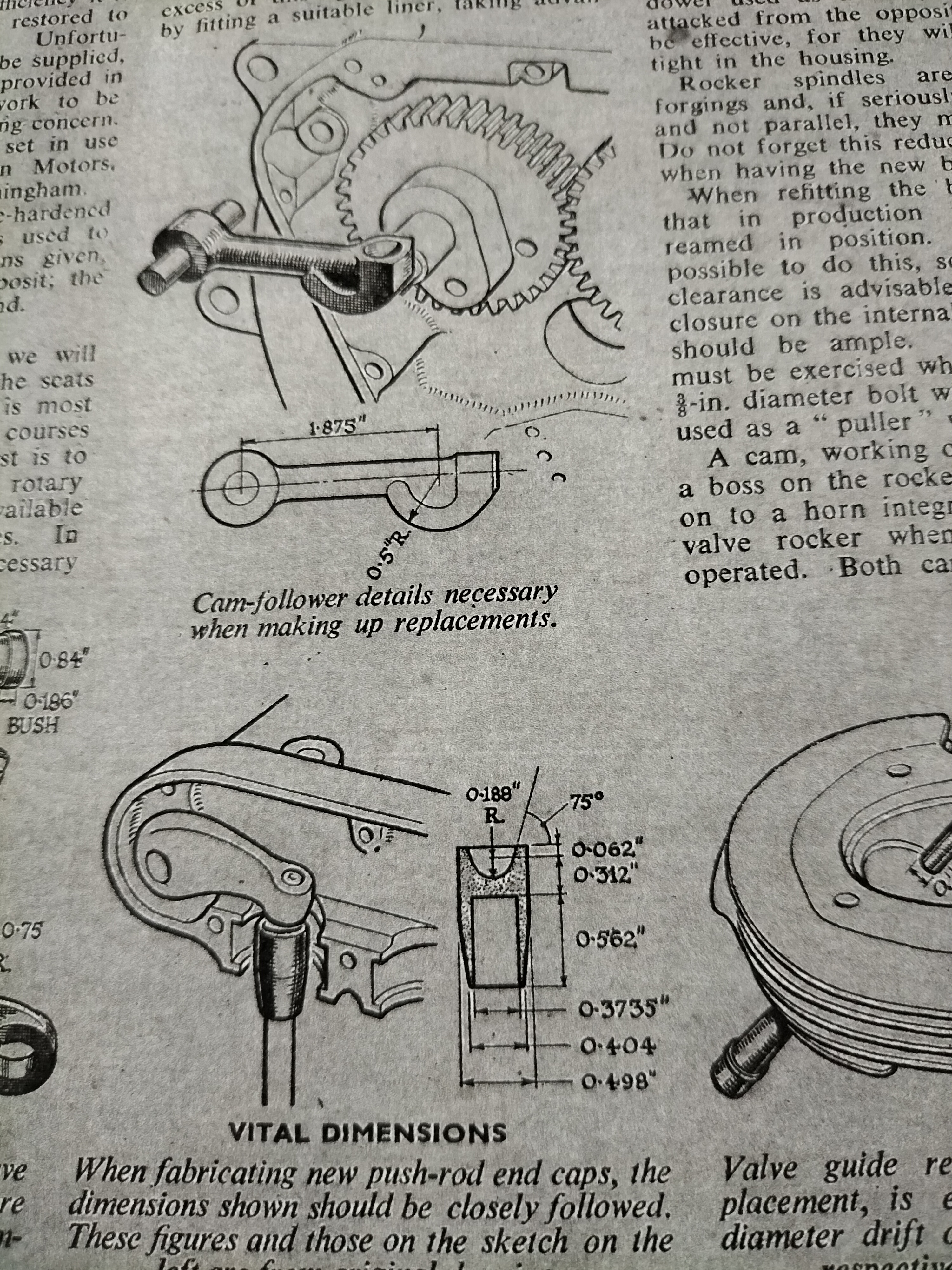

I remember the request for information on Model 18 Cam follower profile. The attached article from Motor Cycling April 1954 caught my eye in a junk shop in Settle. (Wife browsing new pullovers in adjacent shop). Now, I know nothing about Norton singles, being but 3 years old in 1954, but visually the bottom half of the sidevalve and OHV engines look similar.
To my eye some really useful information for Norton single owners. And a very good detailed drawing of cam follower at the end of page 2.
I’m hoping those interested can download and save/print the article. If you unable and would like this old magazine, email me directly. I’ve had my £2.50 worth and it cost me two new pullovers.
