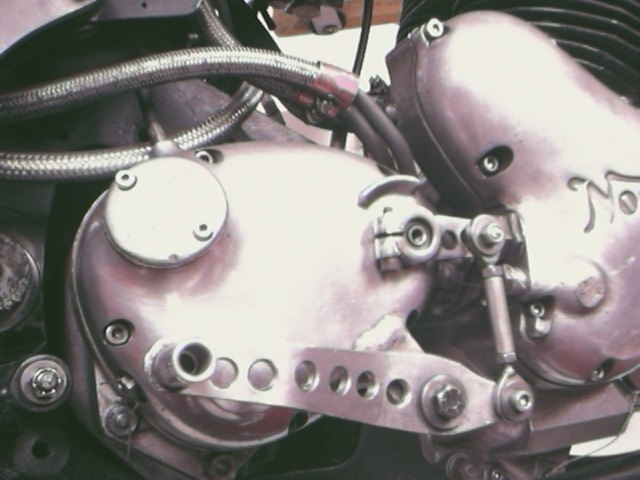

Hi All, I've noticed that 1st gear lever travel is quite a bit more than when I select 2nd gear(about 50% more) is there something that can be done to reduce the amount of travel when "going down the 'box"?

Shorter lever, but not so…

Sometimes the set of the pawl spring will make moving the pedal in one direction longer. Try adjusting the spring so that there is a slight clearance on both tips of the pawl and it it sitting in a neutral position.

If you're using one of those…
If you're using one of those hideous Tickle-style gear linkages then eliminating slop in the pivots will make a worthwhile improvement. Better still, throw the linkage away and use a standard gear lever fitted in reverse (you might have to 'alter' the kickstart to suit).
Better again:
Shorter lever, but not so short you can't get your boots under it.
