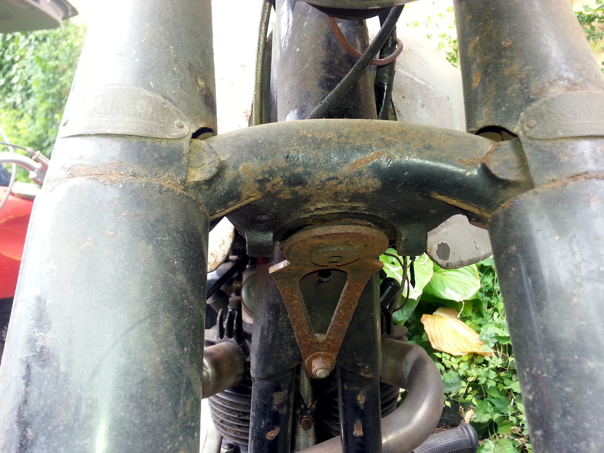

I swapped my 7 inch forks for 7-3/8 but now there is nothing to prevent the forks hitting the tank. The old lock limiter no longer works. I have uploaded pictures of the old and new yokes. Does anyones have a photo or diagram of the lock limiter for these other forks (with no lumps below to hit the lock limiter). I am willing to make one.

Jonathan, you need RGM part No 050514 but be prepared to weld a tiny blob of stainless on each corner. I had to on 2 out of 3 of mine. It is very close to the tank so try it out with just the bottom fixing screw first as the top hole is a bit of a bug*er.
Your earlier steering stop is excellent for the 7" centresbut will miss the stops on the bottom yolk on the 7 3/8.
I took a look. It is an expensive item, also there is no picture. I hope I am not a bad sport for wanting to make my own. I am retired and there is a definite limit to what I can buy.

There is a picture Jonathan, use the new RGM site called premier..... Click on shop and then go in stainless .....You will see the picture and the price.
Found it. Thanks.

Well its really called a s…
Well its really called a steering head stop and there are 3 types the one you need I have one somewhere amog my junk pile , see if I can find it, yours anna j
Previously anna jeannette…
Very kind of you Anna.
