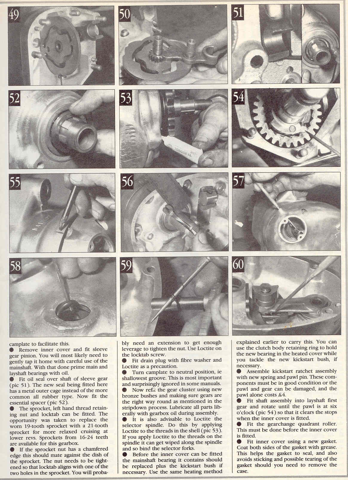

My guess would be that the Gearchange Quadrant Arm is one tooth out in relation to engagement with the Camplate gear.
In the photos below check out number 50.
These photos are from the AMC box rebuild book but the LayDown box contains many similar parts.Gearbox Chunks
