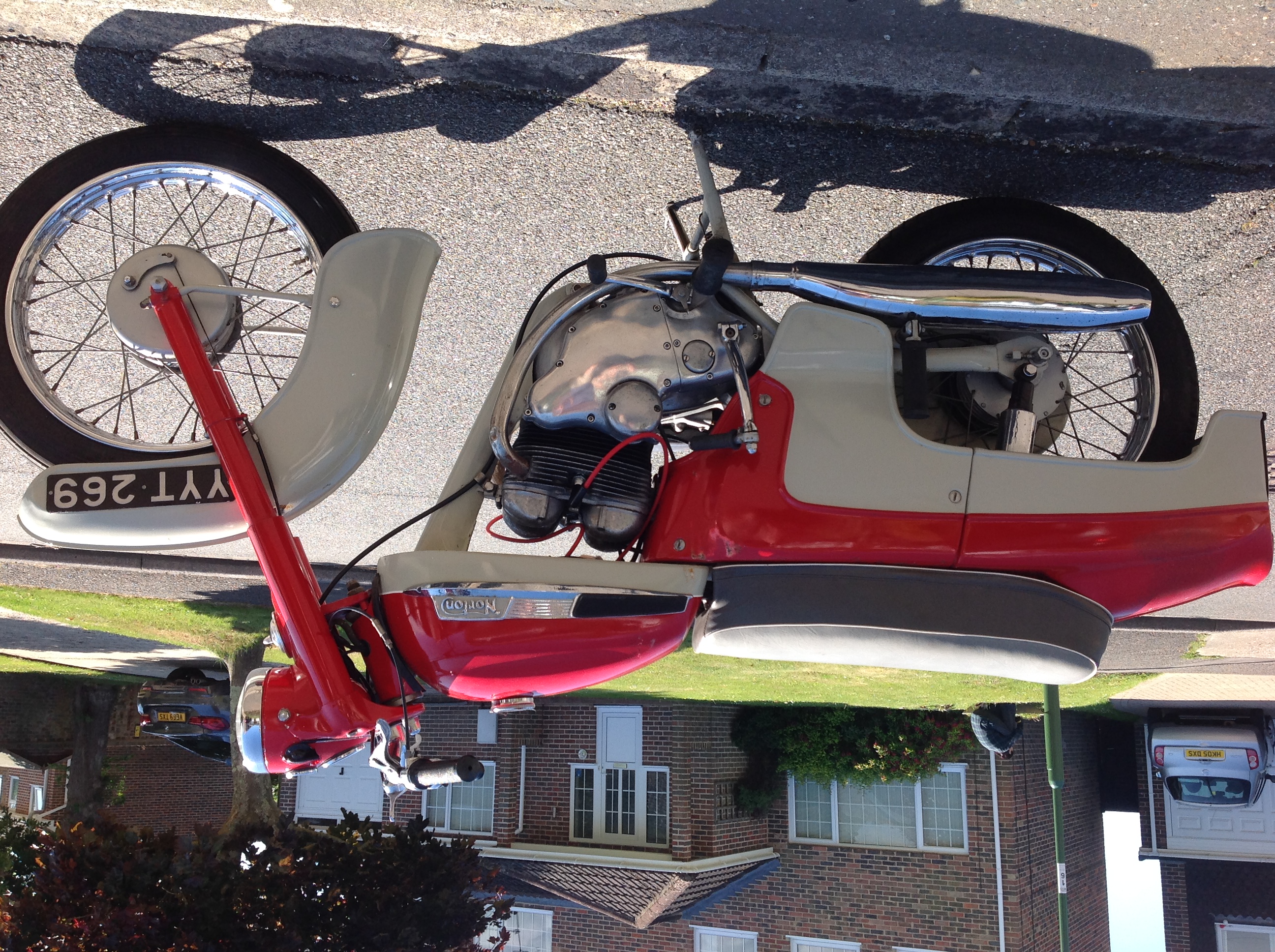

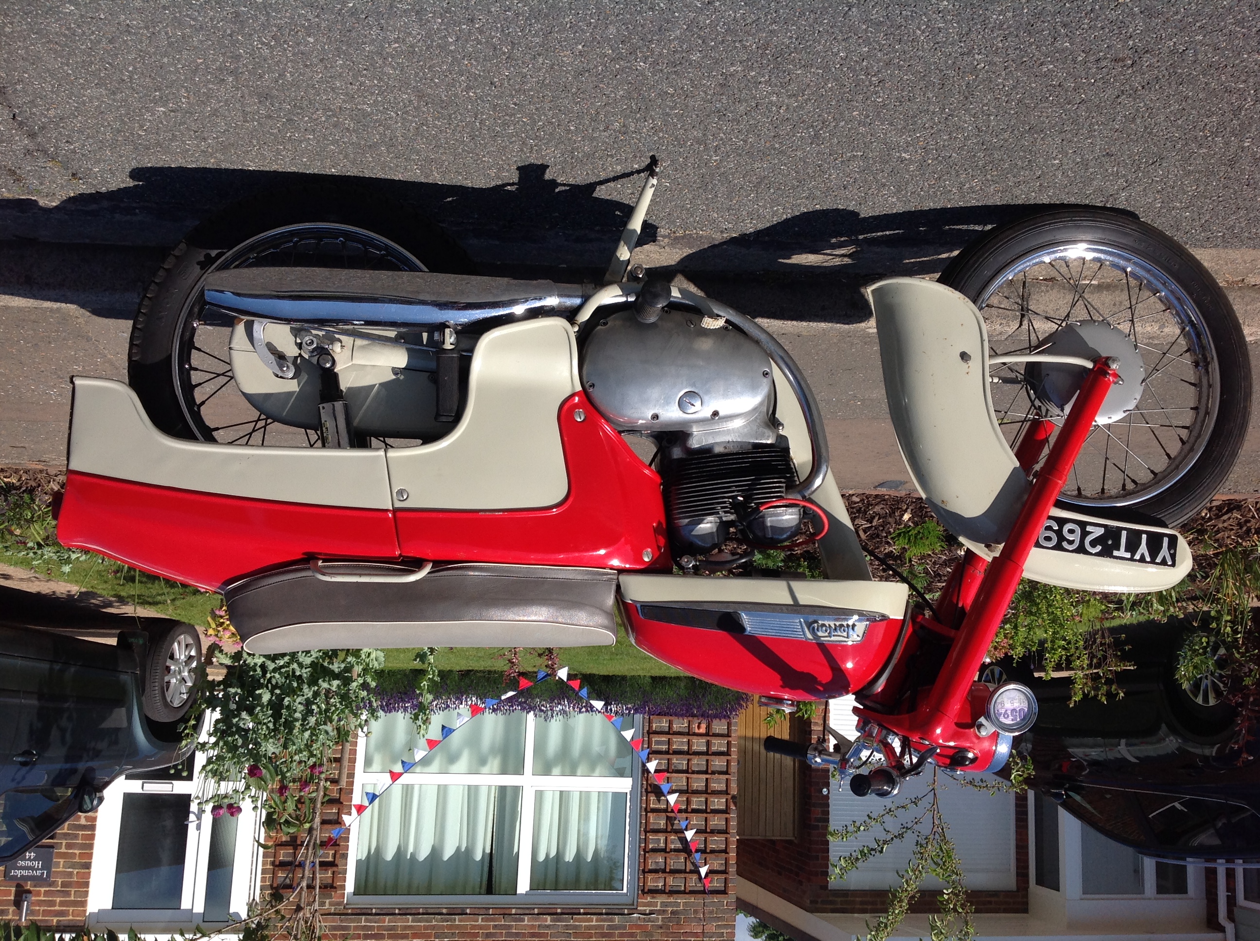

Your photo suggests that you have a Navigator de-luxe. With rear fairing.

I had always assumed that my bike was a Jubilee? Now I am confused. The original oil cap is still fitted with the dipstick attached so checking the level is easy.
My bike was first registered in April 1960, the engine/chassis numbers seem to be correct starting 'R17'. The bike began life as a blue/dove grey machine but received a complete overhaul in 1993/94 and change of colour to red.

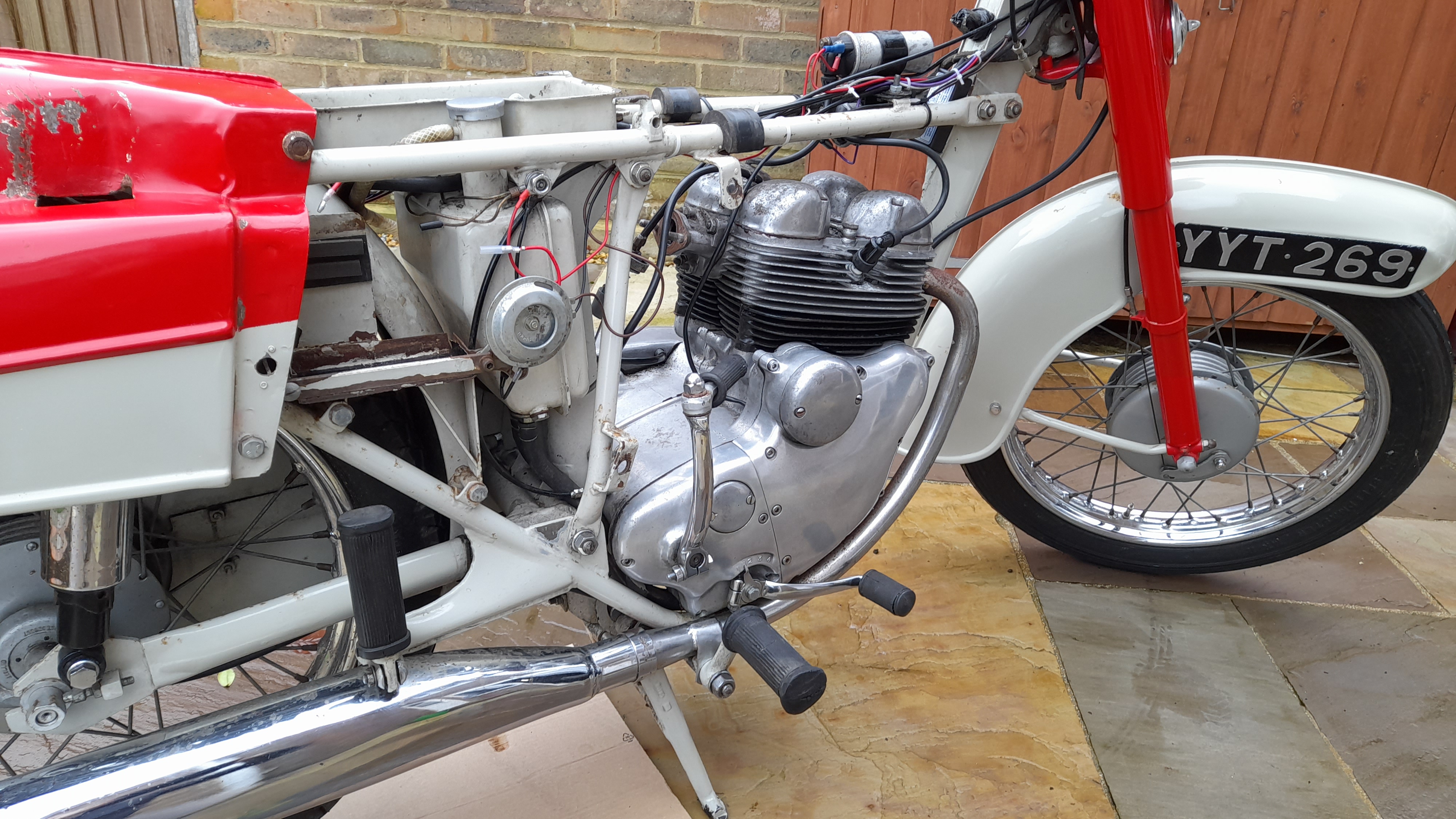

I have attached another or two but I need to read up on the difference between the two models?

Hi Ian.
Your pictures very much suggest it is a Jubilee, the forks are lightweight as used on the Franny B, and the head mounting is jubilee not Navigator, the frame mounting and clamp are different. We all suffer from wet sumping on Nortons some more than others, I always drain the sump if the tank level has lowered a lot while standing. Looks a nice bike, happy riding.

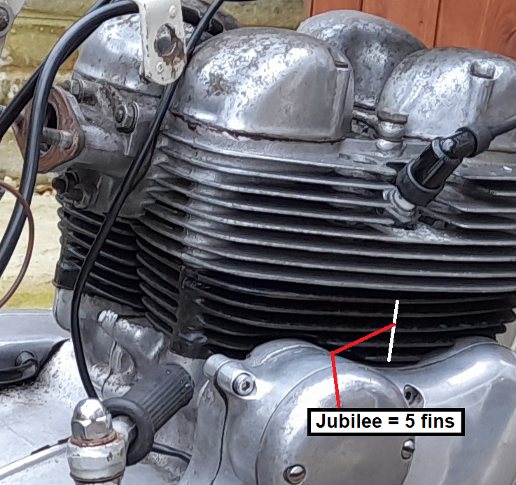

Several giveaways - Forks & frontwheel suggest a Jubilee (but a Navi engine could be shoehorned in) - so not definitive.
However, the engine size can be determined by the Head Steady arrangement, as Navi differs in that department - & yours has the Jubilee setup
PLUS, if you count the fins on your barrel, you have 5, whereas a Navi has 6
