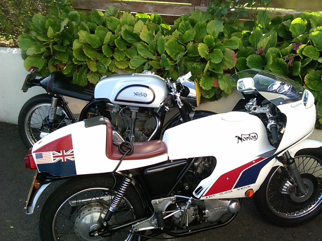

Sorry messed that up
I had intended to say I have some parts left over from the two bikes in the photo.
original fairing bracket ( front) original number plate mount bracket, two or 3 screens, two headlights, fairing decals from the build of the not so original Mk3 JPN and lots of photos of the original bike.
the parts are on way from Australia with my other stuff, we are returning to UK after 16 years in Australia.
Trust the machine are coming too!
Great looking bikes; still got the “Avon” badge in front of nacelle. Some nice improvements on the Mk3.
