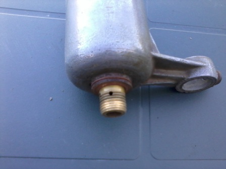

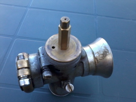

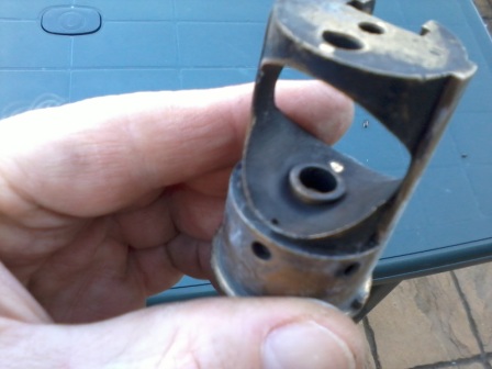

Hello again. Here are the…
Hello again. Here are the photos I have taken this evening... first of all showing the actual carb
I'm assuming these are th…
I'm assuming these are the two small holes to which you have been referring, one just inside the mouth of the carb passing through the body of the carb where the pilot screw locates, and the other by the main jet I think? Is this right?
I ahve given them a clean out but I'm planning on taking the entire carb body and block to work where I can ultrasonically clean them to remove any crud.
and finally a couple of ot…
and finally a couple of others showing drillings in fittings to float chamber and bottom of carb... not the technical terms I'm sure, but just to see if these are how they should be with a view to flow of fuel.
Okay gentleman... please add your comments and suggestions, if only to confirm what you said yesterday evening... thanks once again.

Yes, Roger. Those are the…
Yes, Roger. Those are the bits. It looks like the original Type 76. If you blow through the various orifices after cleaning, it's fairly obvious what goes where, but the tiny opening in the larger boring on the front edge of the block is critical to the pilot mixture. The jet block is actually soldered out of three parts so there is more to it internally than shows at first glance.
I see that your carb is fitted with a 'short' mixing chamber nut. I 'thought' (always dangerous) that these short nuts were typically fitted to side valves which need a rich mixture to aid the pick-up and that OHV engines generally had the longer nut. The presence of the short nut might suggest that a previous owner had substituted components in an attempt to cure weakness which might mean that he failed to get the jets clear or that other parts are incorrect.
It might be worth noting down the carb body number, slide cutaway and jet block number (It should be stamped '30' I believe).
There is something slightly odd about the shoulder inside the carb stub too. Is it damaged and causing an air leak or does it clamp up properly ?

Thanks Richard. I have jus…
Thanks Richard.
I have justhad the various components ultrasoncially cleaned here at work (one of the perks of the otherwise drab job...), so everything should be nice and clear now.
Will give it all a try when i get back.
The shoulder you mentioned seems fine, by the way, it looks like a trick of the light in the photo i attached, as there appears to be no damage to it in reality.
I'll note the all the number details too, for future reference.
