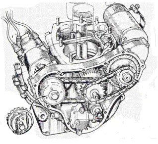

If you are going to dismantle the engine, then you will need to get or make some special tools.This will possibly help tosave you a lot of timeand prevent damage to the engine.
To get the crankshaft out of the engine, you have to first remove all of the timing cover contents. ie oil pump, oil pump worm drive, cranshaft pinion,magneto sprocket, camshaft sprocket, half-timing pinion and dynamo pinion.
The oil pump worm drive sits on the end of the crankshaft and has a left handed thread. It is the only left handed thread on the engine. Behind this item sits the the crankshaft pinion. From my experience of removing these from old Norton engines, you will need a pinion puller and lots of heat to break the seal caused by years of old oil gluing the parts together. Trying to use levers on this item often leads to big dents or even holes in the cranksases.
Anna Dixon was quite correct when she said that, with the Model 7 engine, it could be a little difficultremoving the crankshaft out of the casesif the tie bar across the crankcase mouth has been kept. Lots of owners cut this item off to make dismantling and rebuilding easier. The problem with the tie bar is that it will not let the crankshaft slide out though the timing side main bearing. You have to heat up the cases and drive this bearing out while it is still on the crankshaft. Not an easy job for one person.
You will have to get someone to help you by holding the cases while you remove the crankshaft or make up a frame to hold the engine on its side.
On rebuildingModel 7engines, with a tie bar, you have to fit the timing side bearing onto the Crankshaft, then heat the cases beforesliding everything into place.
Hopefully, with this messagethere should be a diagram showing the insides of the engine.
