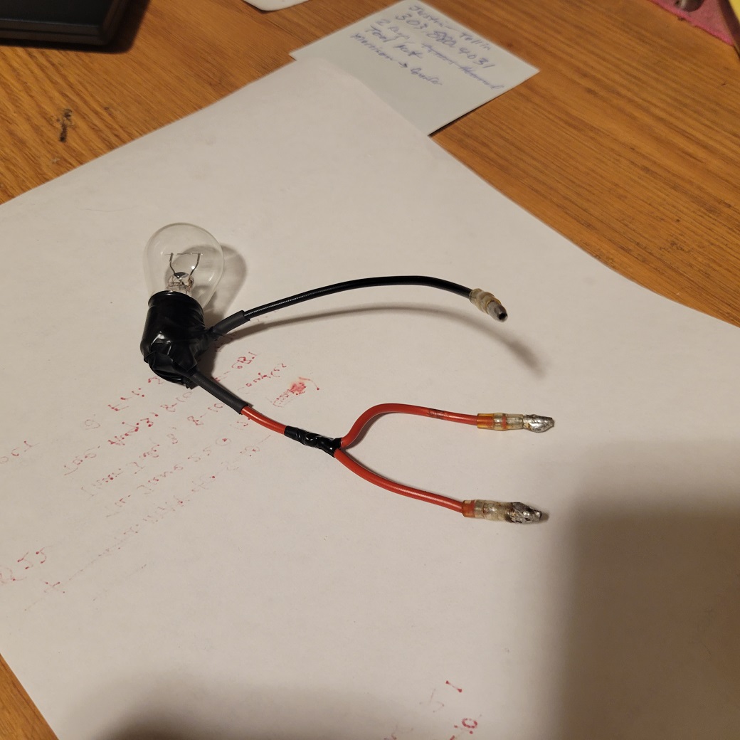

Alan, following your instructions, here is the test light i made up; hopefully it is as you instructed.
i did polarize the generator, i heard a little click at the same time i saw the tiny spark, so i assume the job is done.  i think before i check the generator output with the test light, I will go out for another ride and report back.
... will be the dynamo trying to motor against the resistance of the engine so you sound as if you're on the tright track.
The click is a small amount of power going through the Field coil and the spark is correct. It is not any attempt to turn the dynamo as the test above puts power into the Field only not the D armature.
Otherwise the testing looks good. Apart from the fact that it looks like you are using an indicator lamp, it will work but the lamp will blow if you give the engine a bit of a spin, Headlamp is best. Can't see why you don't check for Dynamo output before the ride though?
