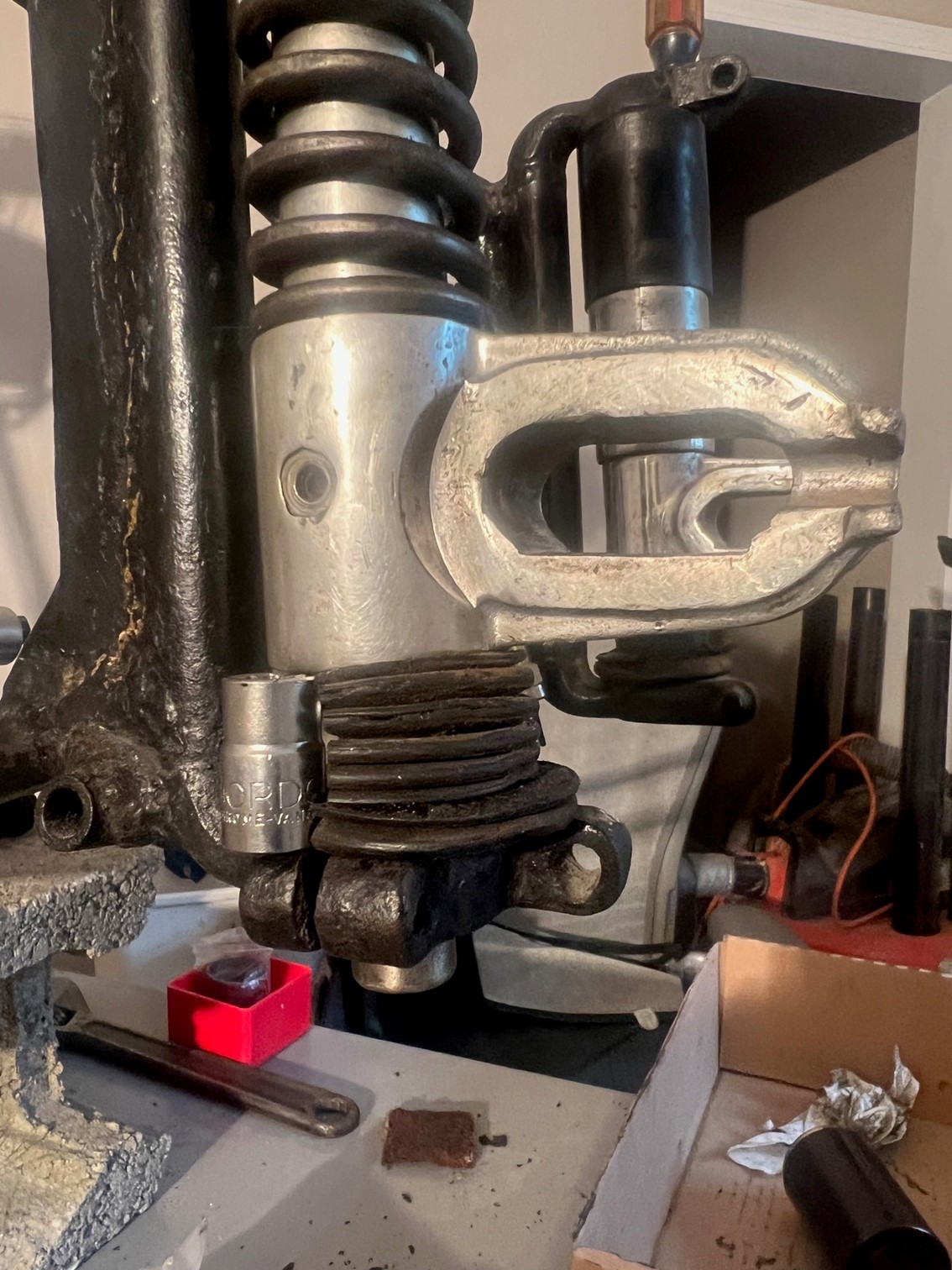

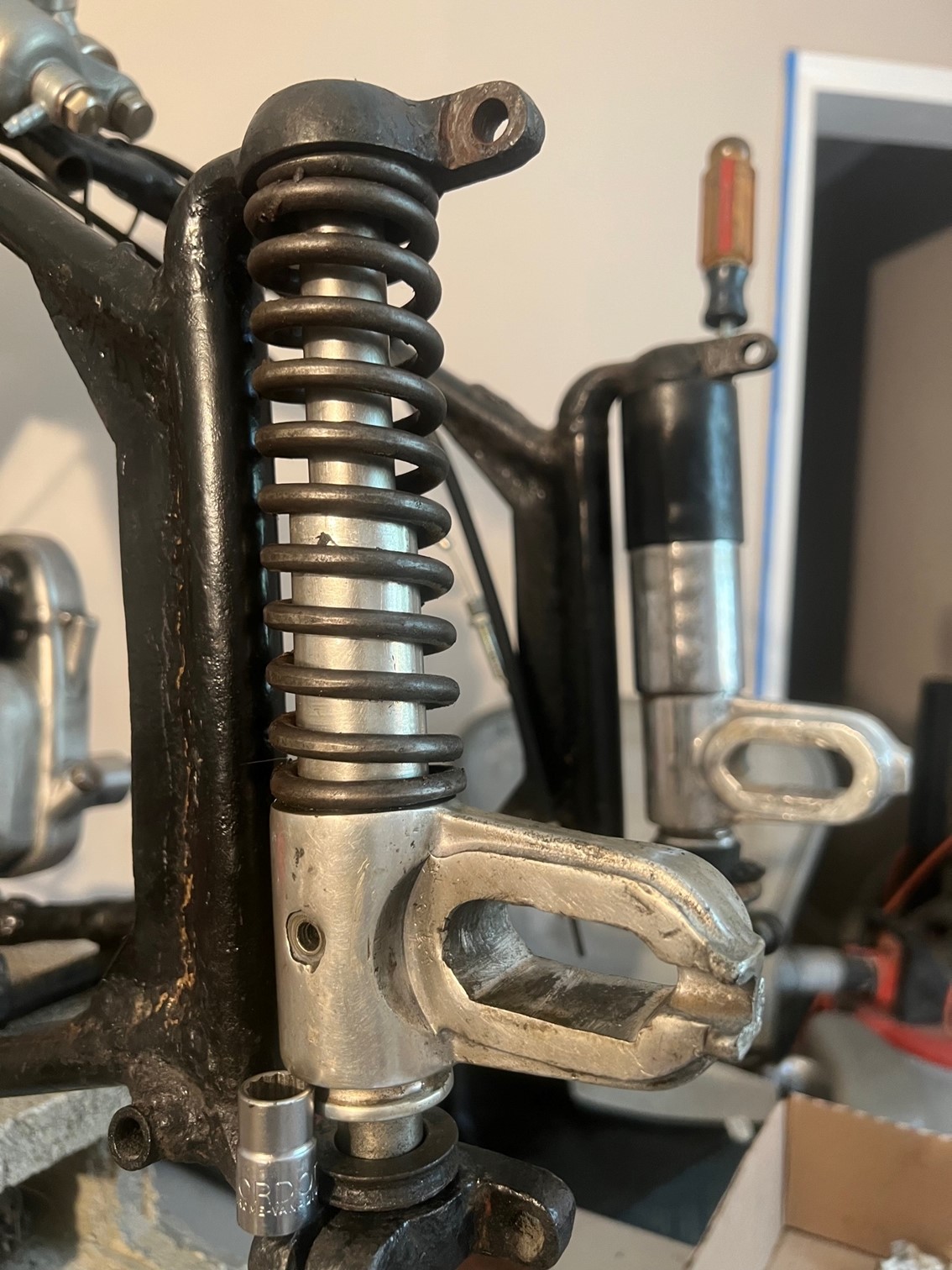

I had not noticed this until now, but my rear plunger arrangement appears to be unlike anything else I’ve seen on a Norton.  Instead of having both upper and lower springs, my machine is fitted only with upper springs.  This is to say that I have an accommodation for compression, but none for rebound.  Moreover, when the upper spring is fitted, there is very little space available for a lower spring.  I purchased new upper and lower spring covers (sliders), and to be able to fit them into the available space, both springs, if fitted, would have to be fully compressed.  Such an arrangement would render the plunger suspension useless.

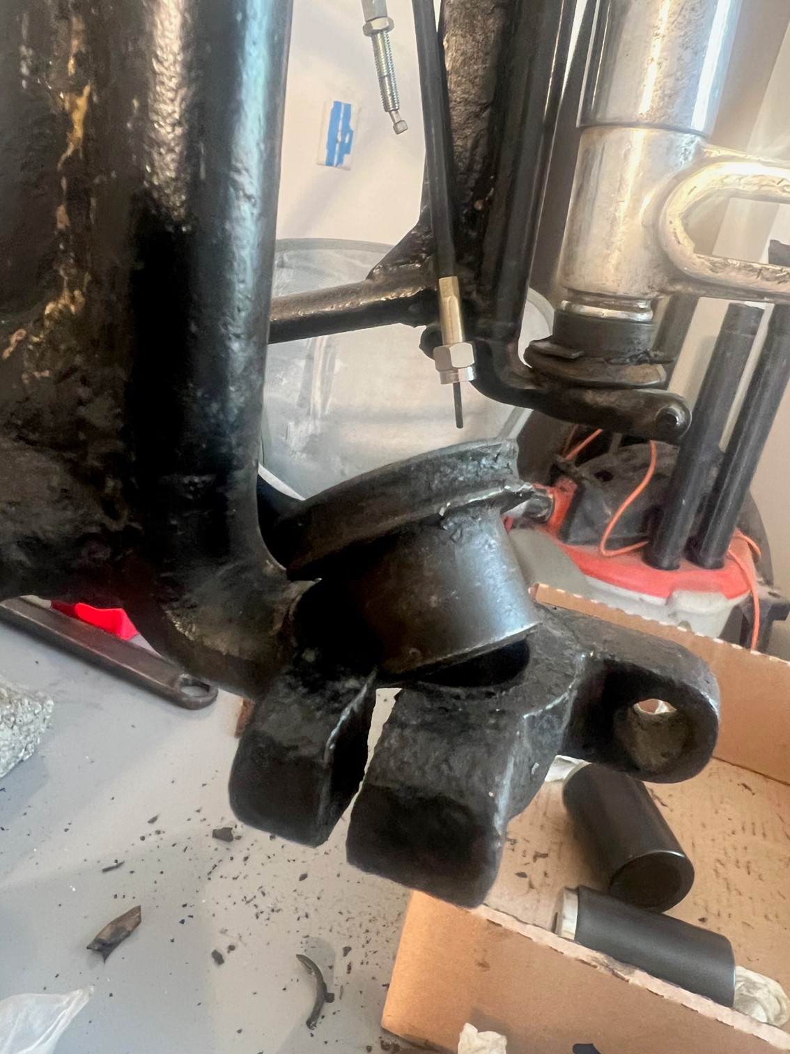

The further I investigated the matter, more and more differences became apparent.  Instead of having a lower slider fitted, mine had a rubber boot that was dried out and nearly perished.  Furthermore, the plugs I had bought to fit into the top of the slider tube were much smaller than the ID of the tube.  I also noted that the tube did not have a spiral relief machines into it, but instead was smooth with a series of holes drill right through at the extreme ends.

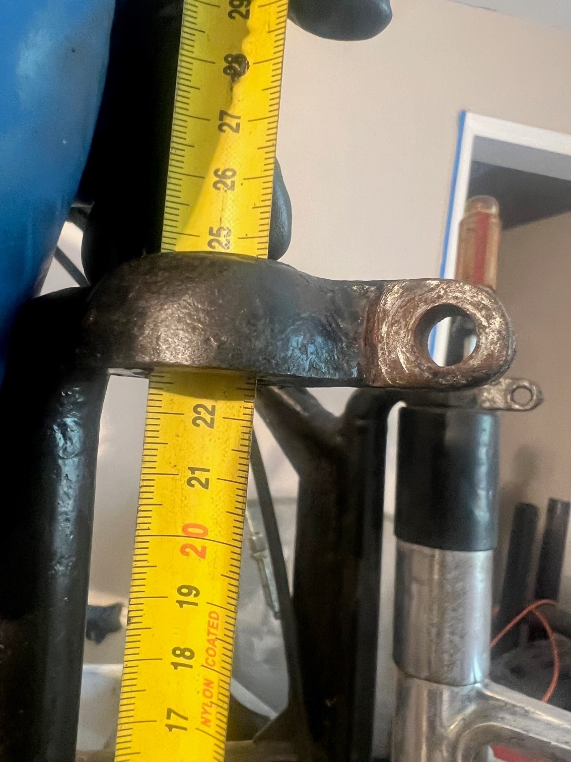

The distance from the top face of the lower perch to the bottom face of the top perch is 226 mm.  The OD of the slider tube is approximately 0.788” while the ID is approximately 0.547”.  For reference, the OD of the plug intended to fit into the top of the tube is 0.375” (3/8”).  The spring as fitted measured 145mm in length x 44mm in diameter (5 11/16” x 1 11/16”).  Please refer to the attached pictures.
So, what do I have on my hands?  Has someone possibly attempted to fit a plunger rear from another manufacturer?  If so, any ideas what these bits might be from?
Thanks in advance!
-Robert
At some time in the distant past, there were private busnesses that would convert a rigid rear end to a plunger, they were not doing a conversion using an availiable kit but were doing their own thing. Some good, some not so . Perhaps thats what you have.
Did the Club confirm that it was supplied as a "Spring Frame" and authenticate the frame number stampings ?
The Norton plunger assembly featured a large casting including lugs which brazed to the frame. Yours looks like a local plunger conversion to a rigid frame.
If the frame number is not conclusive, there should be a "shop" number on the top frame lug.
... with both above comments - that setup doesn't look like the plungers on my 1952 ES2.
hello,
thought i would have a look on the net for plunger suspension, as you do . the only thing i could see thats similar is this a (1951 sarolea vedette plunger rear suspension ) . it looks similar, a long top spring to carry the weight then possibly a smaller length spring at the base or just a rubber stop.  not saying thats what you have. just having a looking at the different types of plungers.
