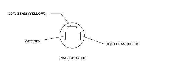

I have just purchased a complete new headlamp for my 1964 650SS. The main bulb is a haloigen bulb and has three connectors. The old headlamp that I removed only had two connectors. I am after advice on how to wire up this lamp. Is one connector an earth and if so which one?
Previously wrote:
See the pic. Should be all you need.
Thank you Dominic, thats most helpful
