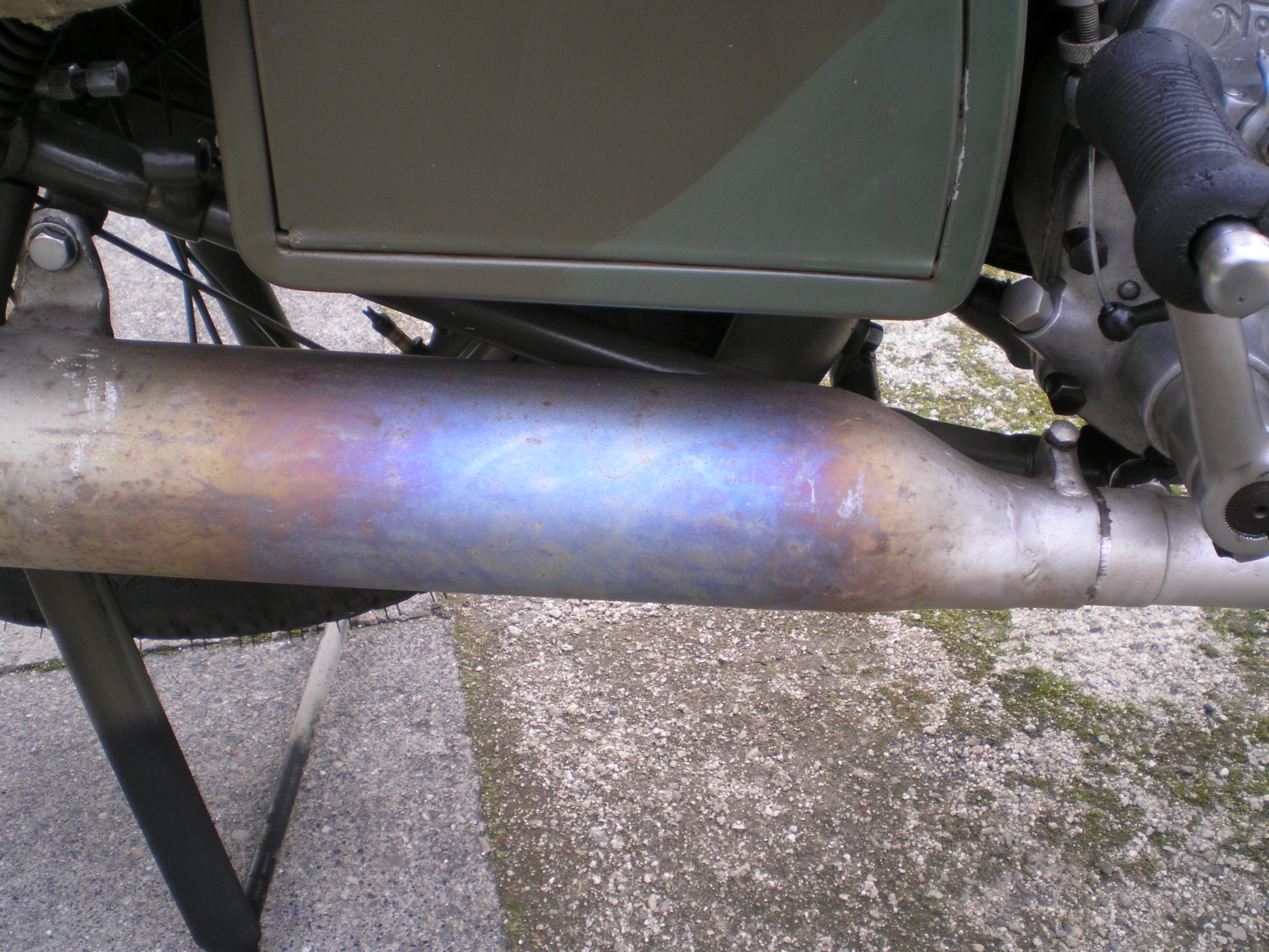

Red hot!!!
Just the once when the ignition timing slipped. Blued exhausts are different - often an indication that the bike is being used to its full potential.
