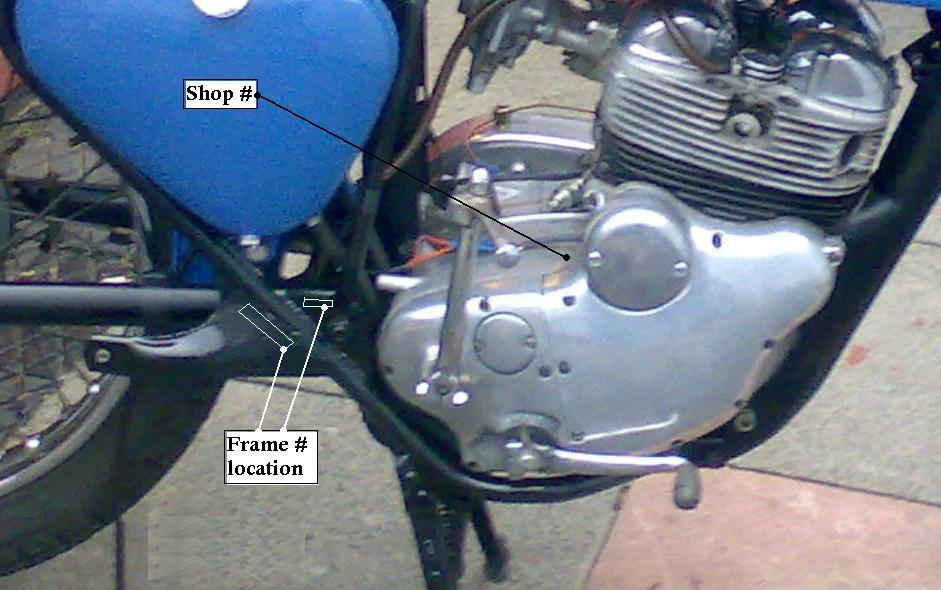

The L/W frame number is on…

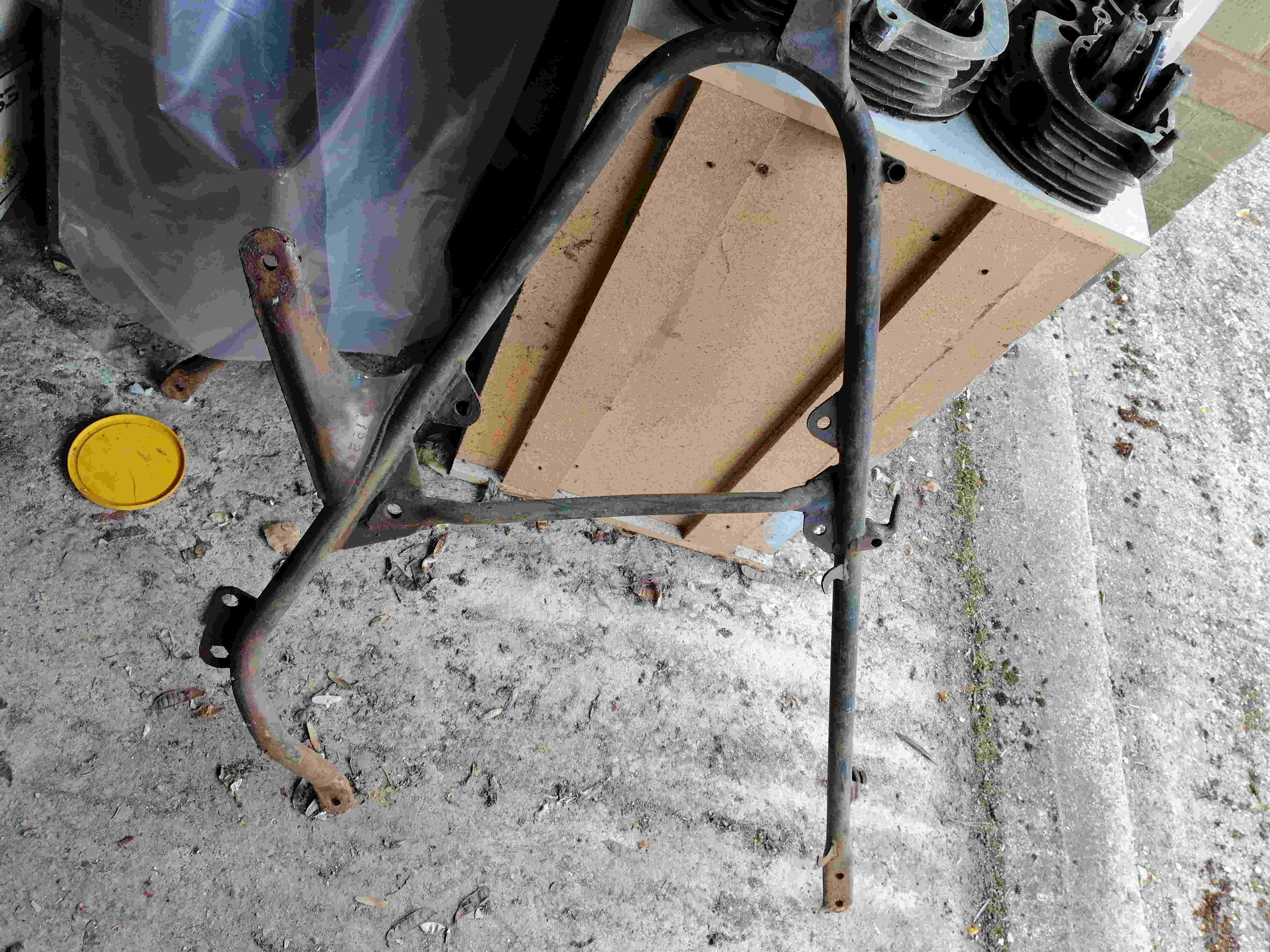

Deluxe lightweight frame has a bolted on straight support, unlike the welded on straight support as in Michael's photo above. On deluxe models the frame number is on the RH frame member. On the lower gusset mount for the bolted-on frame brace. Sort of near the hole you can see in Michael's photo.

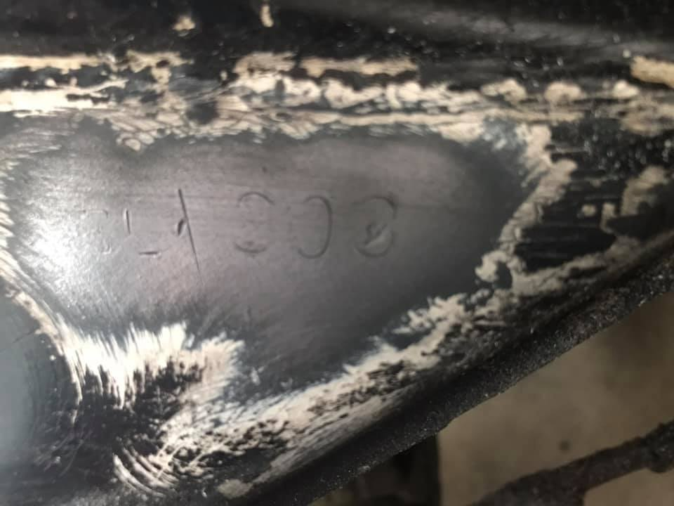

Thankyou Gentlemen. There it…
Thankyou Gentlemen. There it is and it matches the log book. Perhaps if id ever washed the bike I may have come across it earlier. Tim.

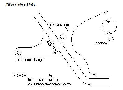

If I can, I'll upload some frame number examples
The L/W frame number is on the gusset that the pillion footrest mounts, on the R/H frame assembly.
