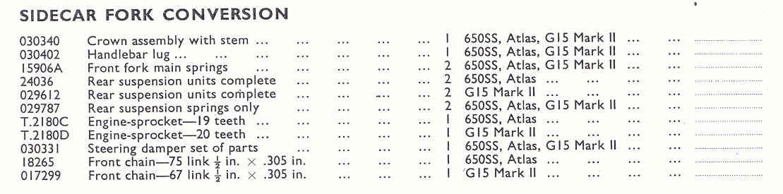

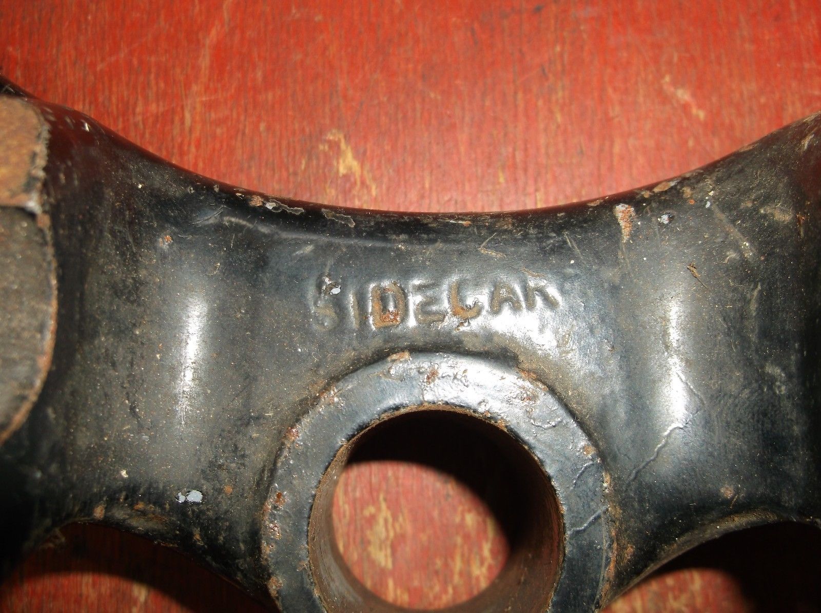

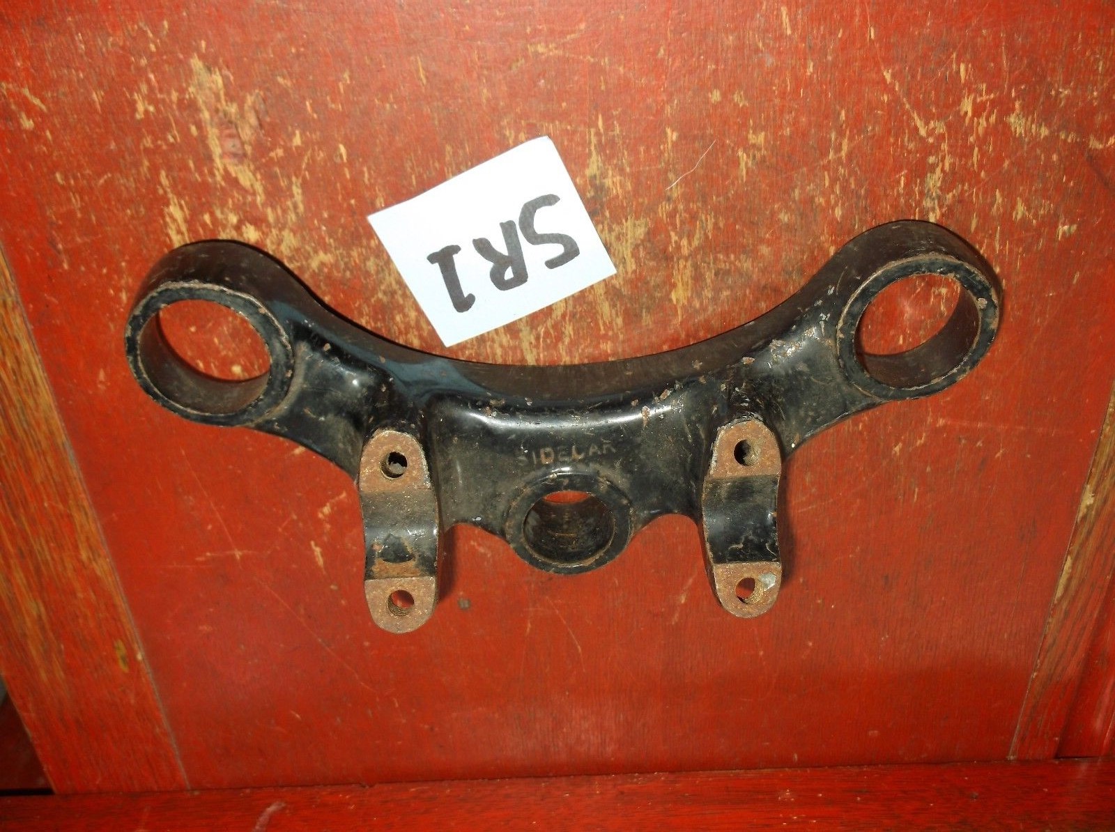

I have read that it was recommended to change the fork yokes for sidecar use, on a feathered frame.  How do you tell the difference?

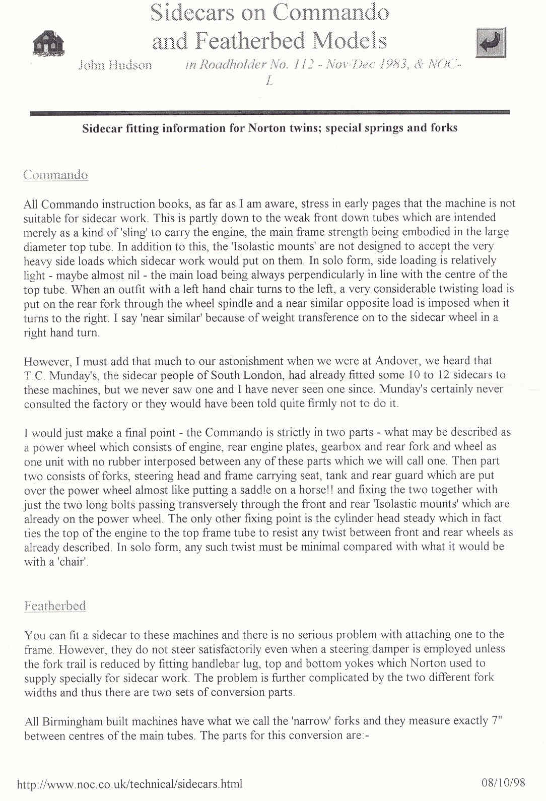

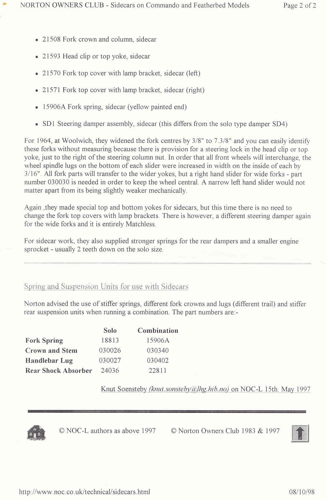

Hi John.....If you look through the Roadholder Records (using the links above) for RH 112 Nov/Dec 1983 pages 2 & 3 there is a very good article about all the fork chunks required for a sidecar conversion.
Also Kev Feltoe put together a most informative article about Norton sidecars in RH 290.
The attachments are a mix of useful pics and data for both early and later Nortons.
