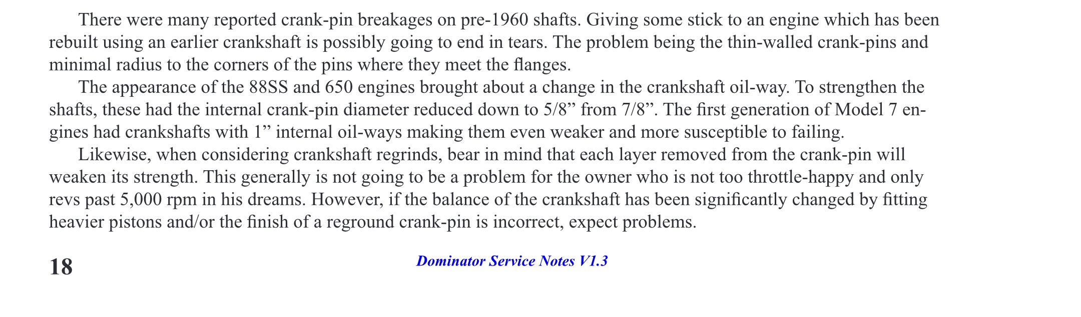

so the attached photo shows the text in the service notes which prompted this thread. My crank has the 1" crank pin bore so is therefore the weakest of the cranks. It also needs a re-grind which will weaken it further.
It's not really clear from the notes which cranks have the smaller (7/8" or 5/8") but it does say that it was the early model 7 cranks that were like mine. So my thinking is that an alternator crank should at least have the 7/8" bore which would be an improvement on the one I have.
im assuming it's the 88ss crank that would have the 5/8" bore but that's not based on anything other than comments in this thread, which are appreciated.

so can anyone confirm if changing to an alternator crank would reduce the crank pin bore from 1" to 7/8"?

Pete - So if your Model 88 does have a Model 7 crankshaft then you are quite correct in wanting to replace it with a later Dommie one.  A dynamo crankshaft up to 1956 will be fine for most peoples' needs.  A later alternator crank will fit your cases without any problems but I would stress that you should fit the later 88 con-rods as well.  If you wish to utilise your Model 7 rods I should get them crack-tested and polished to relieve any weakness areas first.  If you're building an 88 Track bike or Roadburner then look for an 88SS crank (5/8 inch journal inside diameter).  You don't mention it but if your donk also has the Model 7 cylinder head, camshaft and low compression pistons then you will be better buying an 88 engine complete and parting company with the Model 7.  Good luck, Howard

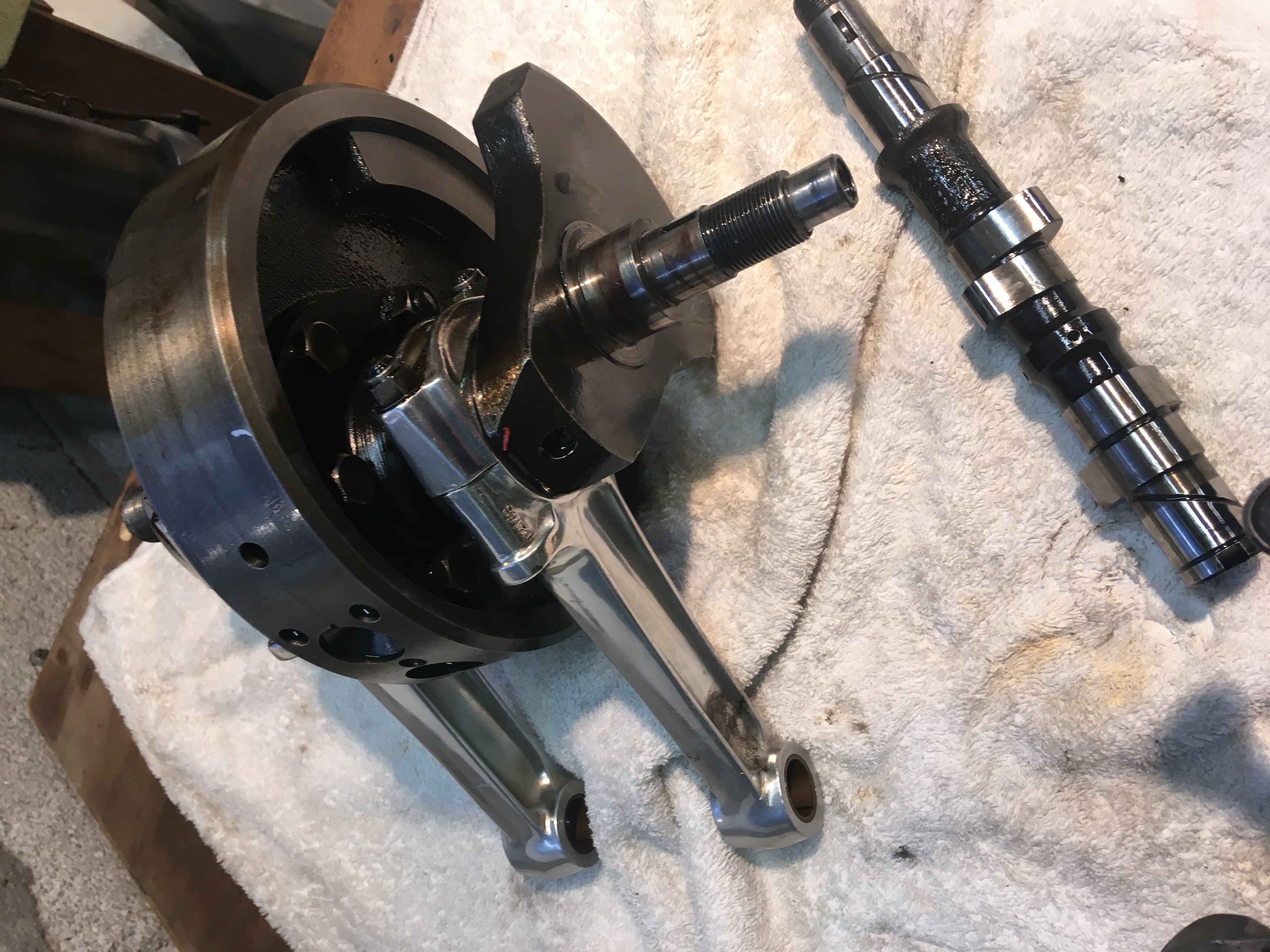

The engine is a real mix. From what I can work out the cases and barrels are from a 1954 model. From measuring the bore of the crank pins (1") I believe it's a model 7 crank. The cylinder head is the downdraught SS type (see pic). It has lightened rockers. The conrods are an unknown but have been polished at some point and seem to be in good order. I'm assuming they're 88 rods. I've clocked the cam in the lathe and from referring to the cam survey it appears to be the standard 88 cam with 0.300" exhaust lift.
The pistons are standard compression. I should have cc'd the head before taking it apart to confirm. It has a single 28mm carb on a manifold which I think explains why it was a bit sluggish at low revs and had a bit of an erratic tick over. I'm thinking of splashing out on an SS cam to make the most of the head and large inlet.
ill put some feelers out for an SS crank but want to keep the ball rolling so will probably need to settle for a later 88 crank. Asking vendors to shove biro guts into the journal oil hole and seeing how far it goes in should hopefully make sure I don't end up with another model 7 crank!

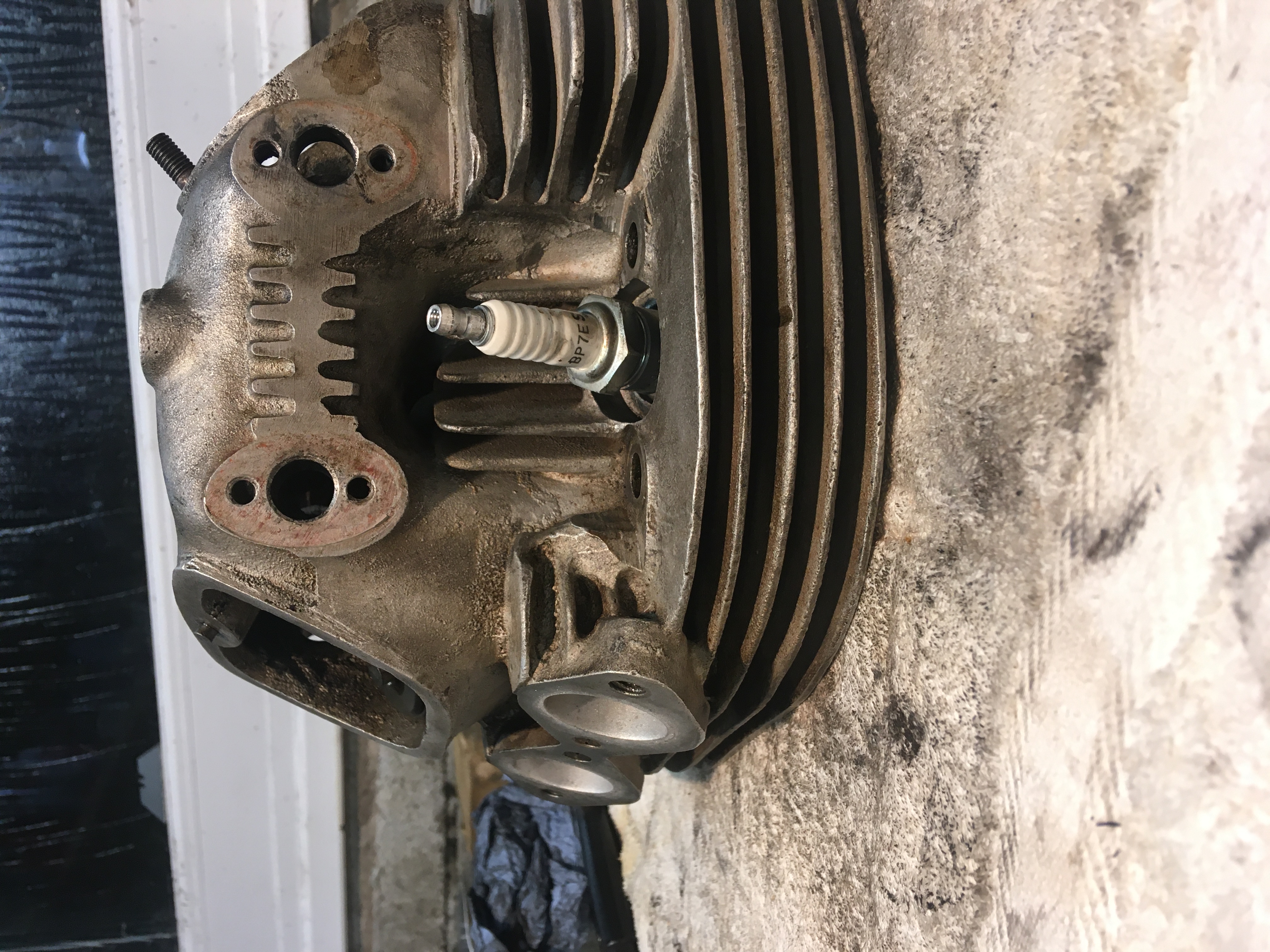

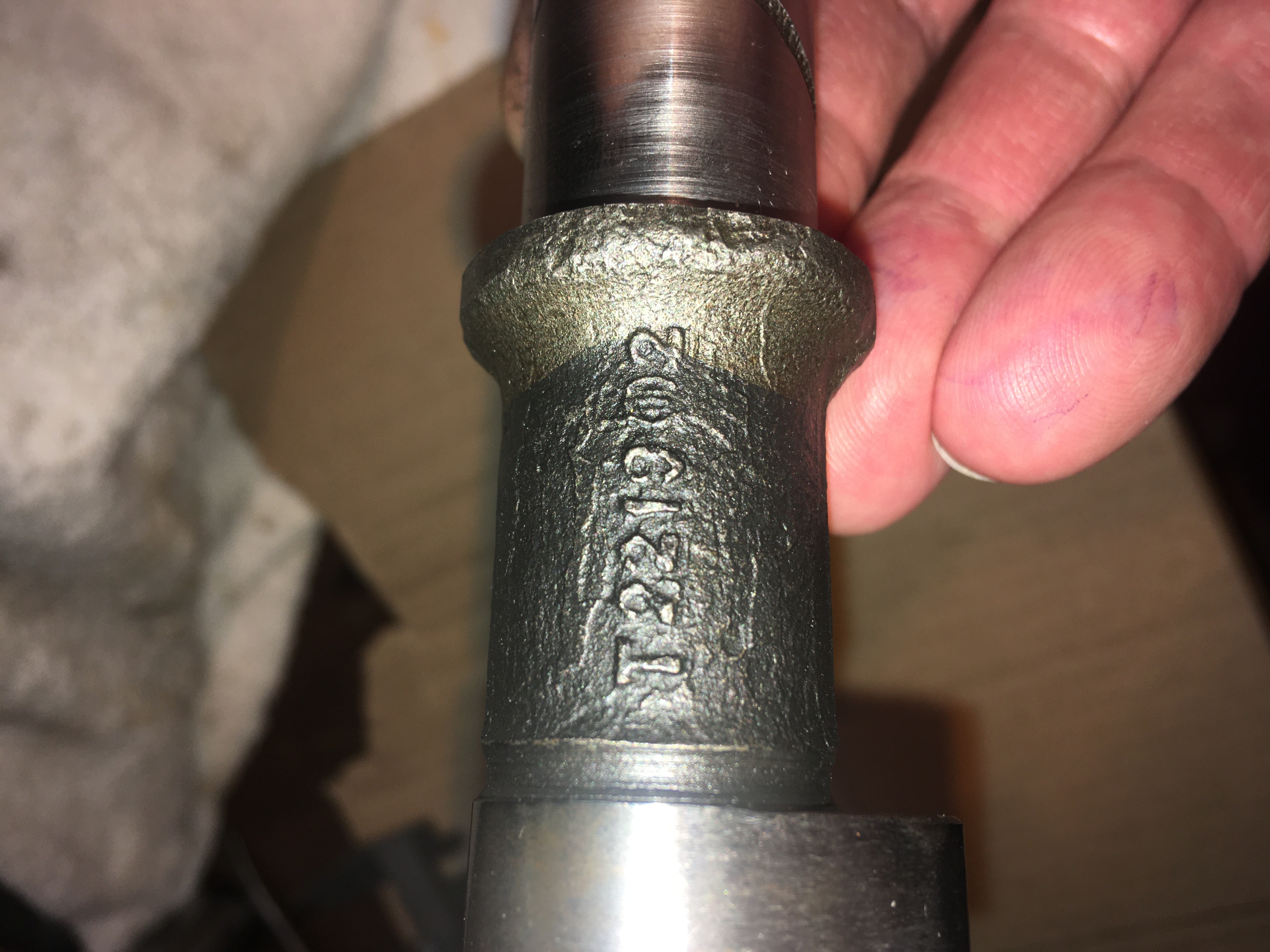

Pete.....check the numbers on your camshaft.  It looks to me that it is displaying T2219@3 on the side in which case it is probably a Q.R. or SS camshaft. Look for extra letters such as Q.R. or X1 or X2 stamped on it.
The cylinder head probably has 22707 next to the inlet rocker cover which would make it an early spigoted 650 or possibly 88SS version. If the head has 23166 on the underside this also is an SS head.
If your barrels have lost their spigots then any of the SS heads will fit, including any 650 version with 25139 stamped on the underside. Note the 750 head has the same numbers but will not fit.

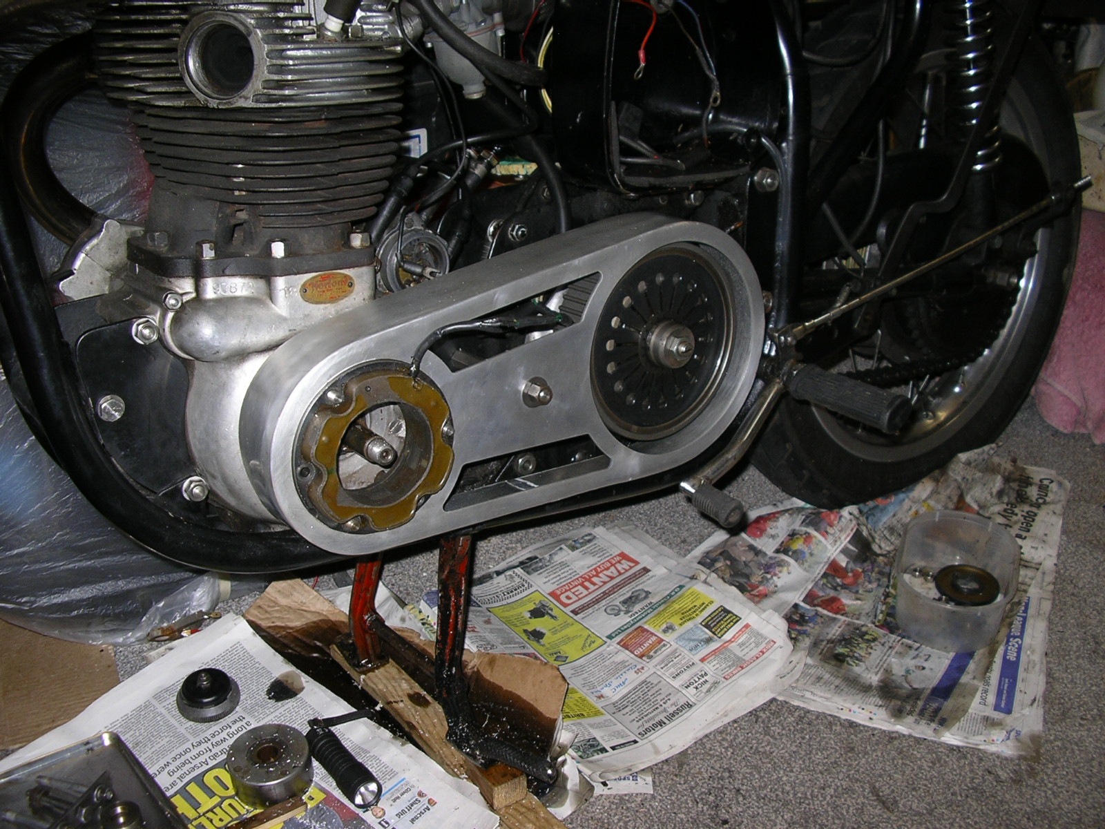

If you opt for a belt drive primary conversion, then you might escape having to mess around with the alternator crankshaft end.  RGM sell a tidy looking alloy primary cover to go with their belt drive kits.
cover

There are no additional markings on the cam at all, only the forging number. I've measured the lift and it seems to be the standard 88 cam so perhaps that's original to the 1954 cases. It has an exhaust lift of 0.300". According to the survey a model 7 cam has an exhaust lift of 0.26" and the SS 0.33".
good info on the primary covers.
My barrels are spigotted but the mating surface is dished between the bores and the pushrod tunnels which makes me think it needs skimming and perhaps the consequential loss of the spigots. The head has the recesses for the spigots. I'll check the numbers later.
Those ports look big for a road bike 500, port sleeves are available which should (if they fit) help keep you a decent mid range .

The Daytona camshaft (T2219 @ 2) appeared in 1956 on Norton Heavy Twin road bikes.
The Q.R. (T2219 @ 2) in late 1958 and the SS (T2219 @ 3) in 1960.
Hello again Pete - Further to what Phil has written please note that the Daytona and the QR cams have the same profiles. The QR stands for Quietening Ramps.  Flat followers are fine for those three types of cams. The SS cam gives more power - if it's needed ?  Don't use a Model 7 or early 88 cam.  The 88SS used 9.45:1 compression ratio pistons.  Use a pair of 1 1/16 inch AMAL Monoblocs or 28mm AMAL Concentrics on your downdraught head or a single carb manifold with an 1 1/8 inch Monobloc.  Cheers, howard

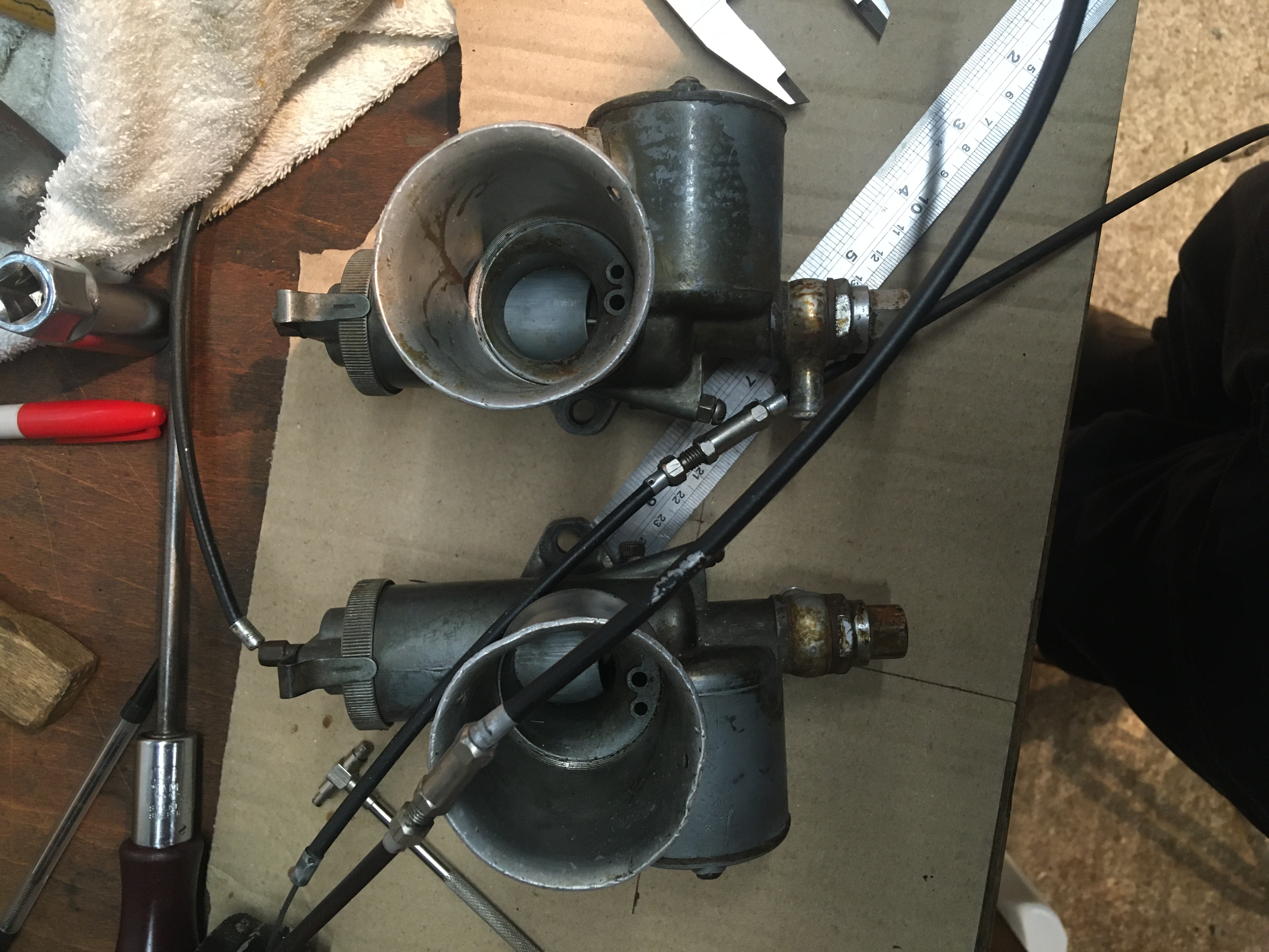

Thanks Howard, the bike came with a pair of LH and RH monoblocs which measure as 1 1/8" in a box along with some rearsets, a cafe racer tank and cafe racer seat. The carbs would need a fair bit of work and I'm assuming they're too big for this really?
Yes . Sorry , the Daytona cam with the quieting ramps . Standard cam for many years fitted to 88/99 ,  from late 1950,s up to early 1960,s , very similar profile to the SS cam of the 650 and Atlas but with slightly less duration and lift cheap to find s/h and does not need the stronger valve springs or barrel pushrods that the SS had. Less valve clearances too so a bit less clatter. Good enough to power a 99 to the Ton ., and the  std 88 to 90 mph

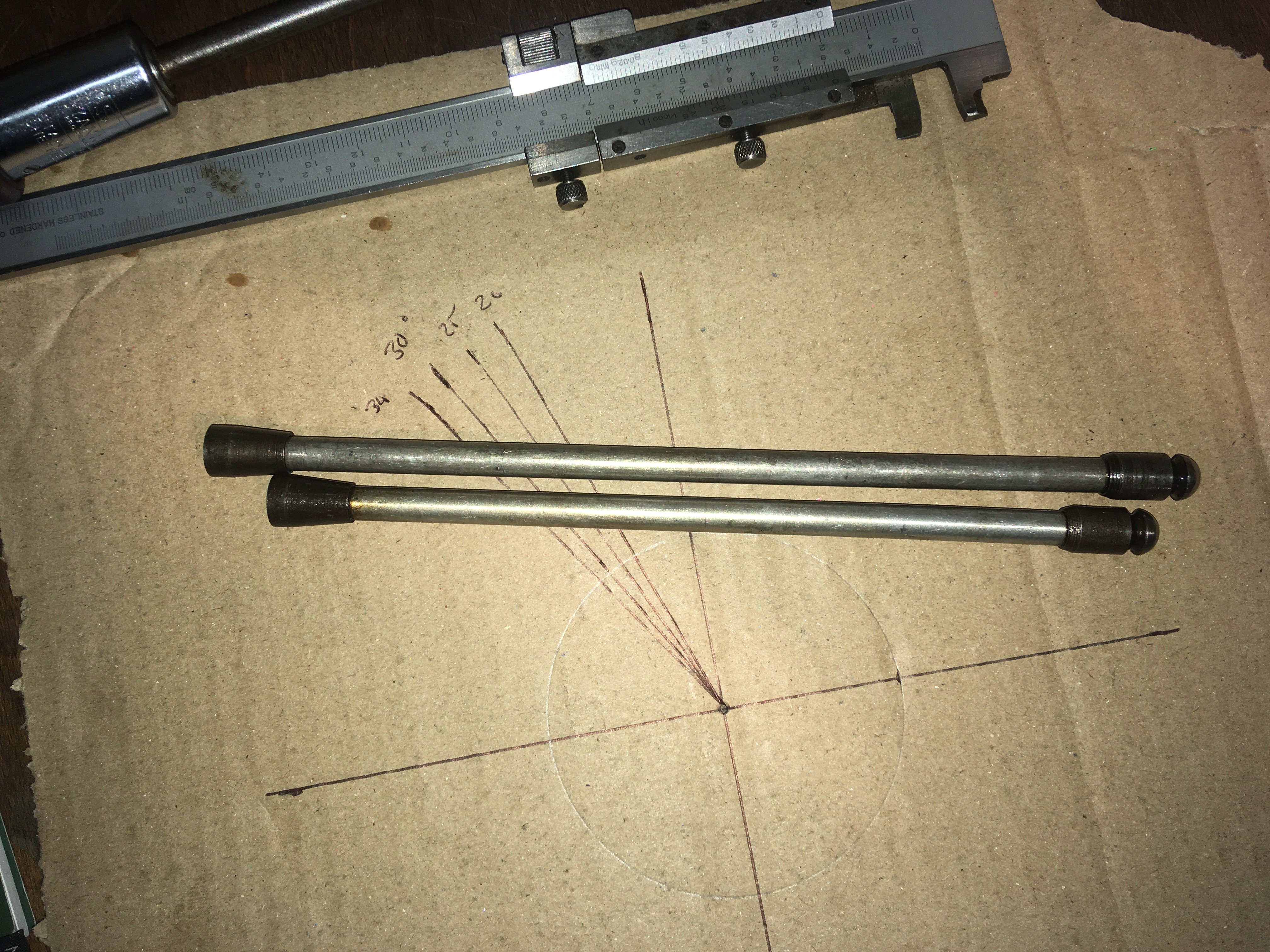

Look like std rods suitable for a Daytona cam , I would also use with an SS cam , but I am unlikely to be exceeding 6000 revs !
