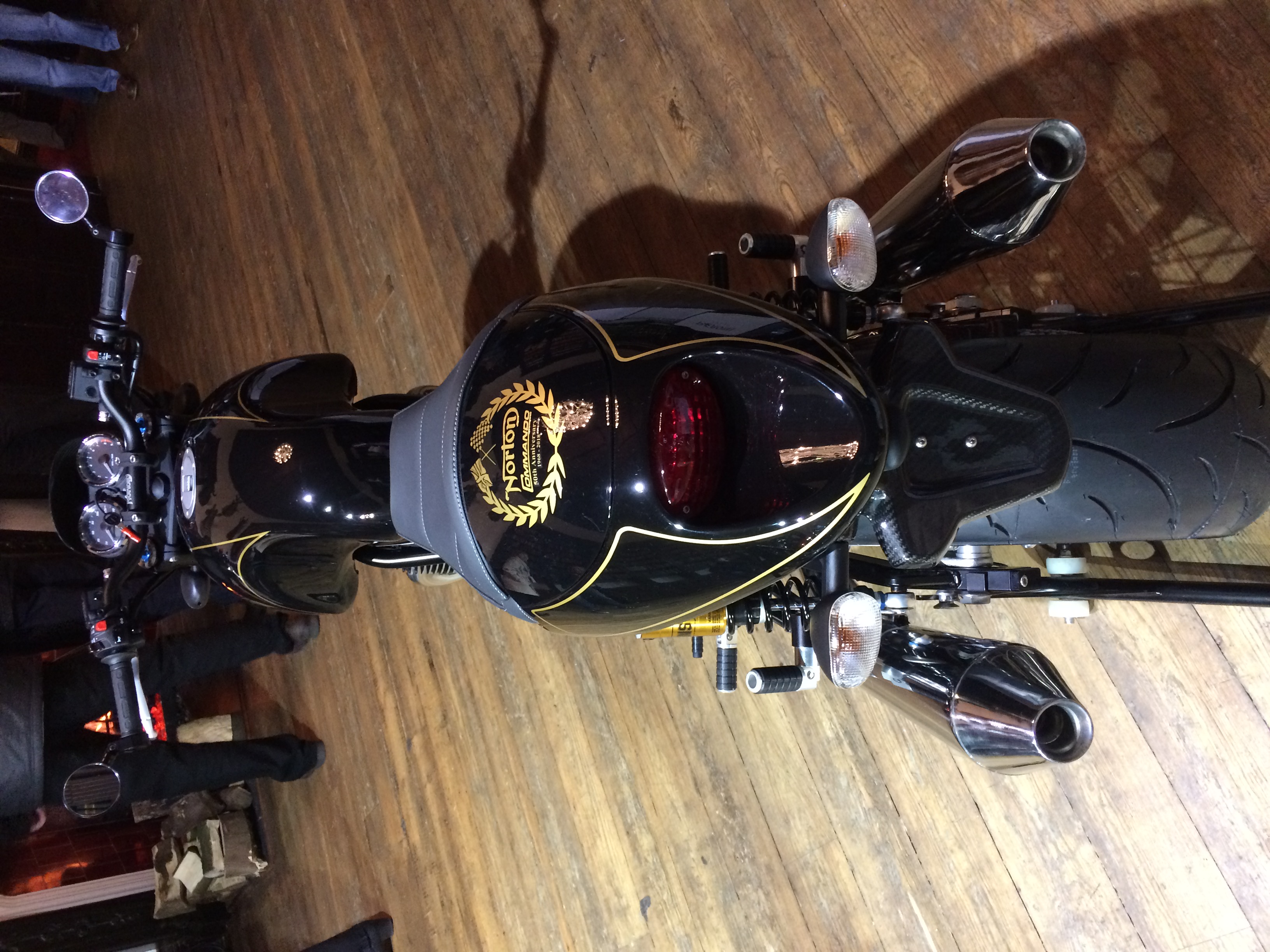

Norton's facebook page says "details include carbon hugger, bar end mirrors, road holder forks (whatever they are?), carbon flyscreen (which in my opinion suits the CR but not the sport), black engine pack, brushed finish oil cooler to name a few" but disappointingly doesn't go into any more detail. Still nowhere near £21K as far as I can see.
I notice also that the "50th anniversary" letters on the tail appear to be a stuck-on label rather than a transfer so I'm not sure how many weekly washes that will endure!

The 50th anniversary emblem is not a stuck on sticker ; so no fears of washing away, the Road holder forks are the black ones from the dominator, all those anniversary models are well presented & finished,the short stubby pipes are louder than standard of course,but nothing like Harleyâs or race pipes on the jap bikes ,donât know of anyone being told off with the short pipes, & tbh it just looks like & sounds like how a bike should be
