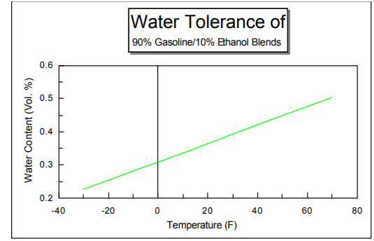

I think one of the main problems with ethanol in petrol is that ethanol is hygroscopic (it attracts water vapour and pulls it out of the air), this water then settles out of the petrol/ethanol mix and always settles to the lowest point - which is the bottom of the tank, rapidly followed by going straight into the carburettor.
So it is the water that is doing the damage and corrosion to metal parts and jets and not the ethanol per se.
