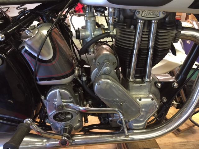

I took George Cohen's (may he rest in peace) advice and have installed an AMC clutch on my bike. Despite the descriptions I believe I am missing something about the details of the clutch installation and operation. Hence, I am reaching out to the Global Norton Community for help. I have struggled the entire summer and it is obvious i am missing something.
BIKE
My bike is a Model 18 Rigid Frame with a 1951 ES2 engine. The gearbox is a Norton Vertical gearbox. The AMC clutch has new plates, new springs and the aluminum alloy spring plate.
PROBLEM / ISSUE
I believe I am adjusting the worm / arm arrangement in the gearbox. The arm is at 45 degrees below horizontal and the worm as approximately1/8" free play before engaging the push rod. The rear wheel spins freely when the gearbox is in neutral. When in neutral the crank spins when I kick the motor. The clutch plates are lubricated with ATF. The spring plate travel is parallel with the plates upon pulling of the clutch lever. The spring nuts are screwed in flush with the post threads on each spring. THE PROBLEM / ISSUE IS WHEN I PUT THE GEARBOX IN 4TH GEAR AND PUSH THE BIKE DOWN THE STREET, THE CLUTCH CONTINUES TO SLIP AND NO TORQUE IS TRANSFERRED TO THE CRANK.
Attachments IMG_2453.jpg IMG_2454.jpg technical1-

Hello Josh, if the clutch…
Hello Josh, if the clutch is slipping in 4th gear, so much that you can push the machine,it is also going to slip in 3rd, 2nd and 1st,...... plus,.... when you actuate the kick starter. Looking at your pictures, I see that the worm actuating arm to clutch cable run is more like 90deg. (don't worry about the horizon), its to the cable you want to get the angle correctto maximize the cable pull to clutch rod movement. From MINIMUM loose cable to maximum pull, half way through the worm armarc should be90deg. to cable run. (the cable isn't vertical to the horizon).The 1/8"free play between worm and rod puzzles me. This isn't the correct clearance, by far. Though, with this adjustment, this will have nothing to do with clutch slip.................... I think you have a possible gear selector problem.
