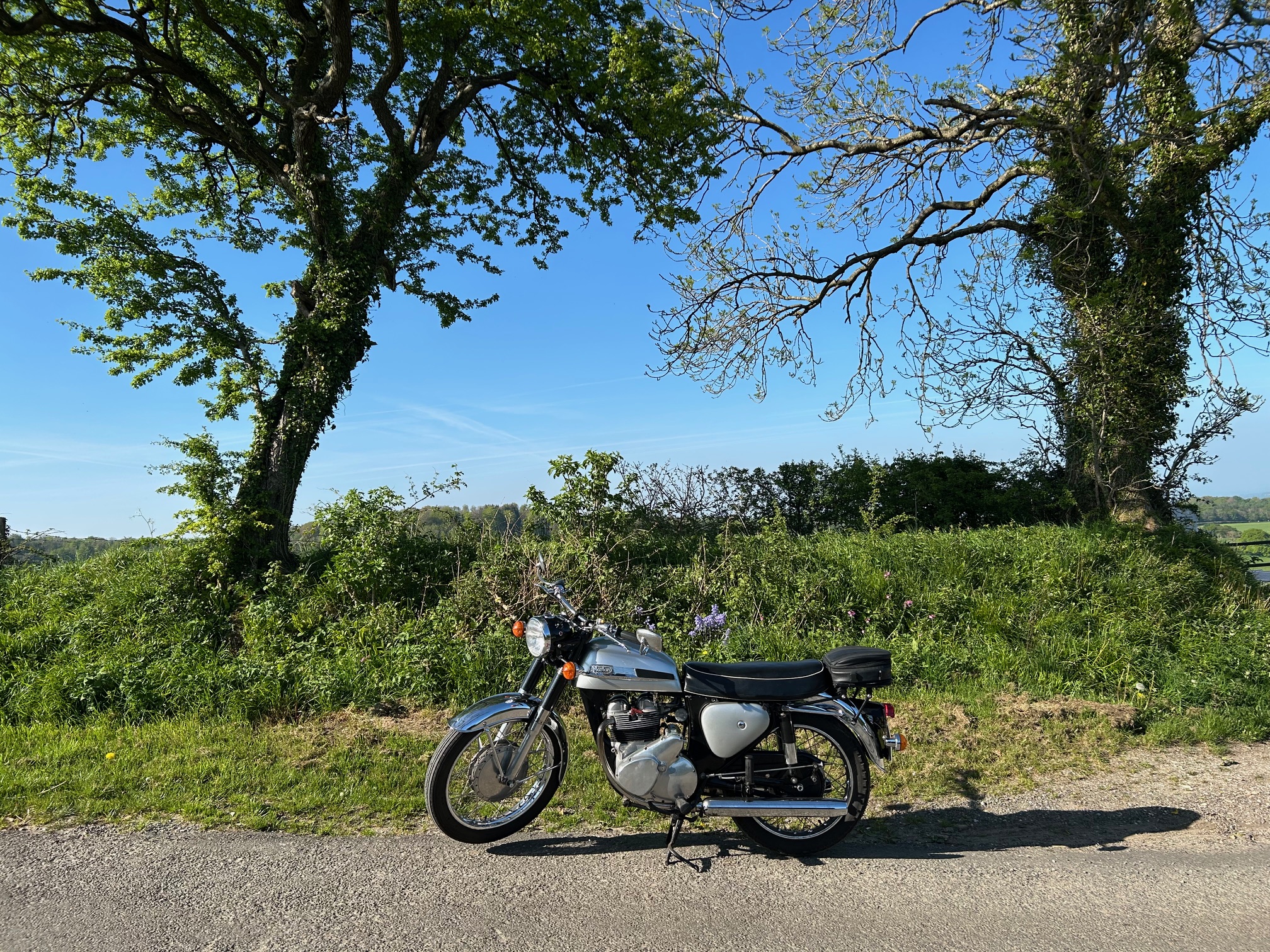

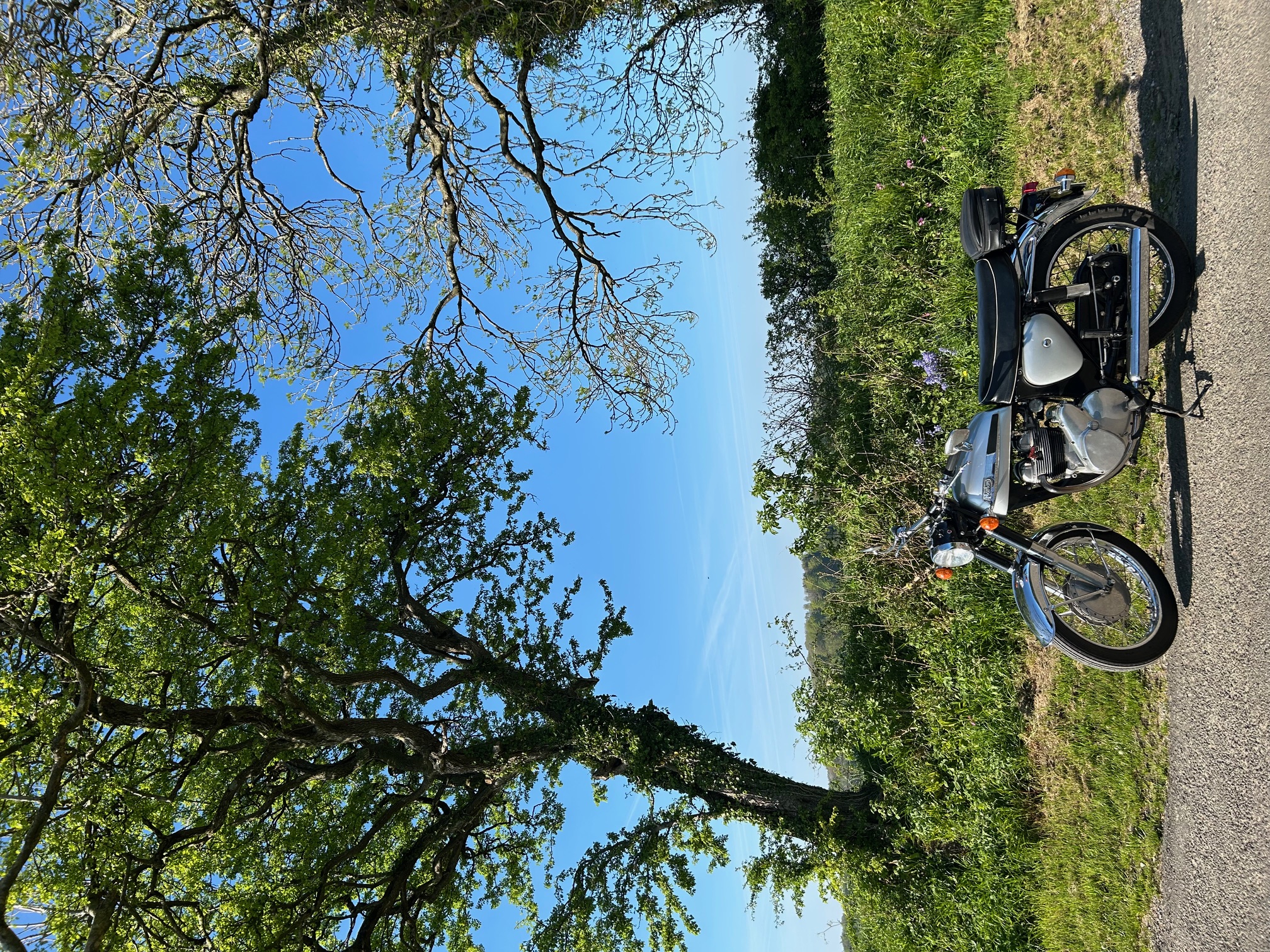

I thought I would attach a couple of pictures of my Electra resting amongst the bright green leaves of the Somerset trees, vibrant blue of the Bluebells and rich red of Campion during my long test ride after it's gearbox, clutch and starter rebuild and accurate ignition timing. Starting, running and changing gear really well, 99% of oil leaks cured, performance, tickover, power and smoothness much improved thanks to Pazon electronic ignition timing now spot on to correct 30 deg BTDC using a strobe.
My only minor niggle is a tiny weep from the Primary side filler plug. I just cant get a perfect seal with the rubber 'O' ring from NOC spares which has replaced the red fibre ring used originally. It distorts when the plug is tightened down and despite experimenting with different tightness I cant get a 100% seal I used to get with the original washer. I have searched high and low on the internet and can't find the correct size of red fibre sealing washer. Does anyone know of a source or solution?
Enjoy this beautiful weather and safe riding - I will be out again tomorrow making the best of what is an outstanding and much under rated Norton and a joy to own.....most of the time!
Cheers. Nick

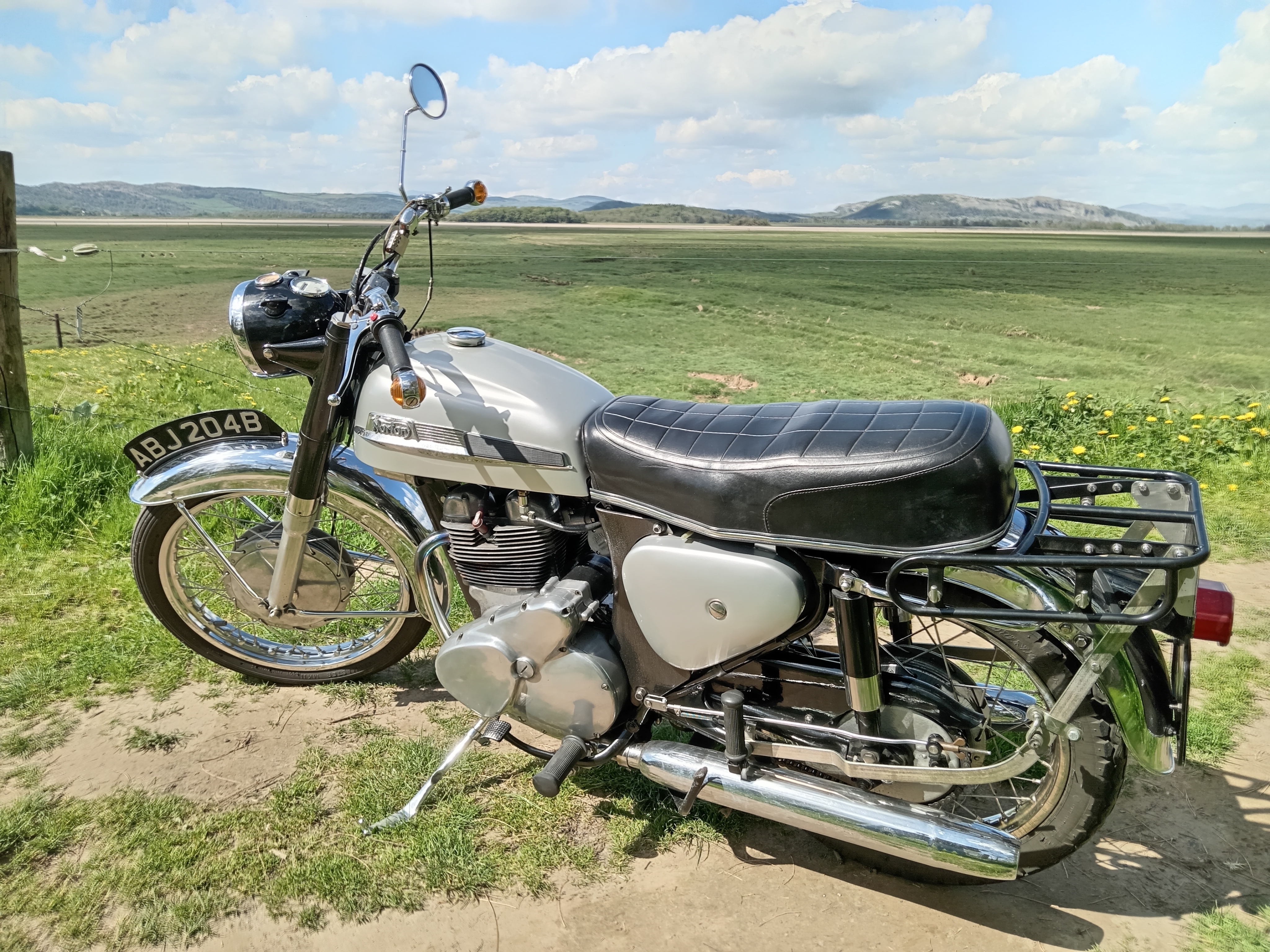

Glad you found the club centre stand with lever is satisfactory.
Your stand looks to have been fitted to a frame with good stops and the spacers you mention. Like mine, the front wheel is in the air. Correct length shock absorbers too.
I hope this gives a few clues to those who find the stand does not lift the bike enough, is difficult to put on the stand, or find the lever arm end sits on the tarmac with the feet.

The stand, does it allow the bike to sit on either front or back wheel like BMW's did/do?

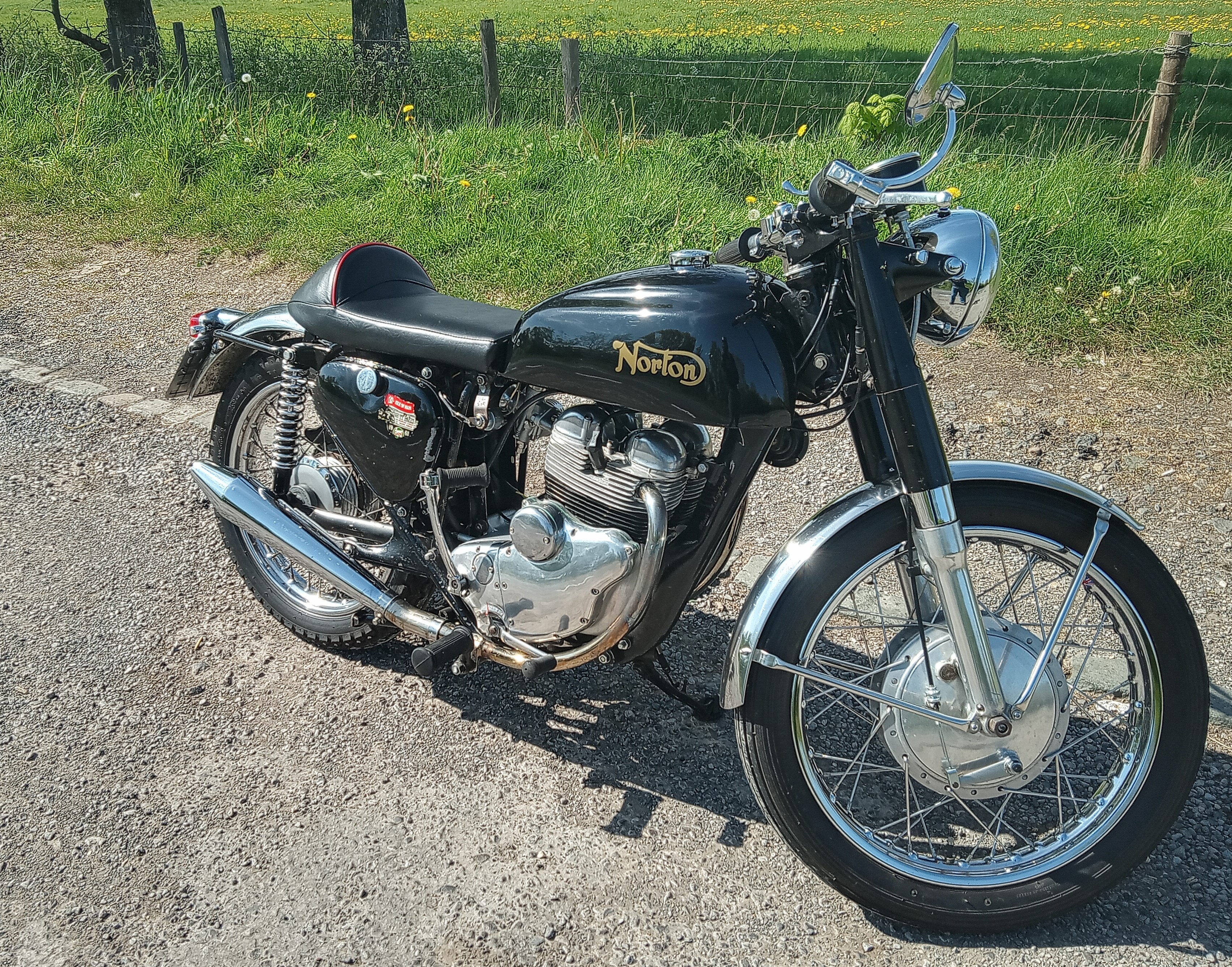

Fantastic photos of Lightweights bathing in the Spring sunshine. Here's my offering, taken on Monday on the B4225 between Bibury and Burford.
Front wheel on the ground
Just been out to the garage. I incorrectly stated above that the Electra rests on centrestand with front wheel in the air.
My front wheel is firmly on the ground. The rear wheel is in the air and it takes a fair push down on the luggage rack to raise the front wheel.
I've just checked, mine is…
I've just checked, mine is the same Peter. As I suspected the reason my front wheel was off the deck yesterday was the slope and weight of tools in my little tool bag behind the seat. Off for another run to make the most of this cracking weather! The more I ride the Electra the more I am impressed. I live my Navigator but the extra cc's and torque, indicators, starter and better rear brake tip the balance! N
