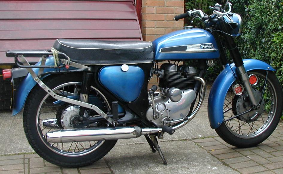

Moving swiftly on.... the silencers fitted to my Electra are circular in cross section and are approximately 3" diameter. The kickstart fouls the RHS silencer even though the pipe is as far inboard as possible. I may have the wrong silencer mounts as well but even if these were different there's no way the silencer would move inboard enough for clearance.

Yes they all do that, the silencers pick up 'kick start scars' the 'cigar' silencers are 3" but the 'kidney' oval ones are a fraction wider. Fiddling with brackets and pipes can make it work, but the parts soon migrate back and interfere with one another.

These "cheroot" silencers are made with the wrong dimensions and mounting points that should be further forward on the silencer . Allowing the silencer to be fitted further to the rear . It causes the same issue when fitted to the 60  Dominators . where you have to dent the silencer to pass the frame . Exhaust pipes are also a poor shape .
..of brackets and spacers I've achieved a position where the kickstart just clears the silencer. I've also moved the kickstart out so its outer edge is flush with the outer end of its spindle - probably 1/16" or so further out than it was before. It's a shame tere are some existing scrapes. I expect everything will migrate so they're all in contention again before long.

...same both sides. My 1964 Navigator also has them - and you can see the kickstart 'dink' in them. (In addition to the weld done while abroad).

In addition, on the other side, my brake pedal fouls the exhaust pipe, as its at its fattest there with the exhaust clamp.
... are obviously pattern items - not surprising. I can see the subtle difference mentioned by Andy in his pictures.
