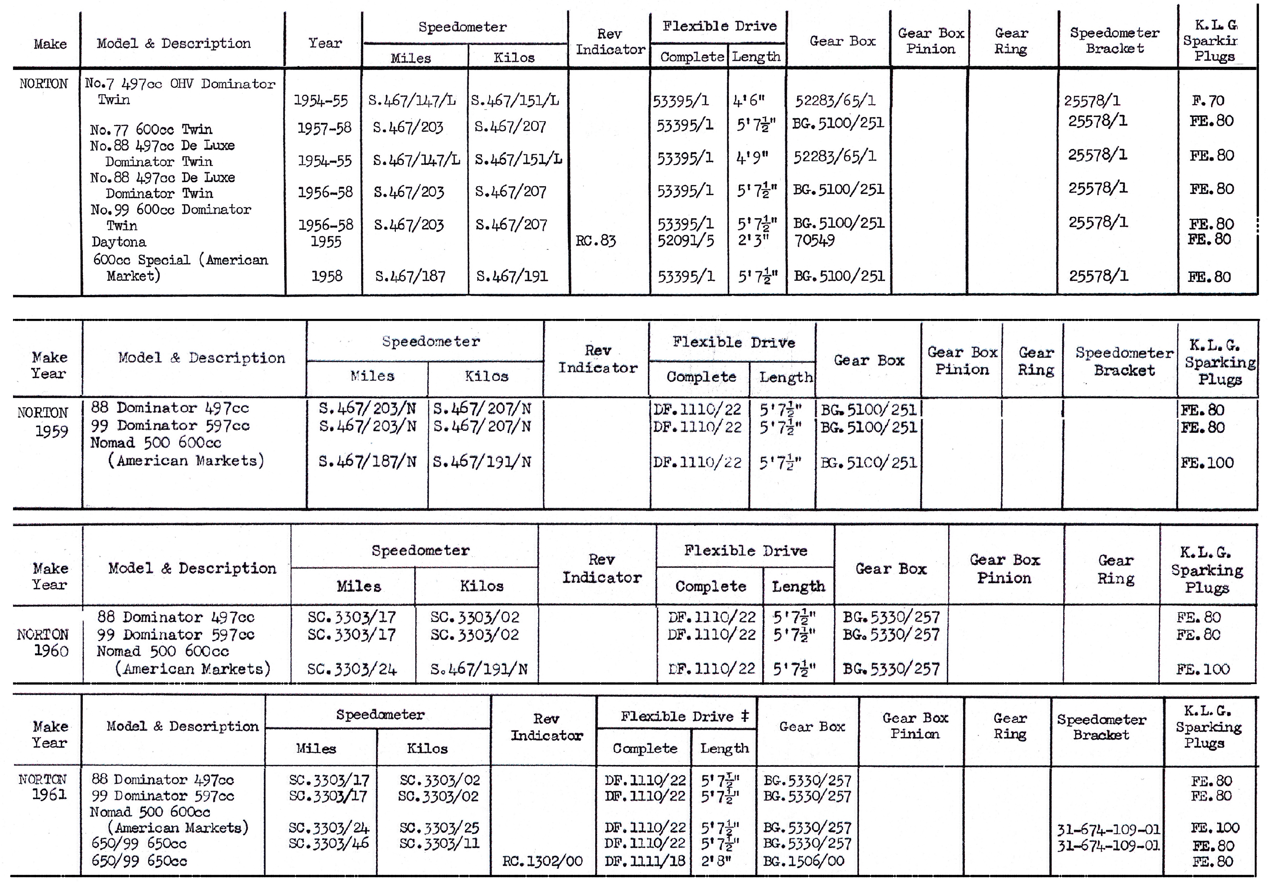

My 1957 "dynamo" Dommi 99 has a speedo drive box with no identifying numbers. It's knackered. The speedo face has on it the number 1550 near the centre, above the word  Chronometric, and near the bottom S 467/205/ N. The question is what is the correct drive gearbox for the speedo?
Hello Tom - Please have another look .....Could it be  S.467/203/N ?  If so it would pair with a BG.5100/251 gearbox.  This would be correct for you year. Cheers,  Howard
