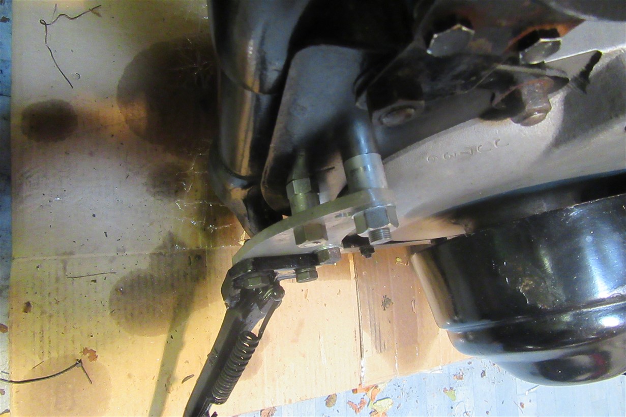

I've got one mounted on my…
I've got one mounted on my 650ss. I made an extra steel plate for the front left motor mount and even have a spare Kawasaki side stand It works great but does require swept back pipes to clear . If that will work for you happy to sell the plate and side stand for £40 plus shipping. Let me know and I'll send you photos tomorrow.
If anyone else could use one happy to make up another one for £40 and postage as I,ve got the plate pattern and another Kawasaki side stand. It does require swept back pipes to accomadate the side stand when it's retracted in the folded position.
If you look at my recent…
If you look at my recent post in "heavy twins", titled " modification to my 650SS you can see it in the up position in one of the photos.

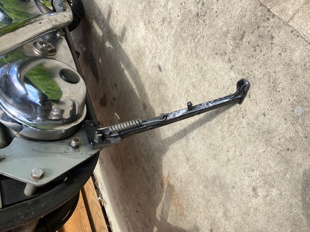

Better pictures of the stand…
Better pictures of the stand on my 650SS in use!

The pictures look good, You…
The pictures look good, You have made a superb job of them. Can I modify it to avoid the normal down pipes ?
Alex
Alex, the sidestand I have…
Alex, the sidestand I have on my bike does require the swept back pipes to function smoothly and remain tucked up properly giving good ground clearance. I maybe wrong but suspect it would not work properly with original style pipes. Sorry chum

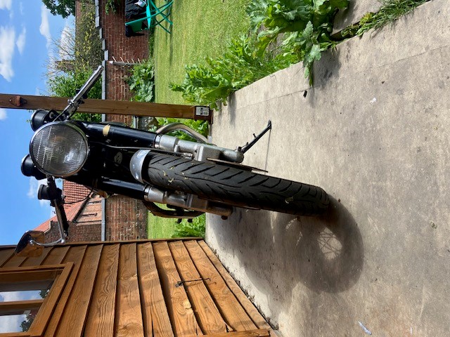

I have posted this picture…
I have posted this picture with the side stand in the retracted position to show how close it is to even the swept back pipe
