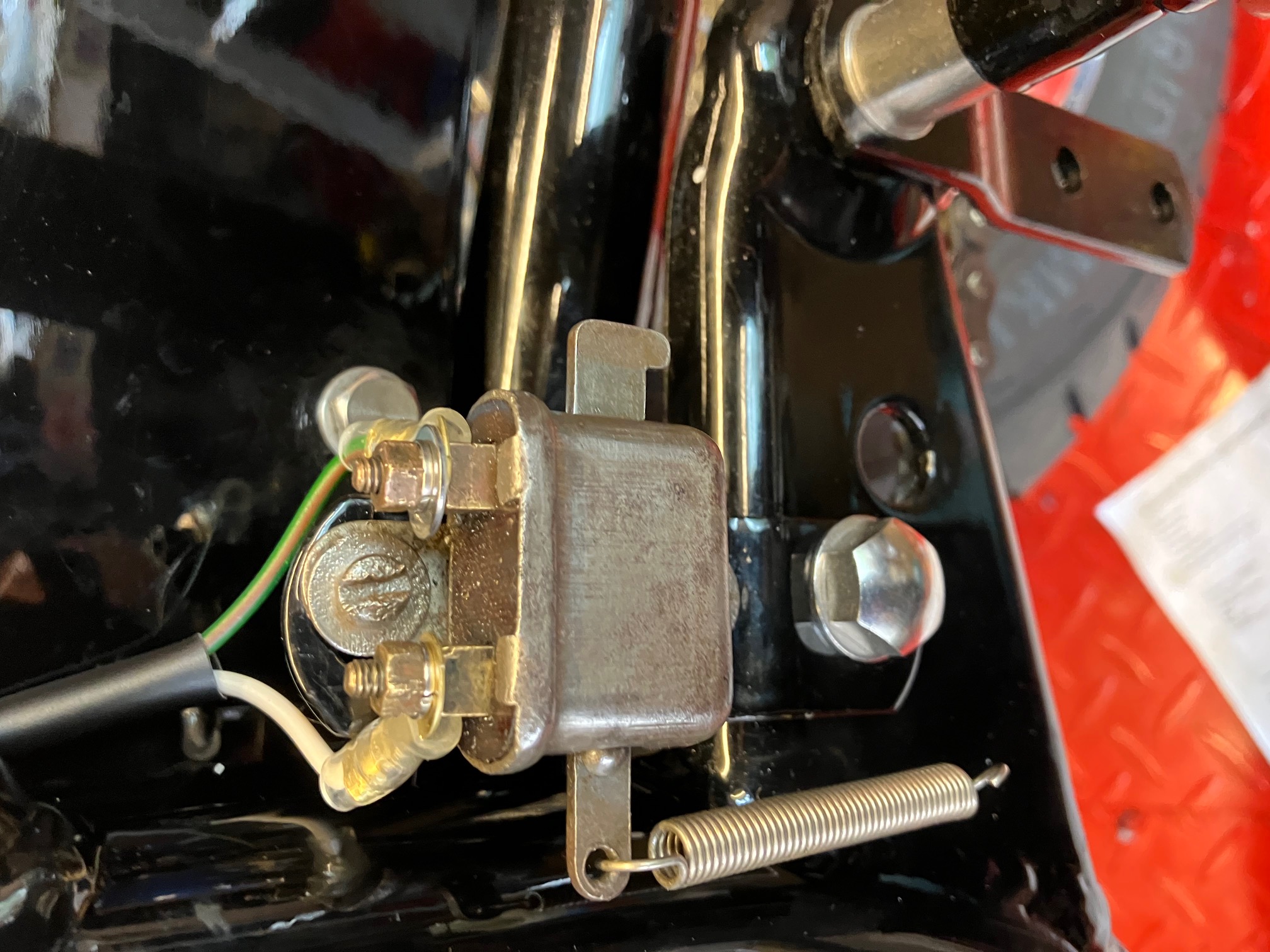

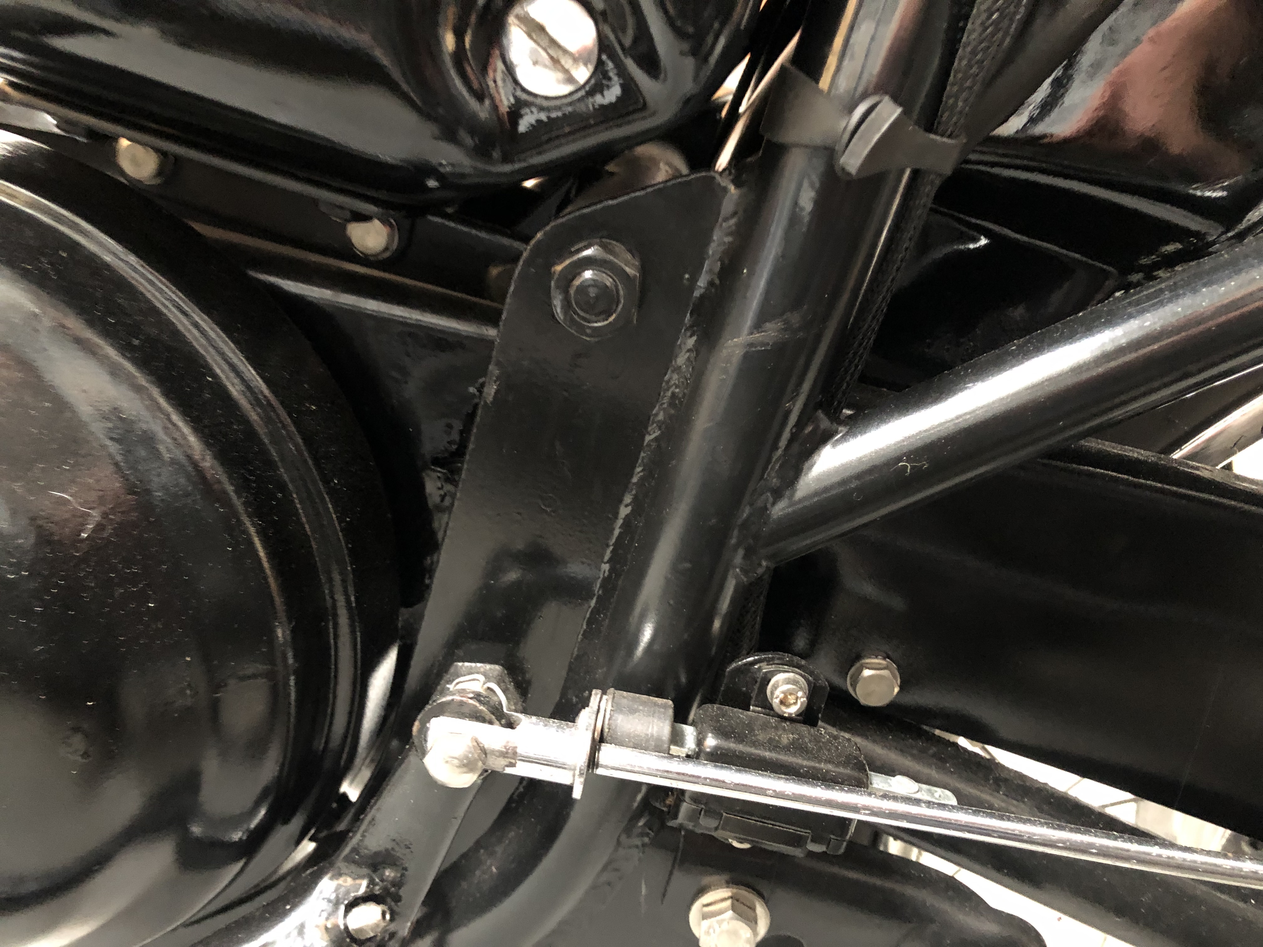

I have almost finished the re-wire part of the restoration of my 99-engined 650SS-framed mongrel and have a question about the rear brake light switch.
The pictures hopefully appearing below show the state of the switch before and after cleaning. Amazingly the switch still works well. However with the terminals facing upward, some protection from the elements/mud thrown by rear wheel would be useful.
I have failed to find an available cover/boot from the usual suspects. Are there any suitable covers about or do I have to fashion something from old inner tube and cable ties? I am pretty sure the switch should be that way up as there is a drain hole in the current bottom end. Please ignore the incorrect wire colour as it was what I had left of a suitable length.

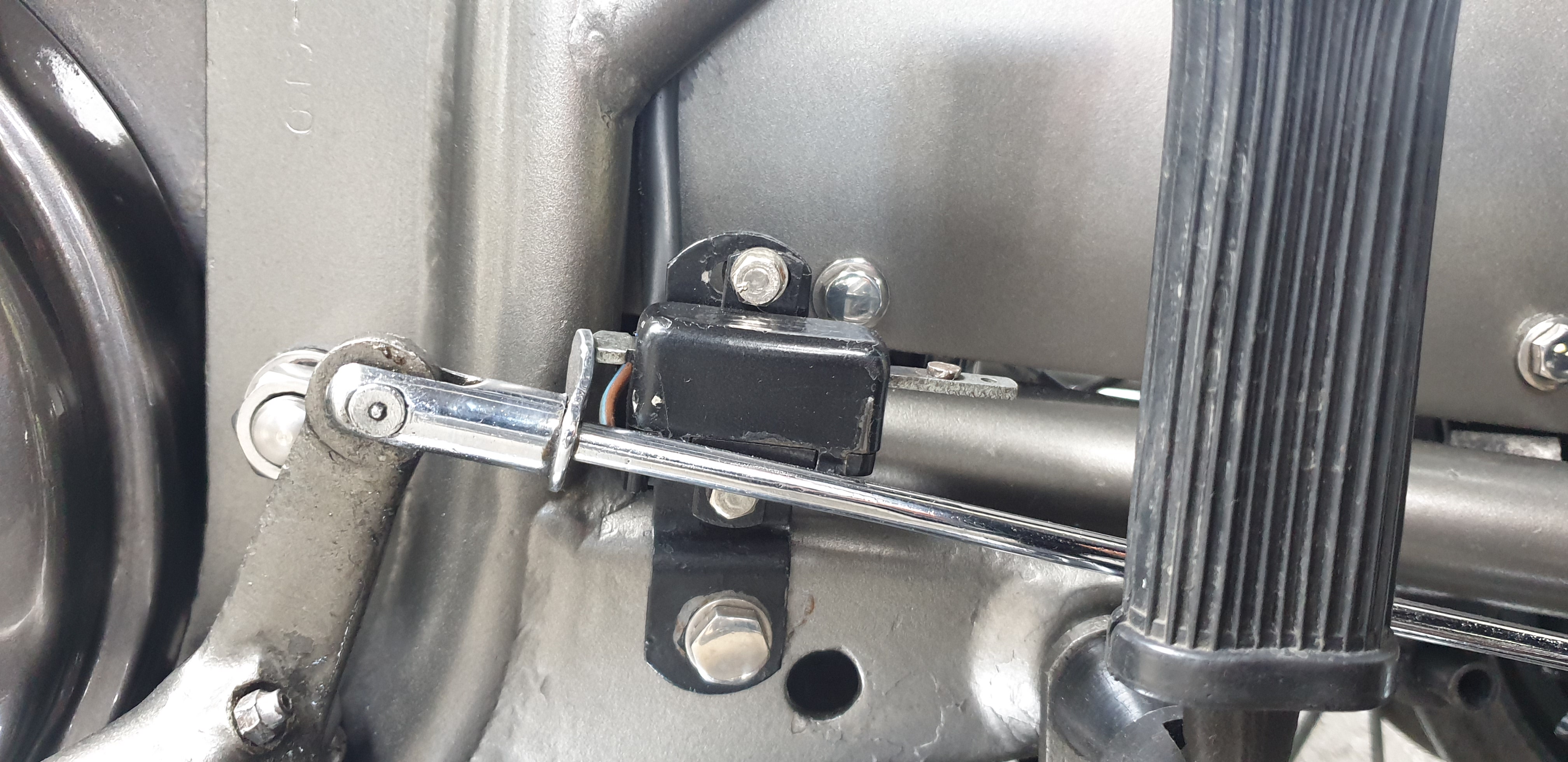

Here is a picture of what it should look like on someone else's bike.  But I haven't worked out which switch this is. It is on when relaxed by moving the tab on the brake rod.
I think it might be what Paul Goff sells as Lucas 22B.
Part SW11031L. Probably.
Thanks Chaps. Mine is pull for on, so the opposite of David’s example.
Home made cover it is.

You can open the switch by bending the little lugs back and reverse the action of the push/pull rod. The rivet has to come out and be replaced after re-assembly. That way your connections will be at the base of the switch and a little more protected. The NOC shop sells genuine Lucas for £12 and patterns for £10, btw.

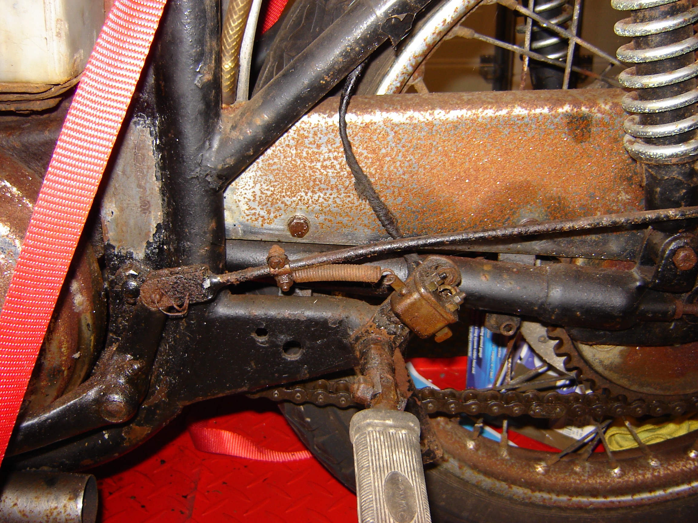

My ‘63 Atlas one looks the same as David’s…
I opened up the switch and found it was more simple than I expected.
The mechanism needed a good clean/lubricate and simply by reversing the base/contact plate, I was able to convert to push off operation. A tab did break off on reassembly despite being very careful, but the switch now operates well in the peculiar way that Norton decided to adopt.
