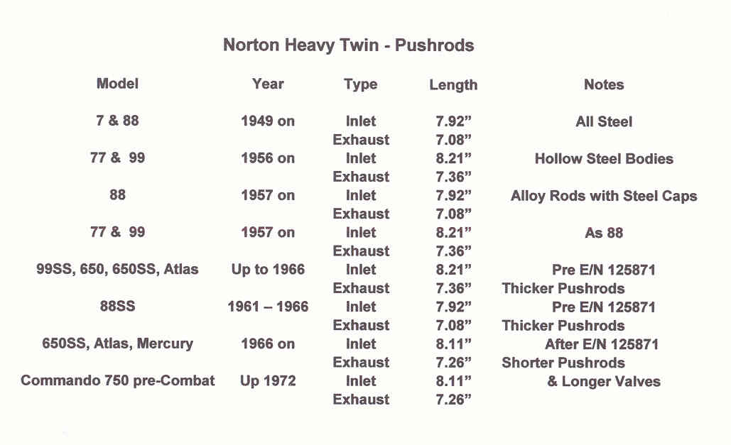

The all Aluminium Push Rod…
The all Aluminium Push Rods will not usually run properly inmost Norton engines built before1961. They are generally too fat for the Push Rod tunnels.As a result of this theywillknock against each other and the rocker ends can jump out of the cups at the end of the rods.
Also, the early Dominator engines had a poor oil feed to the Cylinder Head. This can lead to the pushrod ends running dry for a while which makes them wear very quickly.
You need to changeyour Push Rods for the correct set which have the narrow, parallel, 7mm thickshafts. Please be careful when you buy your next set of Push Rods as there are many different sizes available to fit the 88,99,650 and 750 engines.
I have attached an informationsheet showing the different lengths.
Anna is quite rightthat you will probably needto havesome serious engineering done to properly fix your loose rocker spindle. However, I have met several owners who have successfully used a specialhard setting pastesuch as Chemical Metal or JB Weld to hold the spindle firmly inside the inner mounting. These modern filler pastesare quite amazing as they stick to metal, set quickly and can be drilled and shaped to size. More good news is that they usually cost less than 10 euros for a standard size tube.
Attachments Norton-Heavy-Twins-Push-Rod-Sizes.jpg- Log in to post comments
