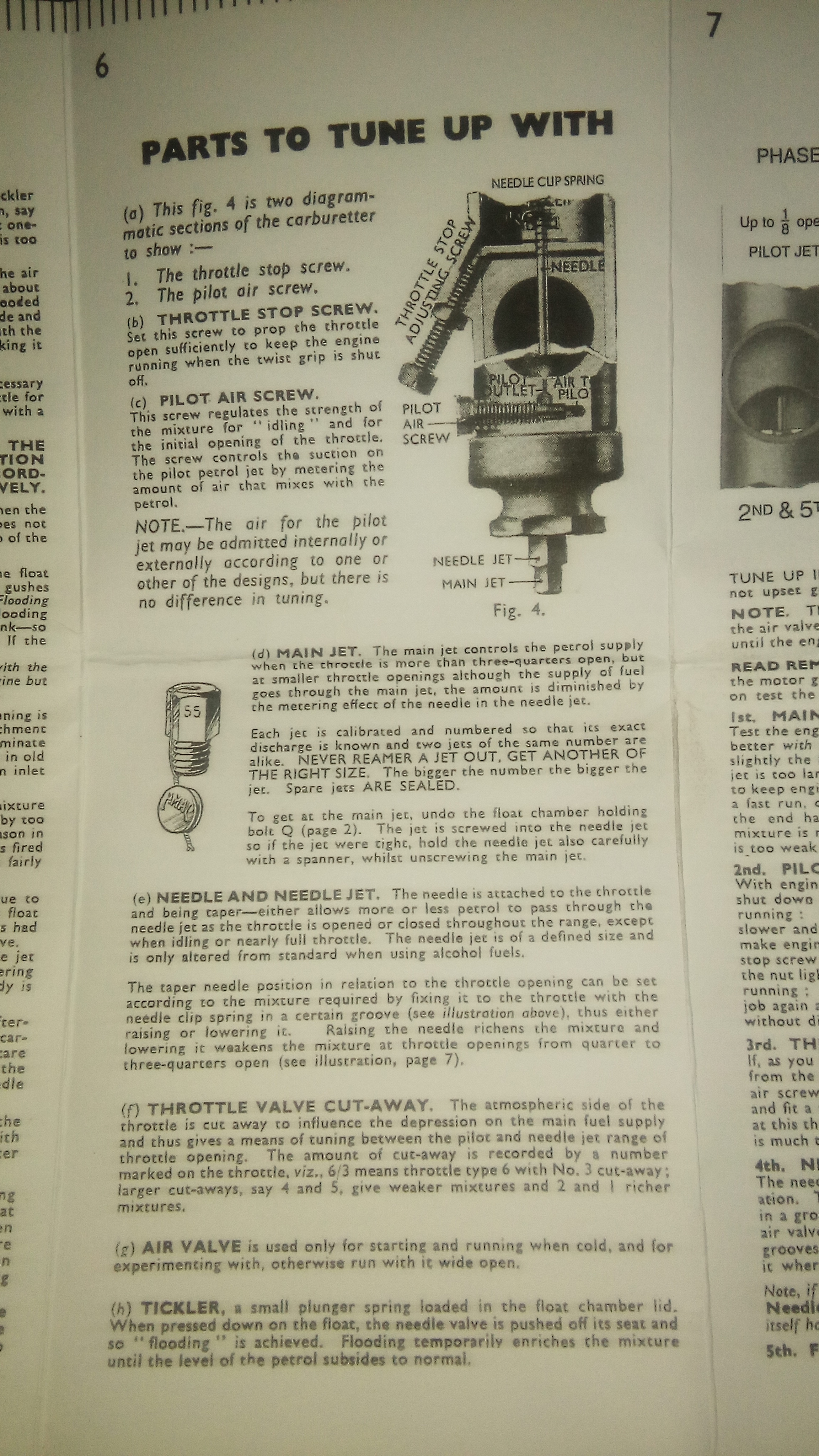

I have a 500cc clubman  inter from 1952 which has a TT carb and it causes me trouble when hot, or pulling off from cold.
 Anyone know what the settings are, especially the throttle cutaway.  Mine has a 7 cutaway on inspection which I think is too large and causing problems with overheating (weak mixture?)
 A friend lent me a 930 concentric set up for his inter and that has a 5 cutaway but on opening the throttle 1/4 plus it knocks out black smoke and misfires - rich mixture, (although works perfectly on his standard inter)  ..any ideas anyone

 The Amal carb co also lists a 7 cutaway as standard on its website but any manual I have seen its a 5 or 6

For what it's worth  these are the details of mine according to the notes in my possession.
Flange marking 34/041  10TT 34
Needle 10, middle notch of 7
Needle jet 109
Main jet 320
Bore 1 + 5/32"
Throttle slide 6 (cut away 3/8")

It may be possible to arrange an idle stop on a TT carburettor by drilling and tapping the top of the slide for a  grub screw, to press on the top of the choke tube.  I haven't tried it, but intend to experiment.
In the '50s, my father ran his International with a 289, largely for the benefit of an idle stop.
Paul
Some say they drill a small hole (but how small?) through the bottom edge of the slide. Or file a little notch. Neither strikes me as being reversible..
