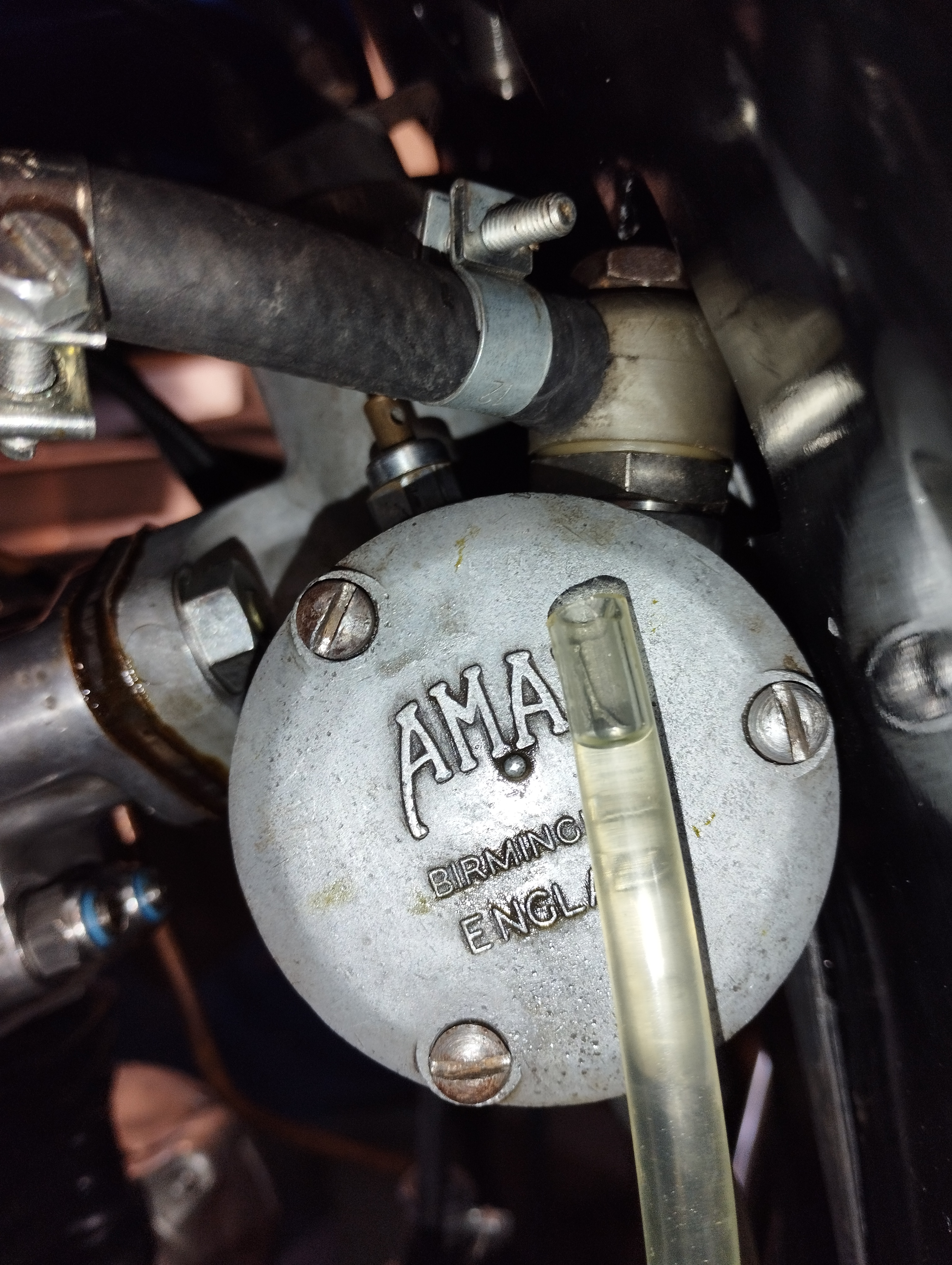

The monobloc carburettor(s) is in good shape, virtually no wear.  Float height is spot on, see photo.
