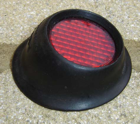

Hi Jim,
I've posted a photo of a reflector that I have and although it is different to the one in your picture the angled base looks about the same and probably only the anoraks would notice that it isn't correct. If it is of use to you it's yours for the cost of postage,
Regards Rob.
Attachments DSC01081a.jpg- Log in to post comments

Hi all, Rob, thanks for th…
Hi all,
Rob, thanks for the offerbut that reflector is an RER2 and they are huge and I know won't fit but your reply and kind offeris appreciated. Unfortunatley I am an anorak and the details must be right as the bike is a lucky survivor. The only 'wrong' parts on it are the handlebars (specific to 1955 only), front wheel rim, exhausts (replaced circa 1961)and horn button (1955 specific part)& dipswitch (both no later than the 60's).
