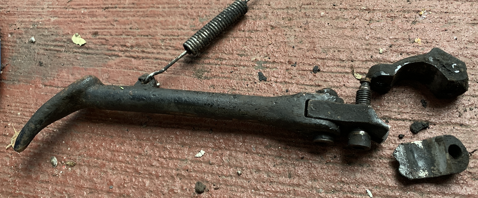

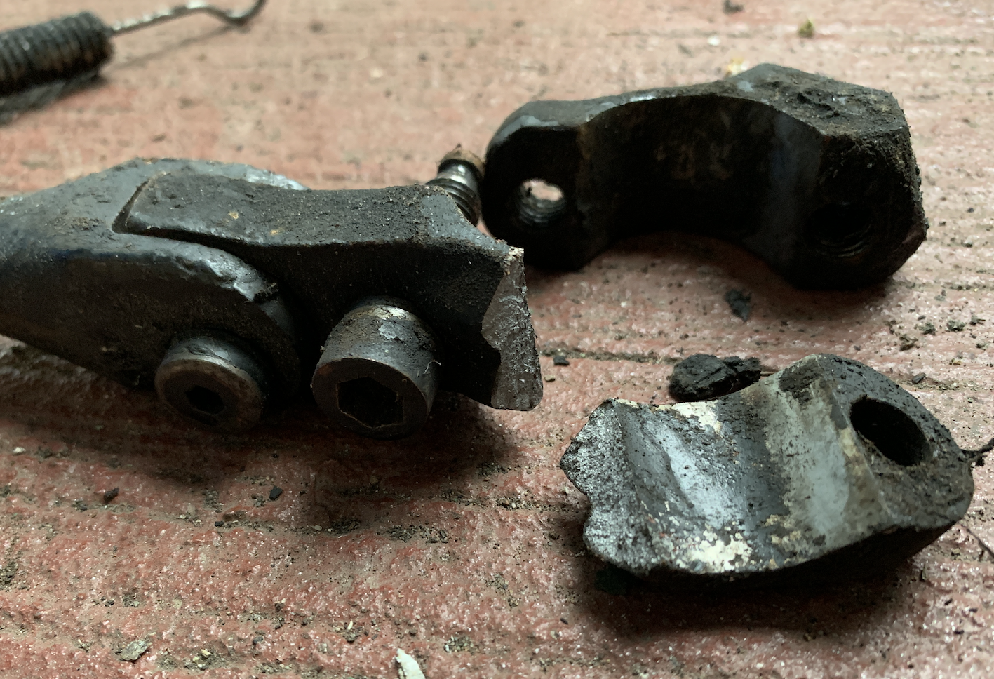

Hi, my side stand bracket snapped tonight. Can anyone point me in the right direction for a replacement bracket? Thanks in advance.

Ian  you have no idea on welding  cast steel  weld can be better then the original steel  the art is getting the right amount of heat in to the material  I have been welding since I was 16 that 51 years  you can tell me anything about welding   I started at a shipyard  back in 1967  welding Gas Mig Tig And Arch welding    and Hot riveting  and forging plus black smithing,  I can make this stand better then new and I challenge anyone to do any better,   Yours  Anna J

Is the bracket made of cast iron or cast steel.
There is a world of difference between the two when it comes to welding.
This is the reason that Norton Matchless Divison, designed and produced a much stronger, wider and thicker prop stand lug, with an 035 part number in 1968. Norvil, sell the better and stronger prop stand lug. The reason that this bracket lug can break is that some owners will try to start their twins on the prop stand. These prop stand lugs would break all the time. Many a frame that has been returned from North America has had that lug welded to the lower frame rail.
It would be so much safer for you to buy a new side stand bracket.

I bought a side stand from Andover Norton for my 1960 Dommie 99. I got it from AN as I thought it would be a good fit but it’s not. When I fit it with the bracket leaning against the engine plate (as advised in the instructions), the bike leans over at such an alarming angle that it looks like it will fall onto its left side. To get to a ‘sensible’ lean angle, I’ve had to twist the stand bracket around the frame rail so that there is a 1.8mm gap between the back of the stand bracket and the engine plate. I now have to work out how to fit a 1.8mm spacer plate between the stand bracket and the engine plate (I don’t have welding gear). Side stands are useful but even buying from ‘the better supplier’ isn’t necessarily an easy solution!

If the stand leg is at too large an angle to the frame it lets the bike heel over too far as you describe.
All you need to do is remove the leg and build up the stop with weld to prevent the leg from opening too far. It helps if you add too much weld and keep dressing it off between trials to get the correct bike angle. Much easier than trying to adjust the mounting bracket.

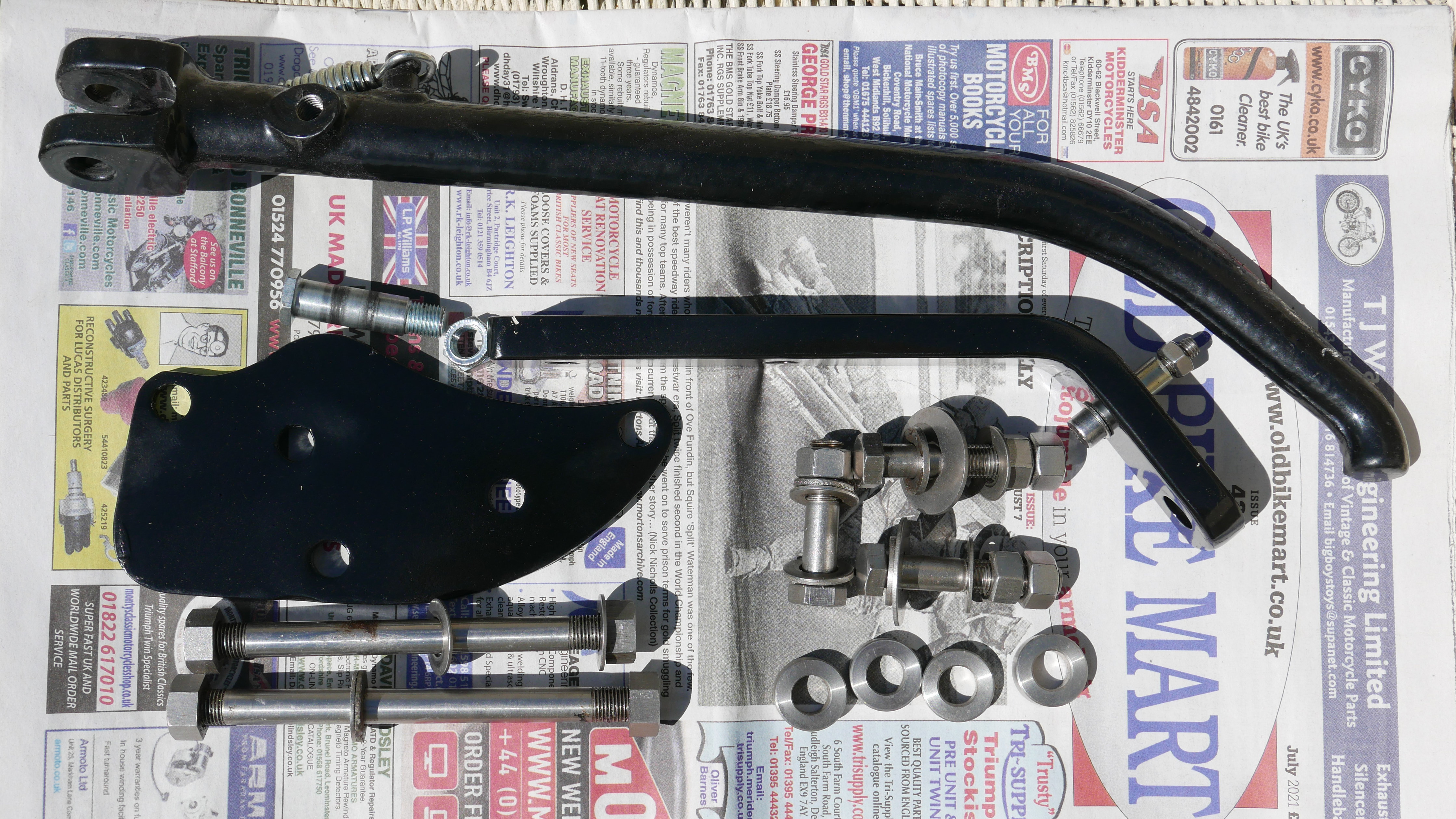

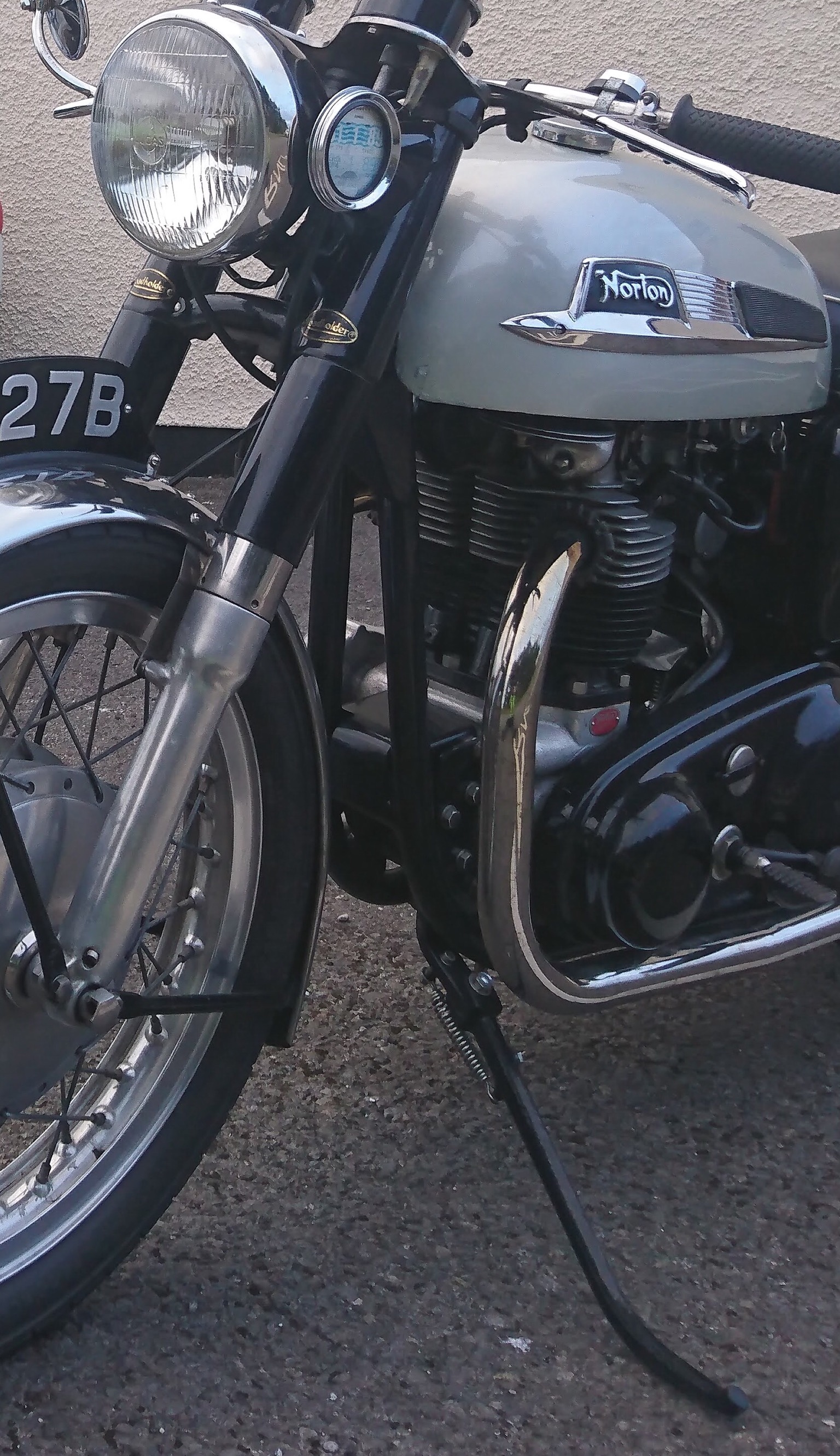

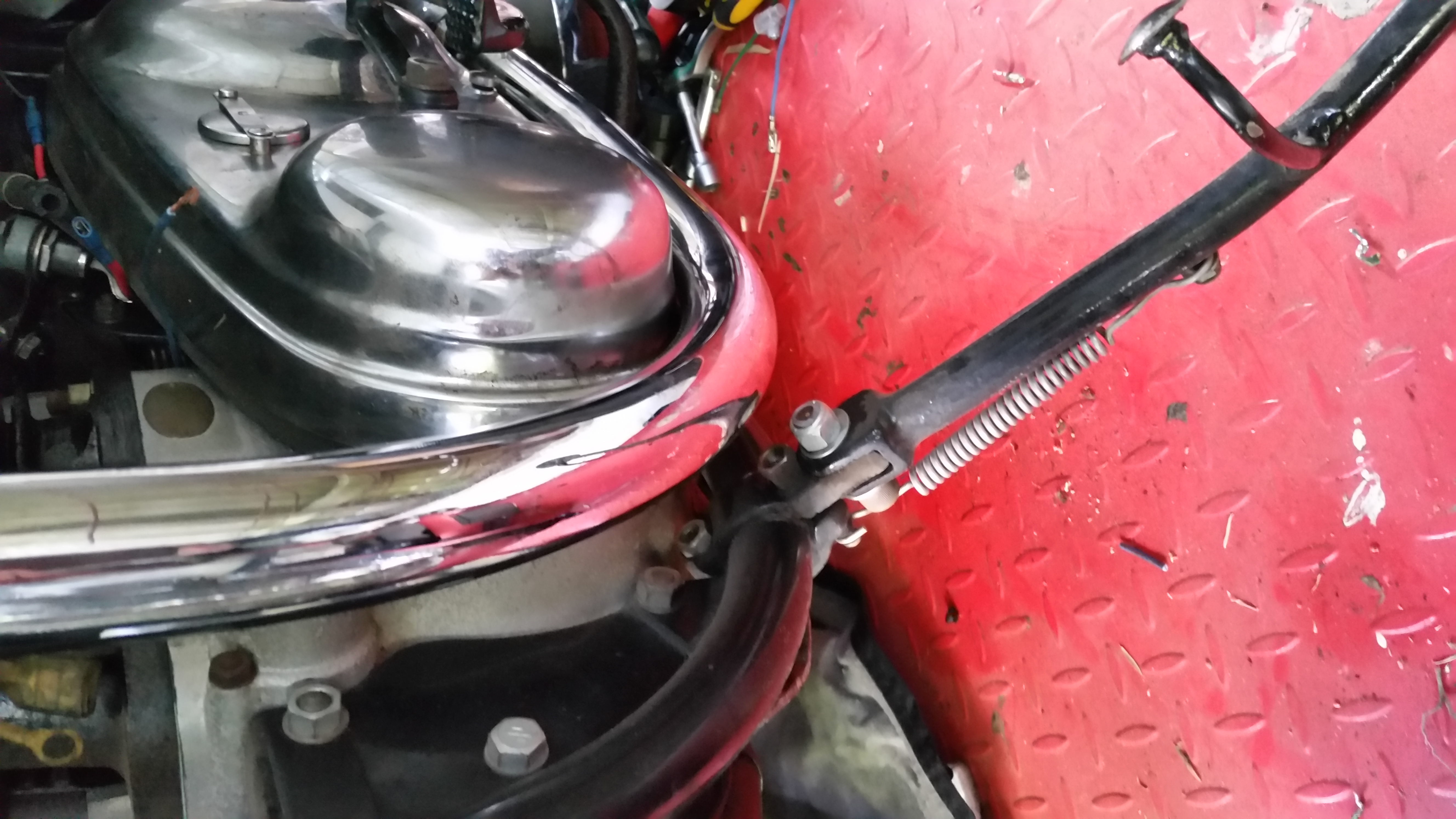

My original side stand failed in the usual place when the cast bracket broke into two pieces. I also did not like the stubby stand, I always was unsure if it would fall over or not..  So I used a late 60’s Triumph/BSA twin stand, which I bought new as Harris still make them and made a bracket that is bolted to the front near side engine plate. It folds away perfectly.
For belt and braces I added an extra engine plate outboard of the front lug, just needed some 1/4 inch stainless spacers and slightly longer front engine mounting bolts ( all available on eBay).  End result for less money than a replacement stand and bracket for your favourite Norton spares supplier is a rock solid and trusty side stand. A real bonus is that I did not have to dismantle the primary transmission to fit it and will not have to in order to maintain it  in the future.
You may be able to use Tri/BSA stand to fit your welded on bracket, unless your lug is female  - for  a commando stand.
That looks a really great job Edward,  any chance of some more pics of the bracket etc and the stand in the up position?
I have been intending to make something up to fit a spare Velocette propstand to my 350, but I really like what you have done.
Thanks for your comment Niall.
I have attached 3 photos showing - the bits required - before painting the extra engine plate and a slightly more detailed shot of the finished job.  I did not take a shot of the stand folded as it more or less hides behind the exhaust, with only the tip sticking out below the footrest. As much if not more ground clearance than the standard stand.
PM me if you want any more info: I can send you the sizes etc if you want, and I also have the alloy template that I made for the mounting lug (to get the best length and angle for the optimum lean angle), which is no use to me now.

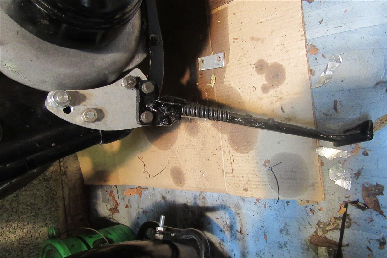

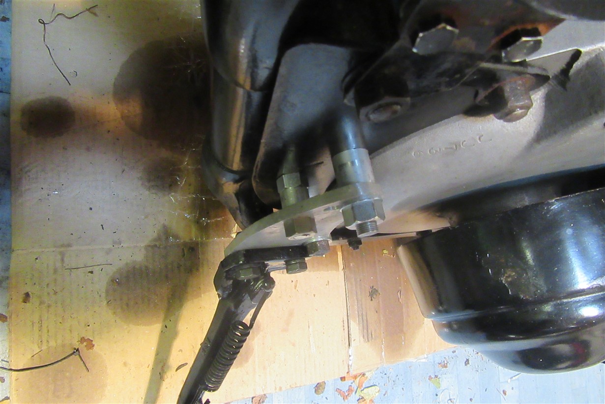

Some years ago I came up with my own version. I purchased the side stand clamp from RGM and fitted the clamp to the frame tube and braced the clamp to the front frame mount. This was time consuming but the result well worth it. In the pic notice the cut down coach bolt. The round end is all that protrudes from underneath of the exhaust pipe. I can deploy or retract the side stand whilst sitting on the bike.
... that's a very neat job.
