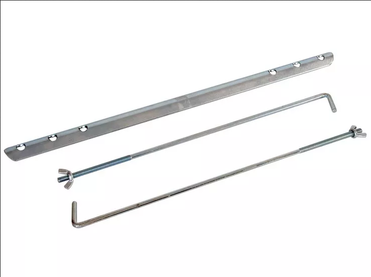

Is the clamp you refer to as per Bob's picture?
I wouldn't mind fitting a strap as a 'belt and braces' solution.
Halfords battery clamp
I used a battery clamp from Halfords and modified it suit.
Drilled some new holes and shortened the top bar, then cut the screwed rods shorter and re- threaded them - I think it was M5 or 6. I bent the curved bottom bits a little more too. It works a treat and uses the original holes in the battery box.

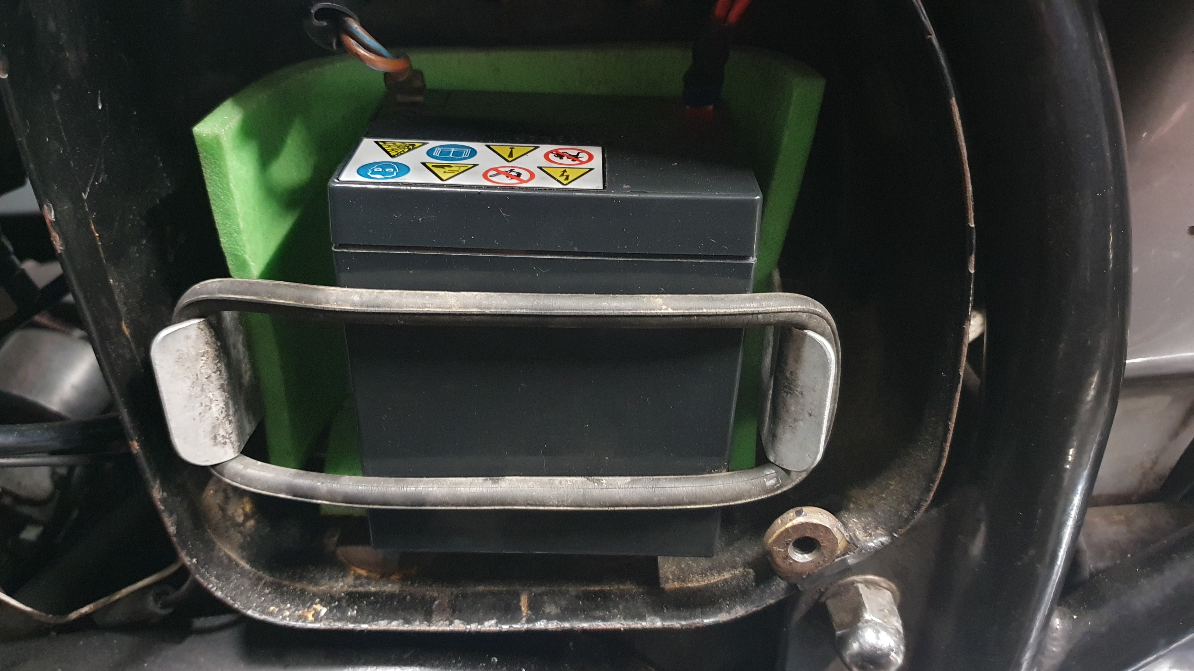

This is mine. Made for…
This is mine. Made for Yuasa. Green stuff is camping mat.
Cheers David....Thanks for…
Cheers David....Thanks for the photo of another solution.
I am sure I can make something work now...Love the camping mat btw.
Thanks to all for their input.....Much appreciated.

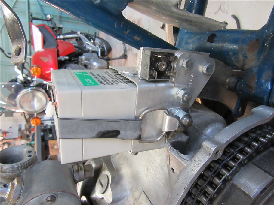

Bits of wood..
... and elastic bands (usually bits of old inner tube) are my regular solution to battery location as on my current Tri-Greeves project:
