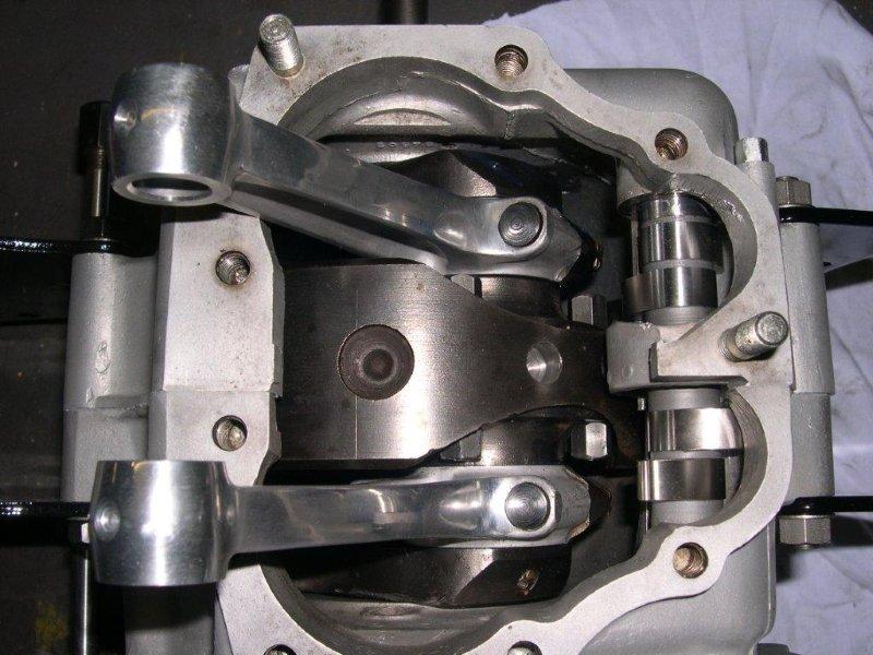

Hi Bernard,
If it was running well with the old pistons, i would weight the new / old pistons to find the difference and then remove the weight from the crank. Generally this is done by drilling holes opposite the counter weight as per picture attached. Below is a table showing what the weight is by drill size per 1" of depth.
1" depth = the drill sizes to weight are:
Hole Dia 1/2" 7/16 3/8 5/16 1/4
Castiron = 0.880.680.500.350.23 ounces
Any questions i can be contacted @ nortones2@internode.on.net
Steve

Hi Bernard,
Steve
