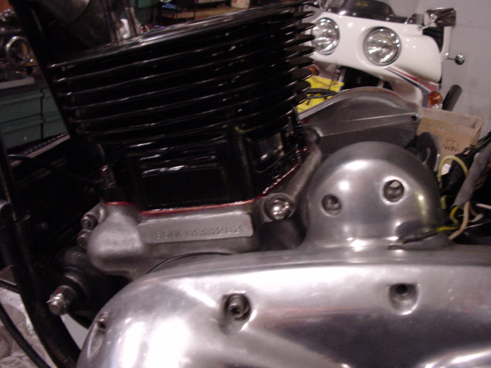

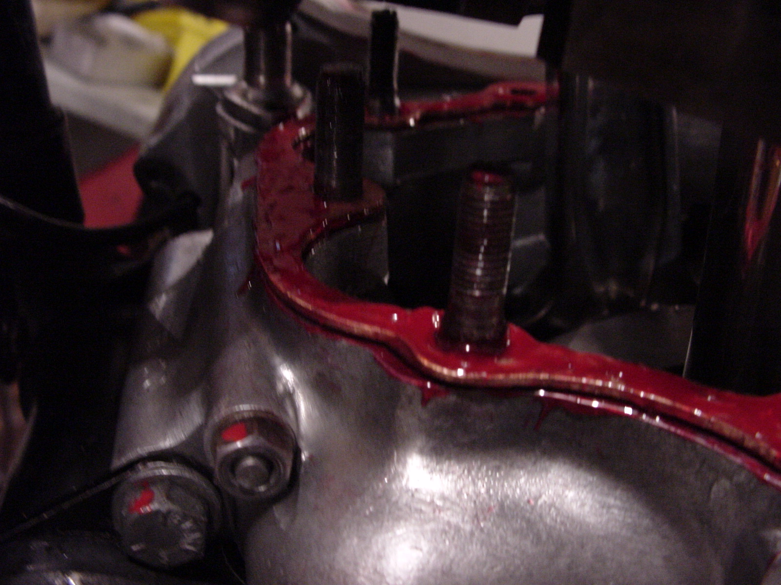

I had to use a copper …
I had to use a copper cylinder spacer and locktite sealer to get my engine right after too many head skims
