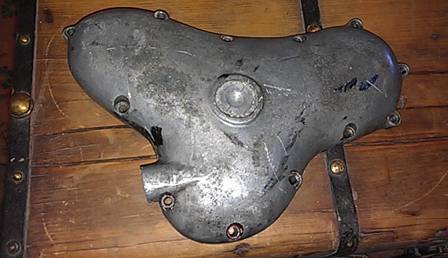

Hi, I ave found 3 timing c…
Hi, I ave found 3 timing covers in the USA but one has a slight difference, 2 covers have the number 25186 and the boss on the outside is round, the other case I have seen has the boss on the outside and is in a diamond type shape which seems to match the shape of the smiths gearbox drive part number BG 1508/05 which is currently on ebay as well.
Can any body tell me if I am going in the right direction and the gearbox # BG 1508/05 is correct or if not correct for the year will work anyway,I have single Nortons and this is the first venture into twins.
As this is going to be a cafe racer for my son I am not worried about correctness only that the parts I buy will work. I did notice that the timing covers on ebay are slightly different as mine #20949 has only 1 entry on the bottom left which I think is oil pressure relief.
The other covers have 2 entries a larger one on top and a smaller one underneath, I would like to post the photos but ebay will not let me as such.
So can anybody shed any light on how I am progressing.
Thanks again Andy

I think that the item on e…
I think that the item on eBay @ £180-ish is the same as the one in the NOCshop @ £92.50. Similar to the original but not the same. Original Smiths 1:1 drives in good nick are like hen's teeth. Please, please somebody contradict me!
Also beware of getting the correct rotation, but I don't know which is correct. Buying from the club must be safe though.
p/n SS02 D3_24563I think they are being made by Speedograph Richfield - checkout their website

Hi Tony, Thanks for your reply but I picked up the correct timing cover yesterday.
