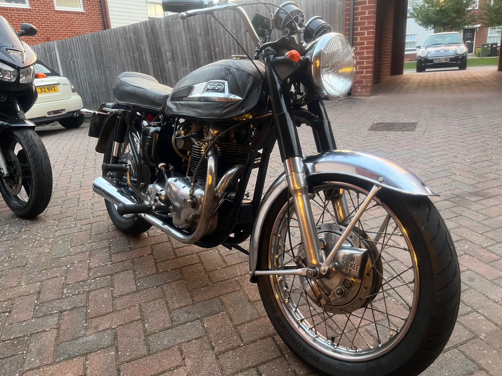

Total rookie here fellas, so please bare with me!
Doing my first complete bike re-build, wife said I needed a hobby?! When re-building engine, other than obvious worn or damaged looking parts, what else should be replaced rule of thumb. Rings, valves, obviously gaskets and seals, maybe springs, etc...... Bike was running before being stored 10 years ago, approx 20k on engine
Appreciate the help!!
