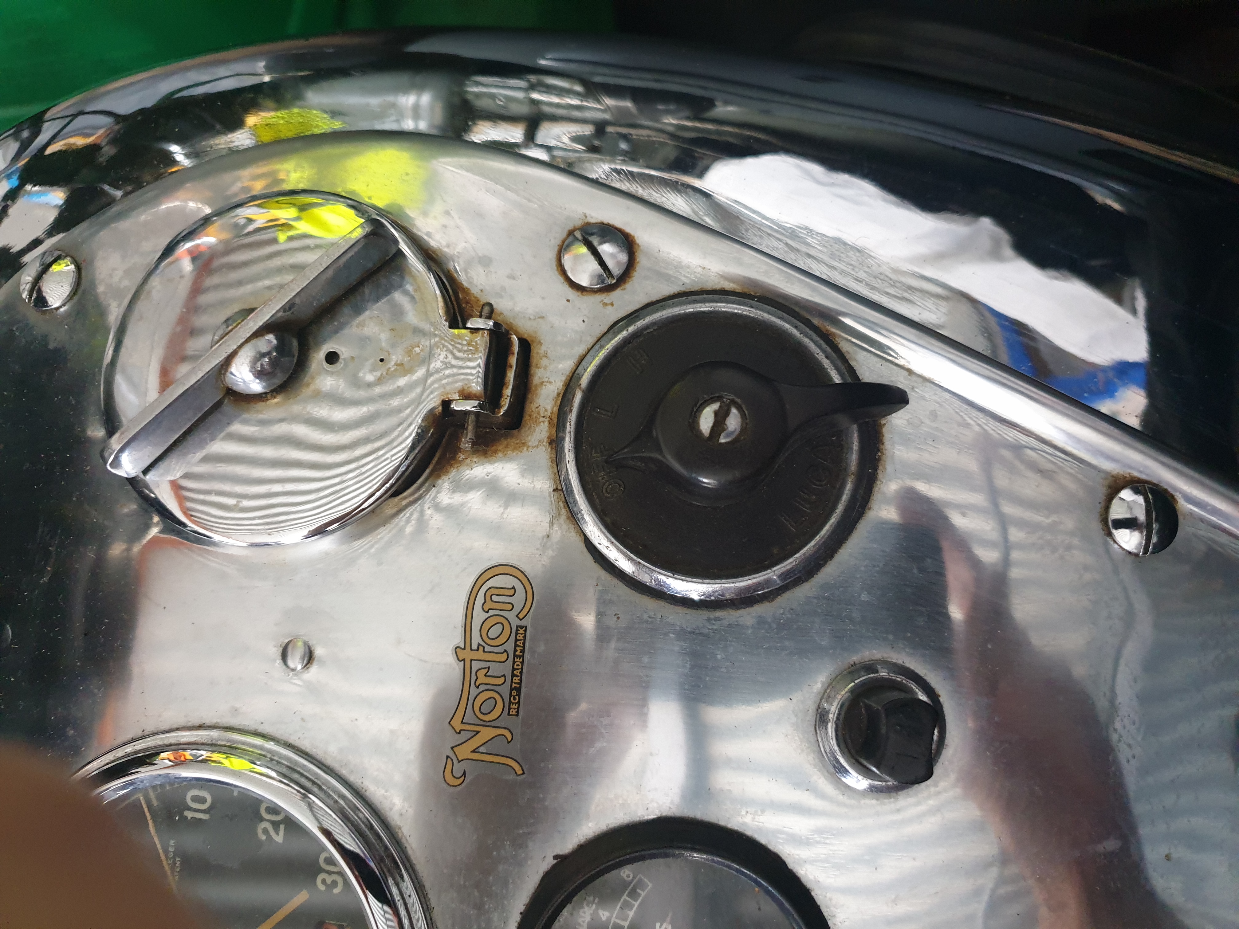

Mine have a hole in the tank…
A test for this...
... is next time it stops pop the petrol tank open and if you hear a hiss of air entering then that's your problem.
Fading when warm / hot is often a sign of a magneto capacitor on its way out but look for the cheap fixes first!
What are the chances of mag…
What are the chances of mag capacitor going in a fresh rebuild…30 miles on it.
After a peek at my cap, I…
After a peek at my cap, I have a very very small hole. After looking at David’s picture with one large and one small hole should I drill an extra hole? Not trying to sound lame just curious if this will help?

That's one hole and a speck…
That's one hole and a speck of dust! The usual test is to release the cap and see if that helps immediately.

Mine have a hole in the tank caps. With a little pierced metal tab below it. The gasket needs to go around outside the hole and not block it accidentally. The hole can of course get blocked.
