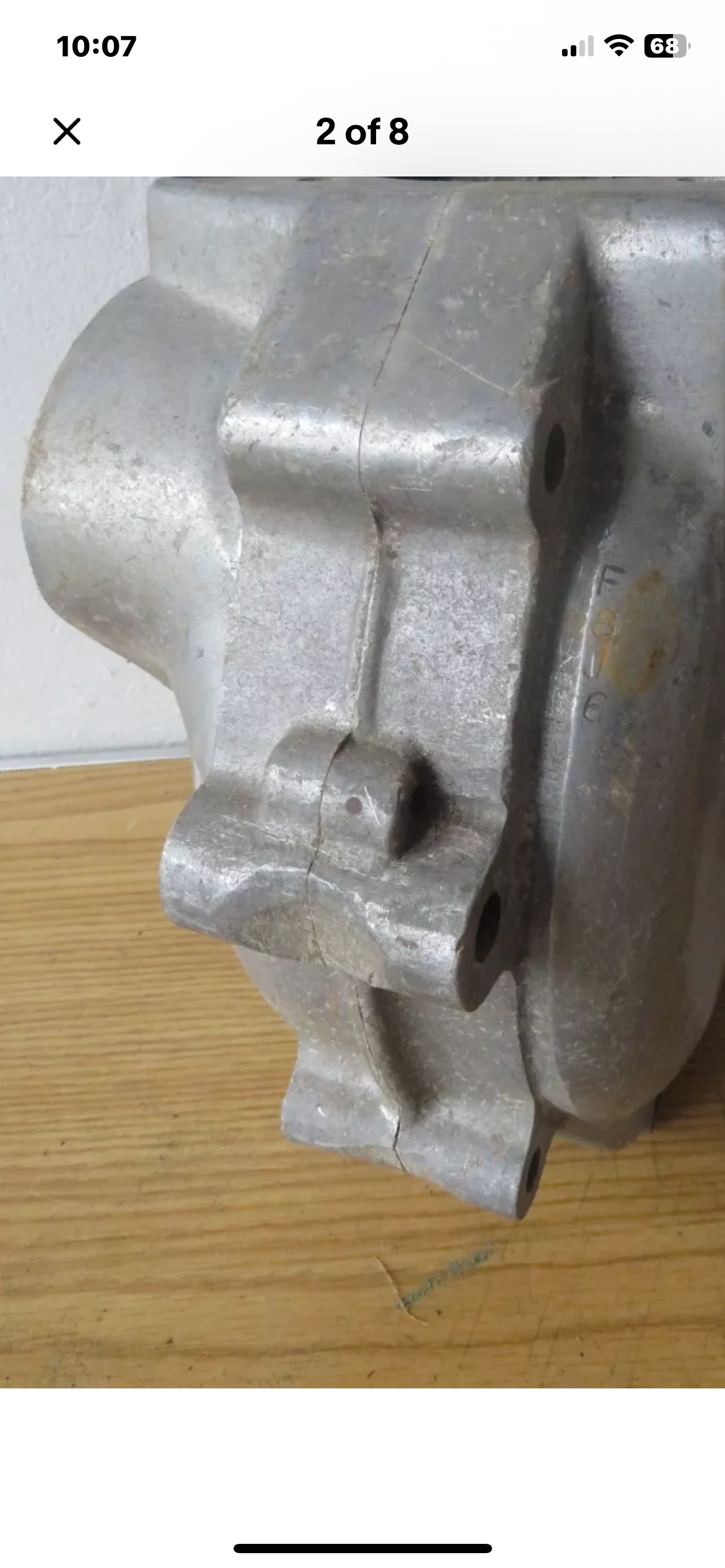

The only difference I can see is this below which I would assume to compensate for the frame design (enclosed)

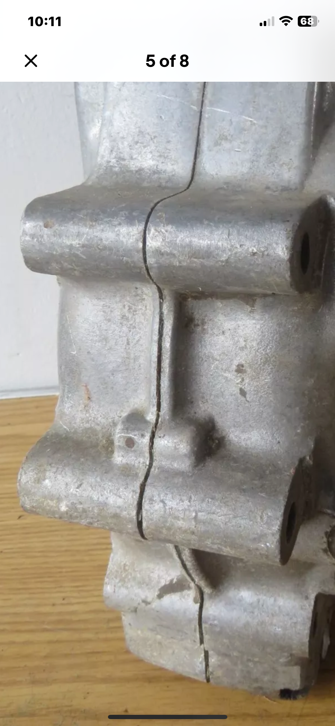

The first picture is of the engine case that was fitted to the bike, 1946 (example)
The second one is the spare engine case 1947 that I will have to use Richard

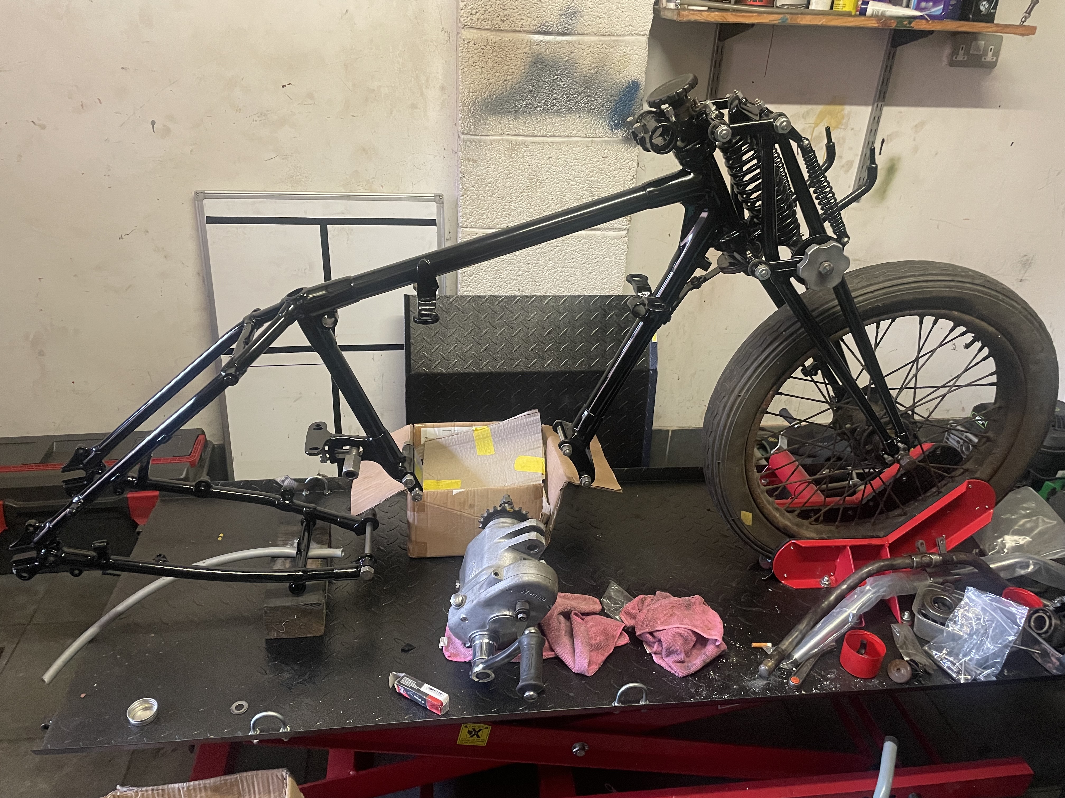

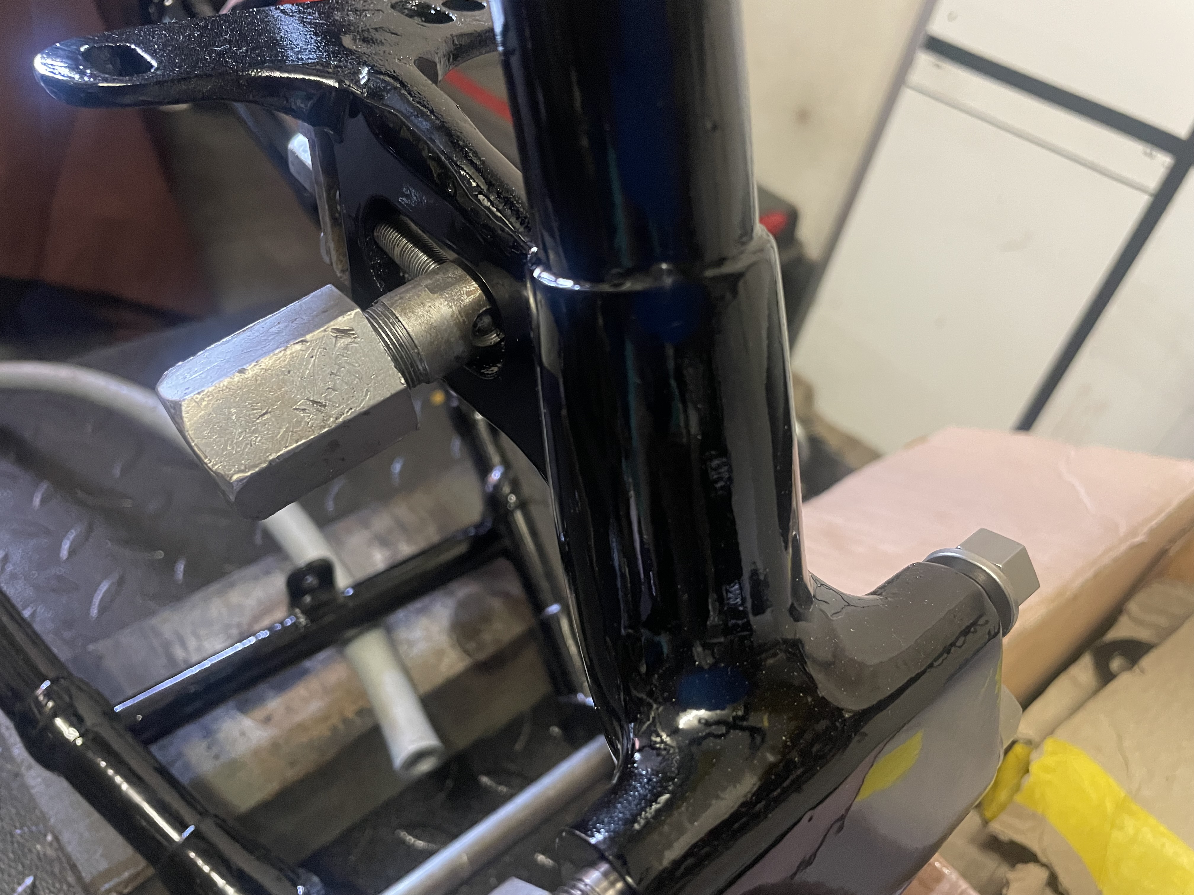

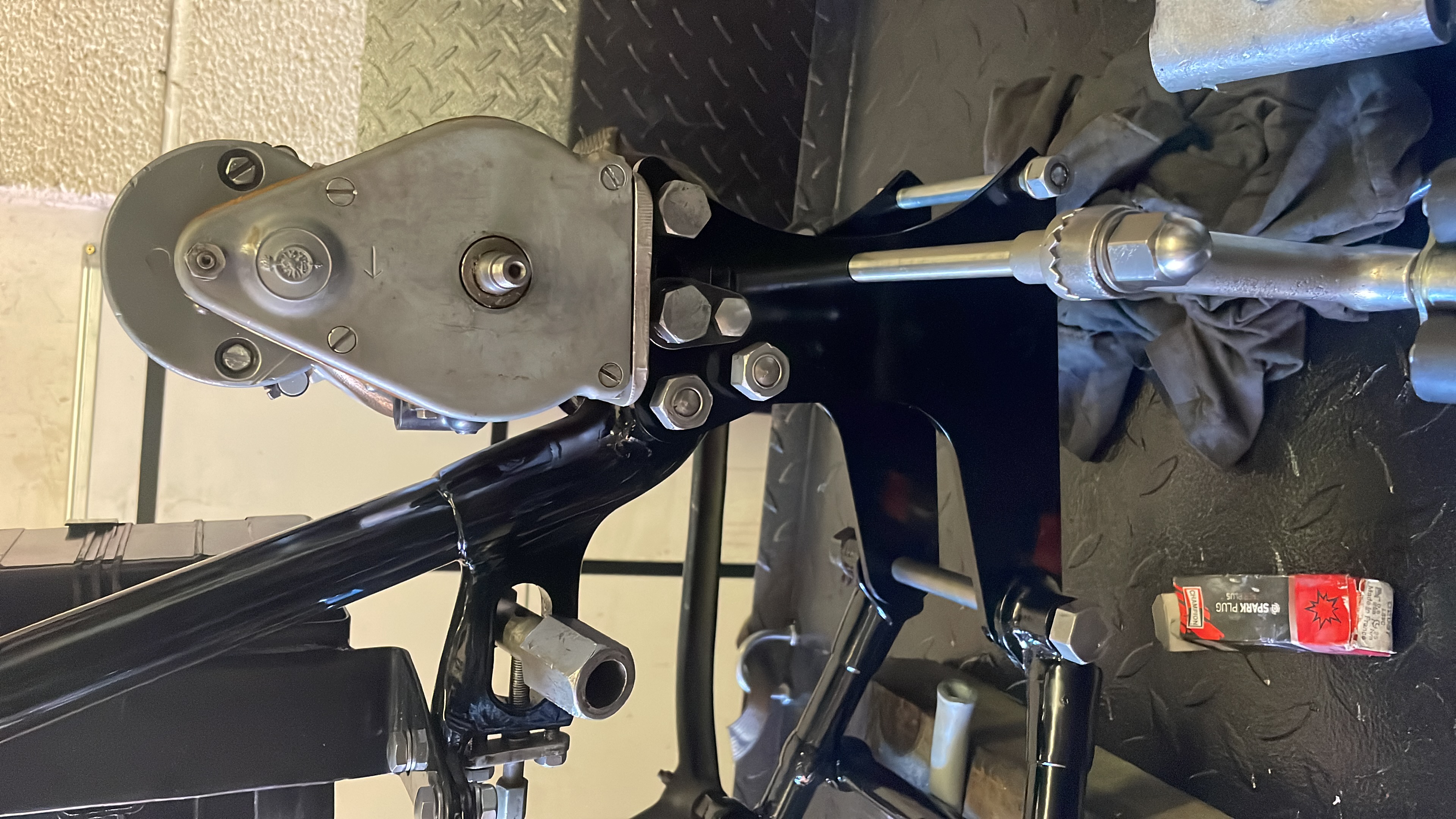

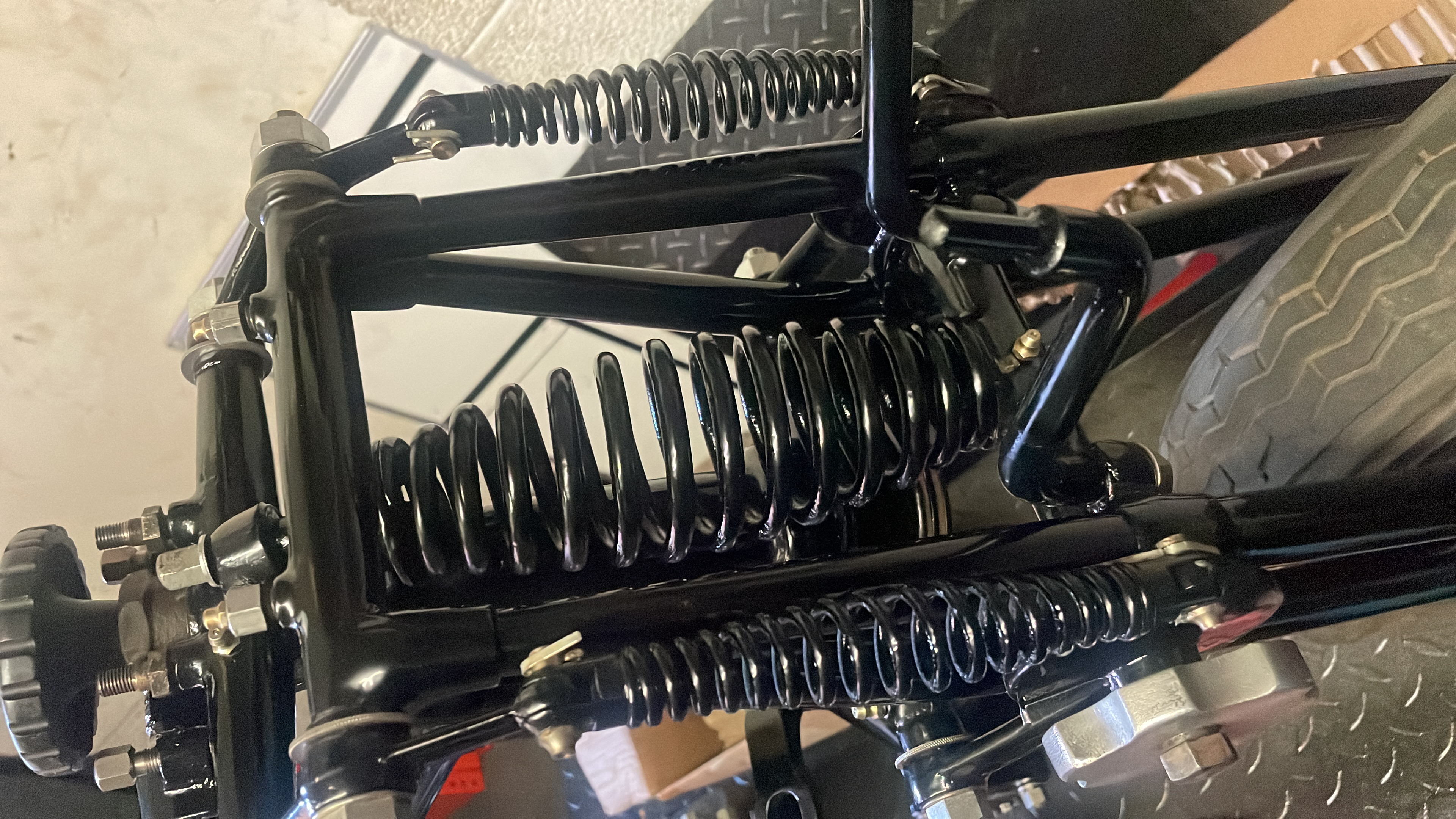

So continuing on after many months, it is slowly coming together. As you would remember, the frame was not and had some bad repairs,in great shape, but I do have the documents for the frame so that had to be restored. The frame ended up at Jake Robbins Engineering and he did a fantastic job.

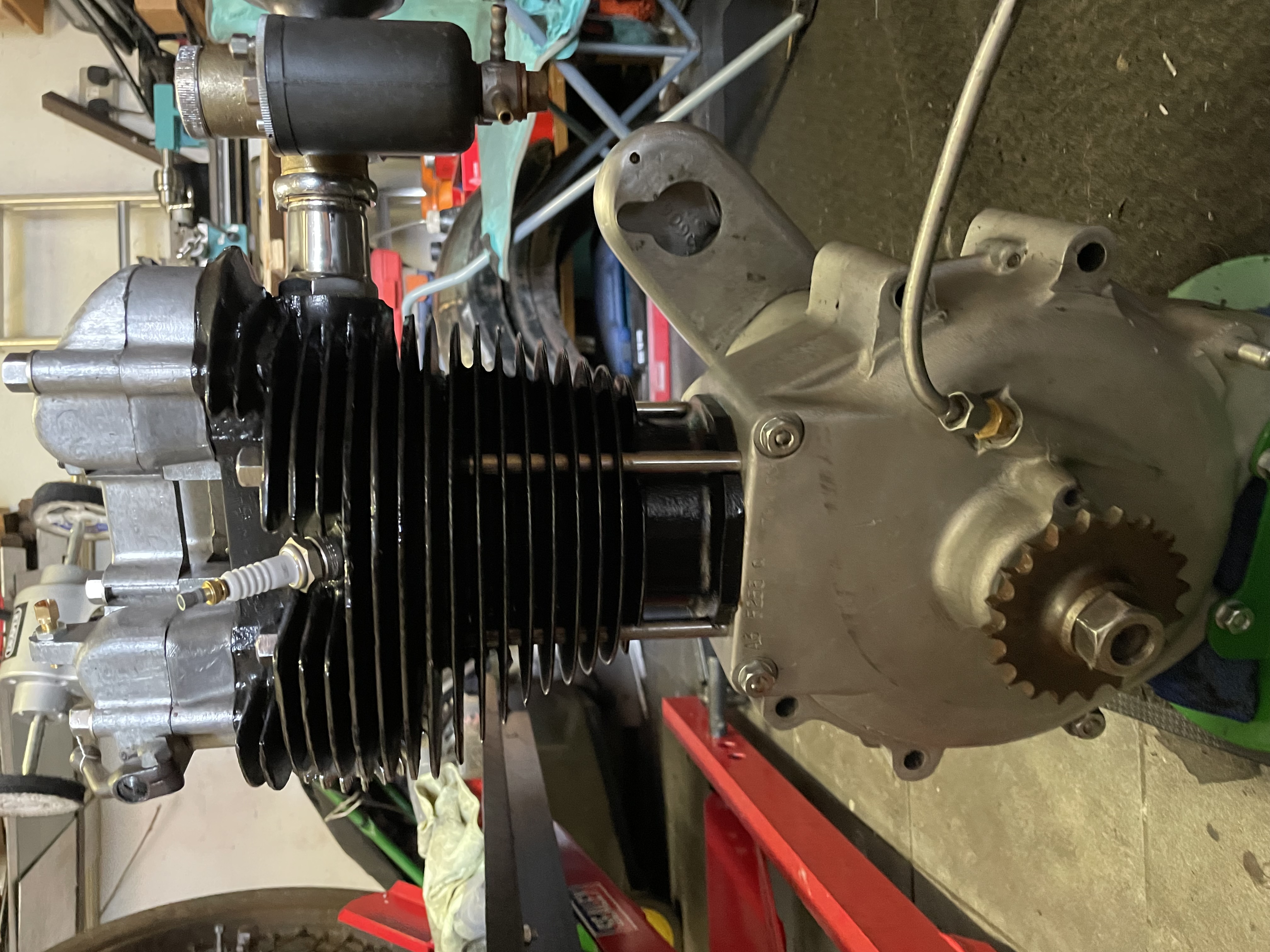

Hi Matthew,
   Your restoration looks a very good job. Just looking at your 4th photo, the magneto rotation is wrong for a 1946 engine, unless someone has mixed some of the parts during a rebuild ?
In reply to by richard_cornish
Hi Richard, hope you are keeping well.
I'm pretty sure it should be clockwise rotation and that's how I had it restored and assembled.
I'm hoping it's just the wrong cover on it, Would that make sense?
cheers
matt
Hi Matthew,
   Yes, after a second look I can see the H-T socket has been moved to the other side of the body. Don't forget this will be tight wire advance now the rotation has changed.
Hi Richard
thanks so much, are we basically saying that it will operate but the advance retard control will be the other way around?
Hi Matthew,
   Yes, that's correct and is an anomaly of Norton OHV and SV models of this period. The only problem being that the lever can gradually work back to retard while you are riding with-out you realising it is happening. Best to keep the lever as tight as possible while still being able to use it for starting.
Thanks so much, Richard.
I think I will be looking for the right unit as my rebuild will bug me if it's not factory correct.
Will start looking:)))
Hi Matthew,
   Sorry, I think I might have put you at cross purposes as the tight wire was an original specification for your engine. All OHC and 1948 onwards singles had slack wire advance, which is the best option and this was the gist of my earlier post.
Hi Richard
yes, okay I get it, Thanks for clarifying my other Norton M18 Is a tight wire advance and yes does slip back to retard position whilst riding.
It's part of the characteristic of these Amazing machines.
Back to making the foot rest tubes now:))
Thank you again, Richard for your valuable knowledge!

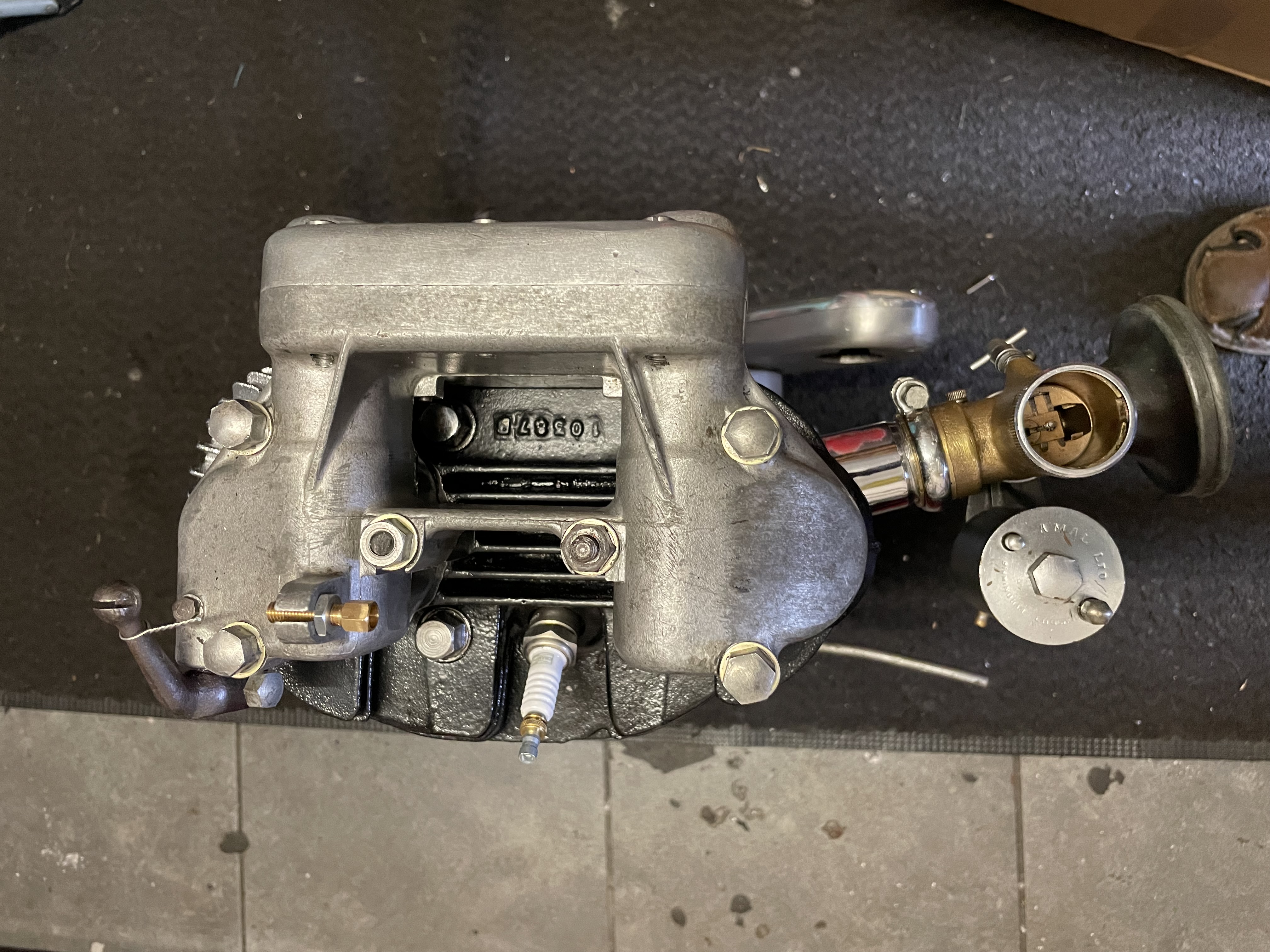

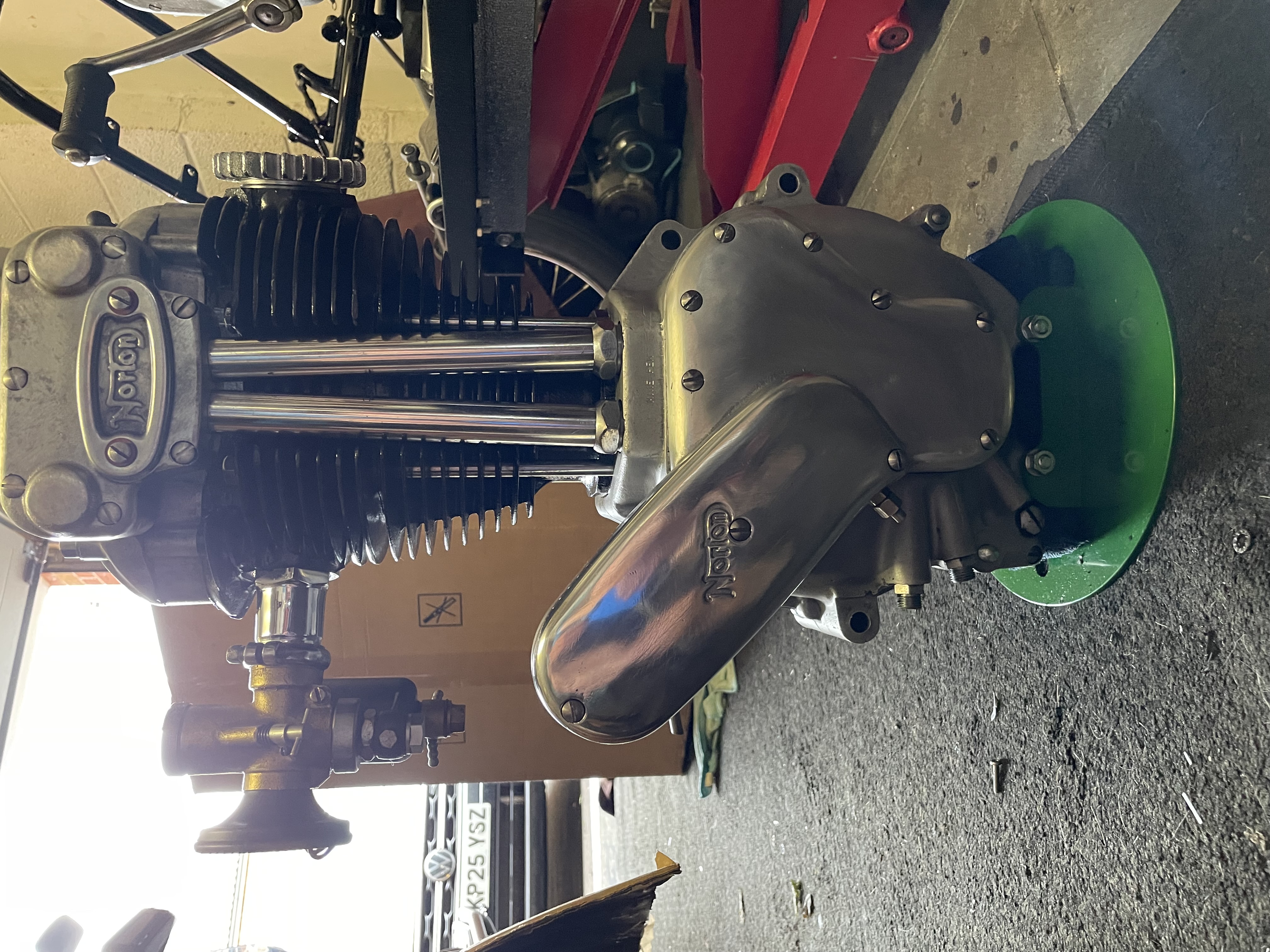

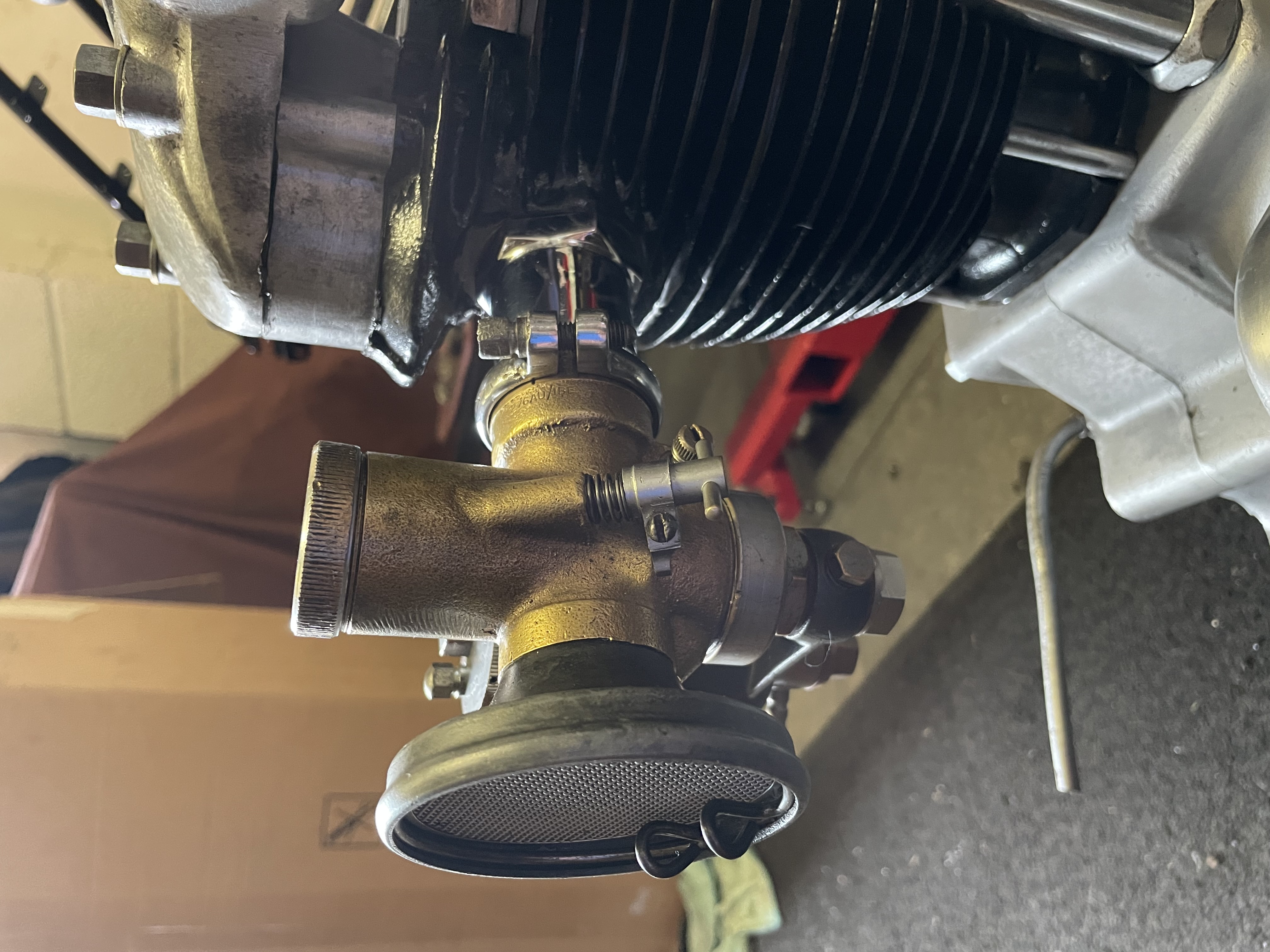

So as you know, I was undertaking the engine rebuild, However, even with all the new replacement parts at some cost, it's not a simple case of just fitting them correctly as some of the parts just didn't fit.
So I took the engine to Mike Pemberton And with his machining Capabilities and knowledge, he completed the engine for me. With a few internal enhancements.
It was a 60 thou rebore And the correct bearings throughout and crankpin..
Also located the short inlet manifold For the 276AU Carb As the original was missing.
if you're reading this Mike, thank you very much for your time and again, Richard Cornish for your amazing assistance so far :))))

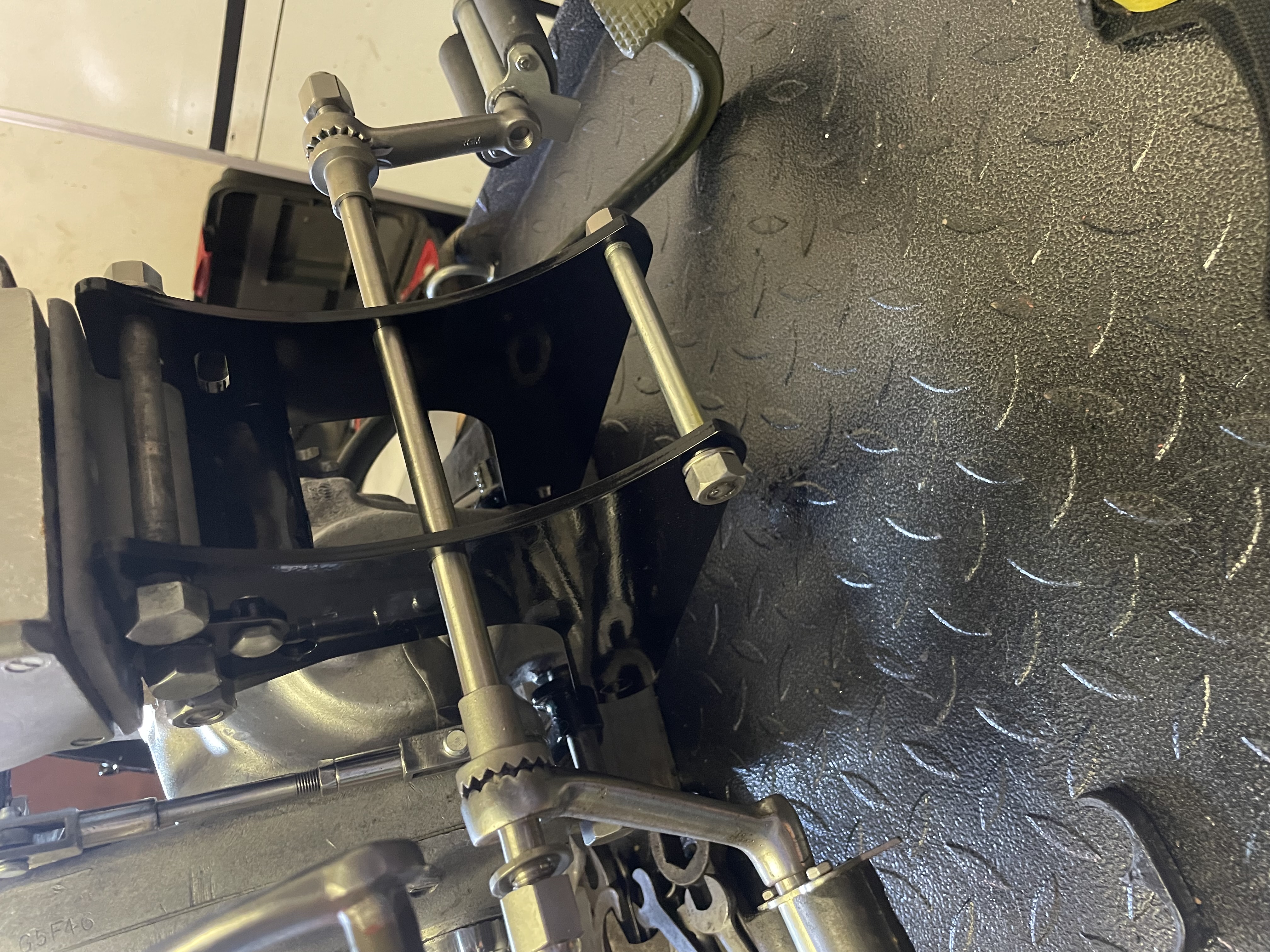

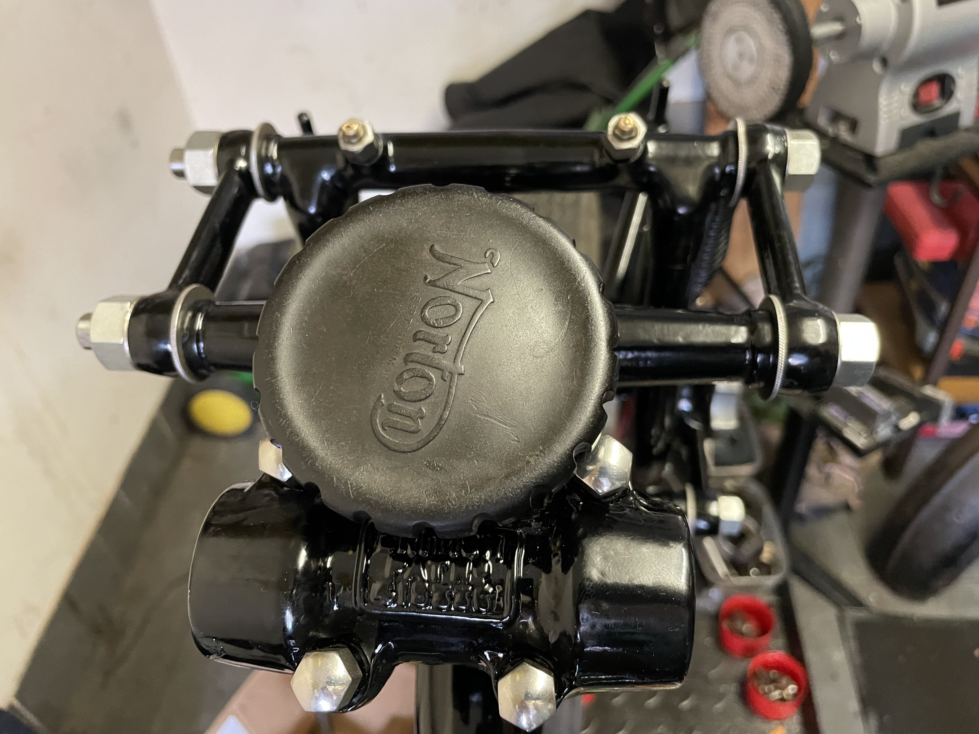

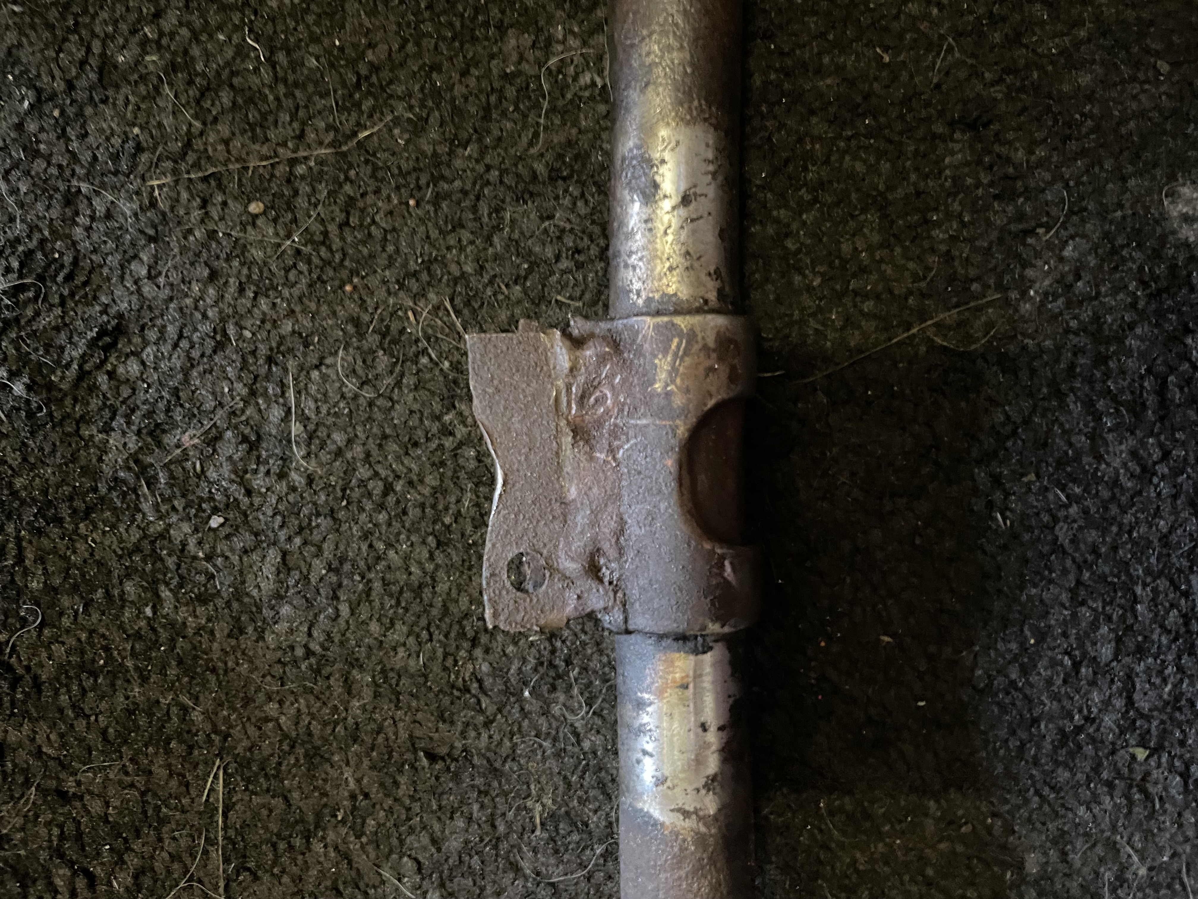

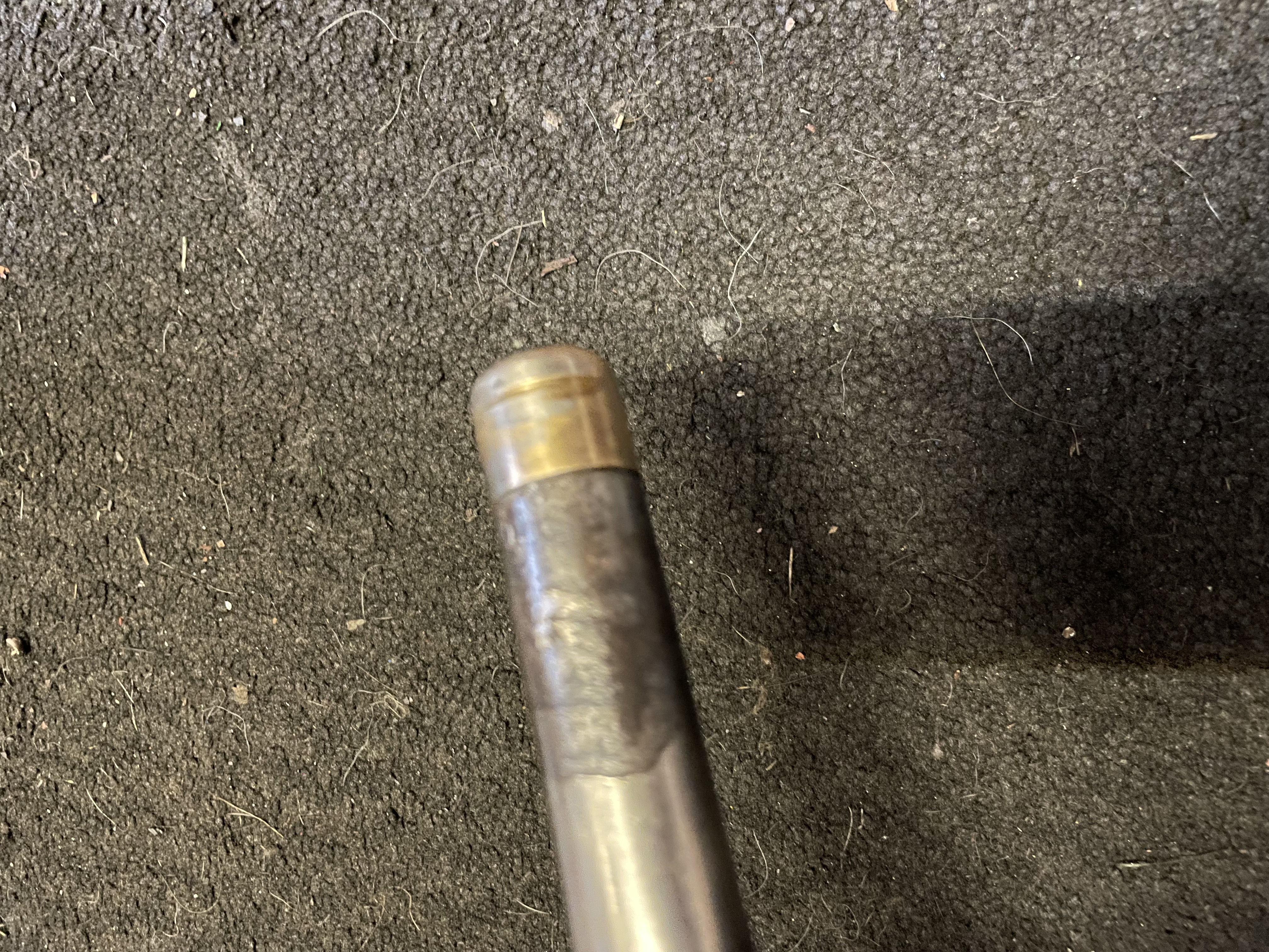

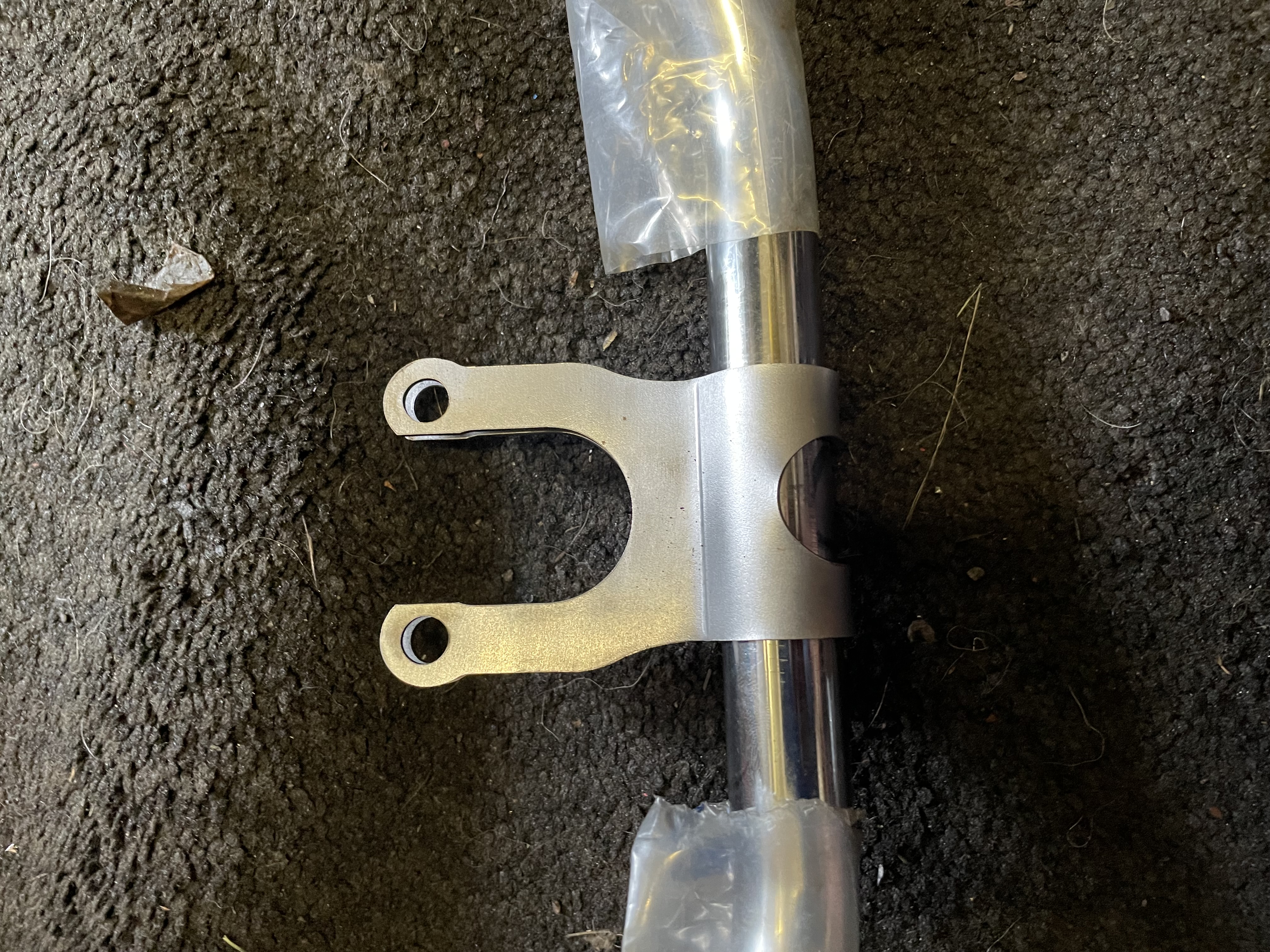

Sadly, the original handlebars were just too far gone to recover being heavily corroded and the original handlebar Brace had been broken and welded many times, However, the handlebar ends, I want to try and recover and put those on the new bars.
A big thank you for Paul at racing Norton For the manufacturer of the new bars and brace to match, See pictures attached
