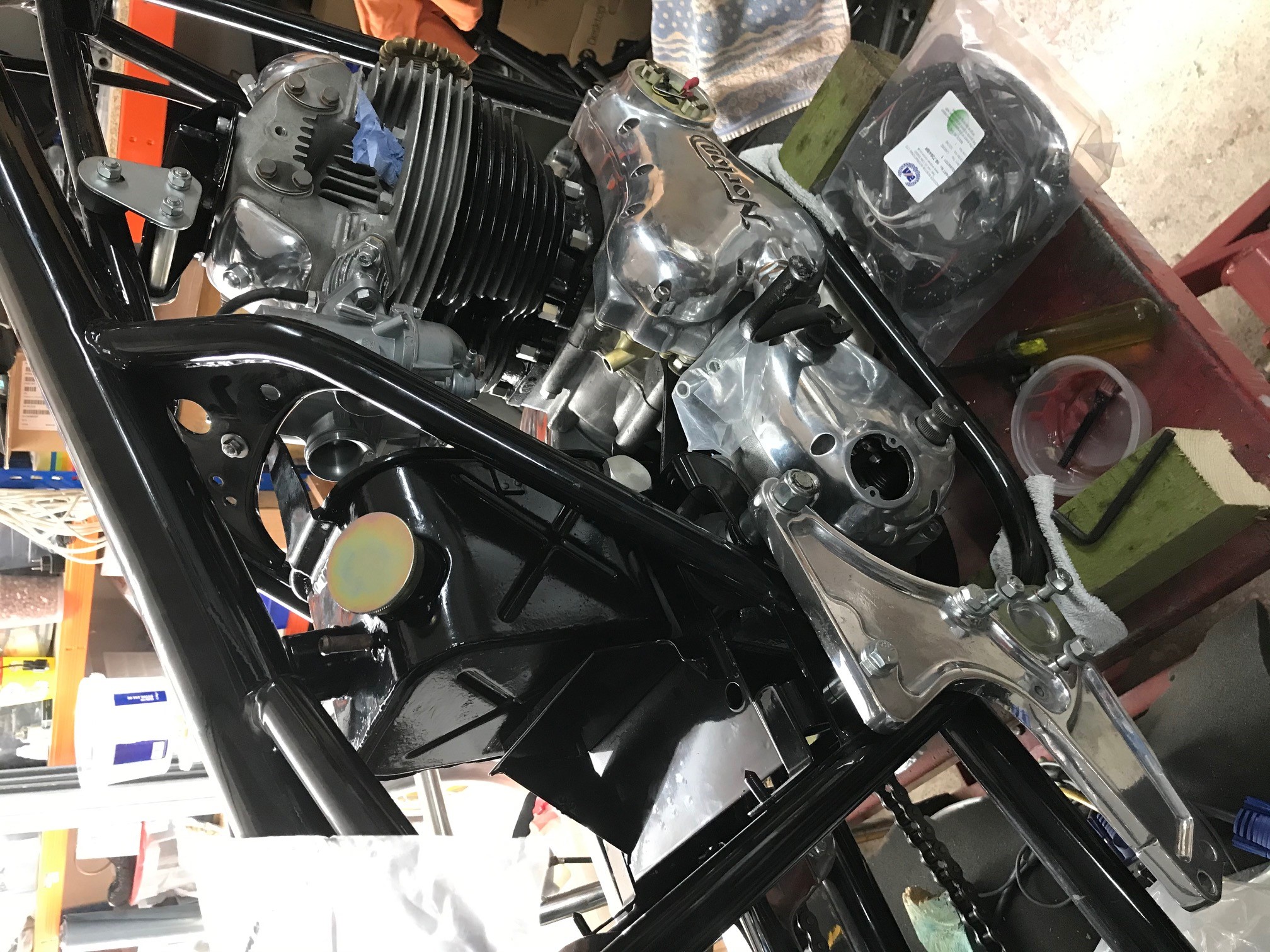

I'm building a 1970 S type, from a basket case, which came with no electricals at all
I have the basic bike complete, (engine, gearbox, primary are in the frame, battery box, oil tank mounted, swing arm in, headlamp shell in - currently up on the bench so once wired the forks and wheels can go in too to become a rolling chassis) now I am trying to work out the cable routes and runs
the wiring diagrams help show colours, but there is nothing I can find to help with the actual routes the harness and "spurs" take
apart from the obvious top run from the headlamp back under the top "spine" and through to the battery box - everything else is a mystery - especially picking up the rear lights, horn, alternator, and a modern regulator / rectifier
i hate running things in, trimming and fastening, only to have to keep removing and re routing
any help, photo's or sketches gratefully received - I can't be the only one stumped with this
Having wired a few bikes especially Nortons-I have always said that the wiring was the very last thing to do on the bike. Yes you need the tank off to do the wiring, but fitting wiring then find some thing later fitted fouls up-not good so fit all the mechanicals first then fit the wiring around them. One rule is that most of the electrical bits really position them-selves so the wires are the 'servants' and connected up to be out of sight as much as possible and out of harms way. The stop light switch on all these bikes being one of the worse areas for fouling, while the steering head has got to be slack to cope with the steering change. This bike already has a changed ignition (Boyer) and changed Reg/Rect so the wiring has to be modified to suit. This is one good reason I do not like 'original' looms. When I wire a bike I prefer to wire the items I am presented with, and hide the wires as much as possible. I hope this helps.
