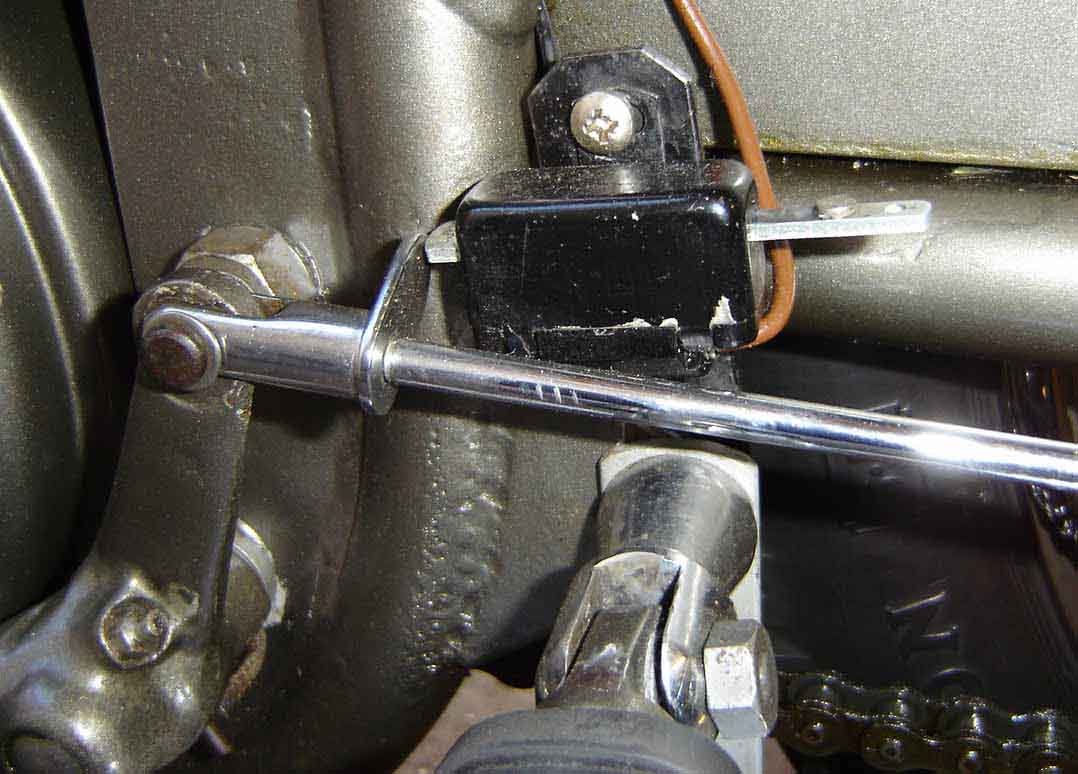

Would it be possible for somebody to post a photo of the correct brake lever and switch setup for the 1959 model 99. I have read that there is a little plate that sits on the brake rod and the switch sits against it on a bracket.
I am not sure exactly what they look like so a photo would be a great help.

These can be hard to find ,dont be confused by almost identical ones fitted to Triumphs which work in the reverse way, although they can be stripped and modified to work. I have an orriginal set-up and will try to post a pic.
Hi, as Robert says, the Norton is different, ie. it is on in the normal position and is pushed off when the brake pedal is released, while most are off in the normal position and pulled on via a spring when the pedal is depressed. I have attached a picture and hope that this illustrates the correct layout and operation, regards Rob

Thanks for the photo, I had seen your correct setup on a slimline that I looked at but I am not an expert on these twins and have looked at a lot of bikes and it seems not one is the same, so its a bit confusing till your get the correct info.
I have a couple of NOS brake switches but they have what I would call the normal operating action, I will have to wait till I find the correct one for the 99, it seems that I can find all the tin ware and hard to get bits then a little thing like the switch holds things up.
Thanks again for going to the trouble to post the photo.

The repro ones are your best bet. Roberts picture is correct in every way, earlier bikes were different.
As it happens I have a 195…
As it happens I have a 1959 '99', which I bought in 1965 as only the second owner, and I confirm that Robert's pic of the switch is correct. (So is the lovely pillion footrest with the tapered lug!) I too bought the wrong switch originally, but the correct ones are easily available - but a lot more expensive that the Triumph type! Only repros of course. It's doubtful you'll ever find a N.O.S. one, which were metal bodied by the way. The correct Norton switch is "Normally On" in electrician's parlance. In the photo it is pushed off. Use that pic to identify the correct switch. The others are orientated differently so you can tell just from a photo. The bracket in the photo isn't correct though. The rightbrackets are available from Fred Williams at an autojumble. I think I bought my correct switch from Sparx at a Stafford show, although my original 1959 one still works, but is a bit tatty!
Cheers, Lionel

I think the frame ear has been cut down, it should have 2 holes,1 for switch mount,1 for footrest, I too have an orrig worn switch which still works, not bad for 50 years use.

Hi Alan and Andy - as I said earlier, I thought I bought mine from Sparx and they have one here:
http://www.tri-corengland.com/acatalog/Triumph---Norton-Brake-light-switch-SPX016.html. Priced at £15 +VAT makes it £18. It should be Lucas No.31383 according to my Lucas lists and Sparx list this number against that item. I do remember it wasa lot dearer than one I bought before - the wrong one! They go for around £5 to £10 new at shows. I have seen these for £19 at shows too - they aren't rare.
The Norton one needs to be normally 'on'. I.e. in its resting state the switch should be 'on'. When the brake arm is released it pushes the switch plate onto the brake switch, pushes the slider alongand switches it 'off'. With many other makes it's usually the other way around where a spring is used to pull the switch 'on' when you operate the brake lever.

Thanks very much for info, that looks like the right one to me.
Alan
