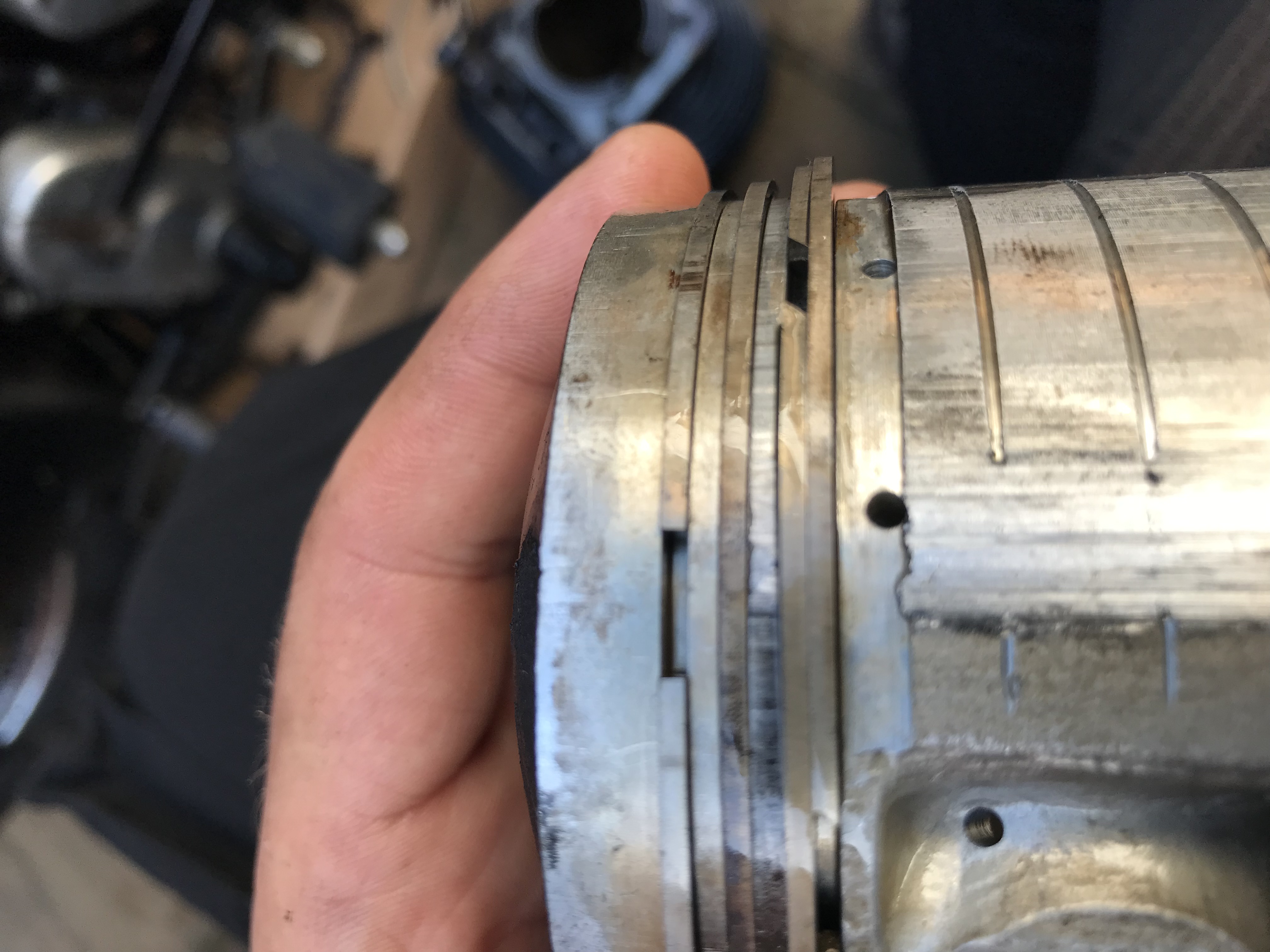

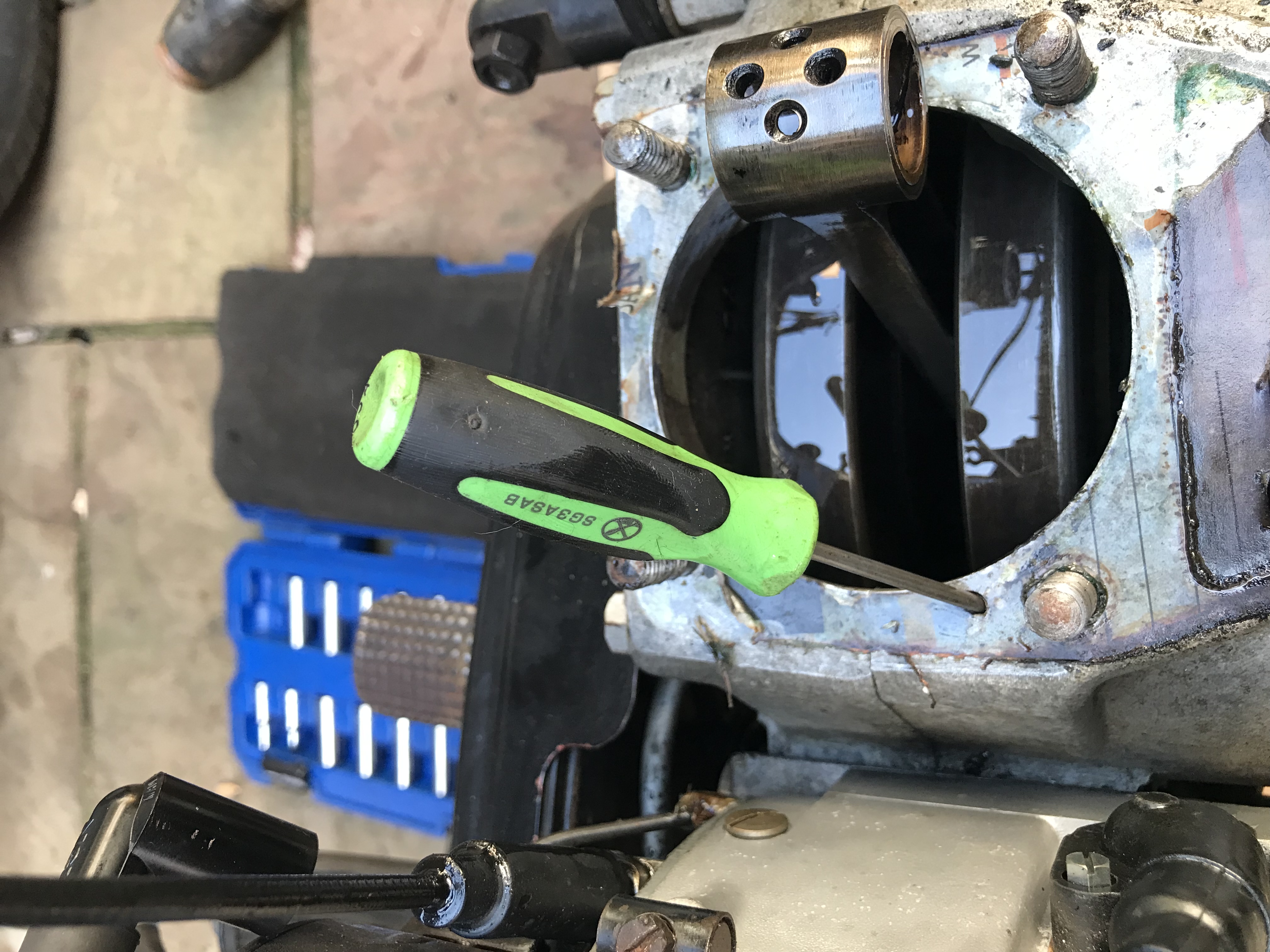

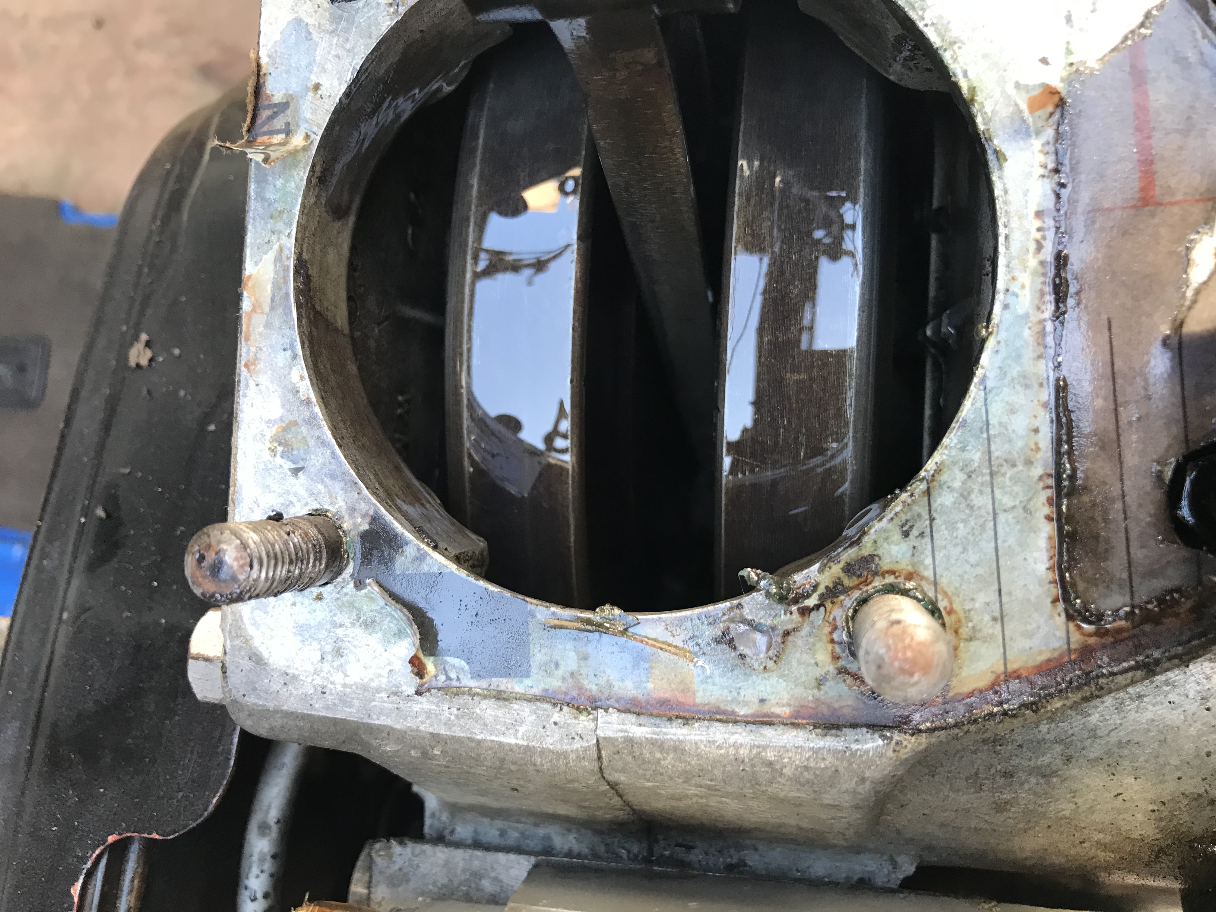

Found the problem. Whoever…
Found the problem. Whoever rebuilt the engine blocked the oiling port at the base of the cylinder with gasket.
to say I am annoyed is an understatement!

Incidentally, has it not covered too many miles since last re bore? I have learned a long time ago that a 4 thou interference tolerance works to start with.
As Jonathon says: More info please.
Interference?
... I think you mean clearance. And in my opinion .004" is far too tight - I use at least .006" - .007". Modern rebore places are not familiar with the generous clearances required by our old engines. I'd rather have a bit of piston slap than constant worry about it tightening up.
As a point of interest Edgar Franks suggested reboring when the original bore was worn by .007" - ie a clearance of around .012".
It might also be a bit…
It might also be a bit retarded. Bacon's Norton Singles lists 0.375" (3/16) but it should be at least 7/16", or it will run hot.
That is a 4 point seizure,…
That is a 4 point seizure, piston overheating is the normal cause as these 4 points are where the alloy is thickness and hence expands the most on excess heating of the piston.
Spot on John…
If that’s the worst it should clean up, but as John says that is more than rear oil feed issue. As Neil and Ian elude to, clearance could be low. Shiny oil is not synthetic I hope; it will never bed in with such high quality lube. Check your clearance, maybe a light hone and your good to go, but gently for a while…

Hi John / Jon,
Mineral oil the stuff to use in an old single. I use SAE50 in mine during warmer weather.
But I'm wondering if the lock up and damage would have happened @ 40 mph, I believe not.
Of course the blocked oil way didn't help and good that it has been identified.
A light hone so important at this stage. Good luck, Kevin.
