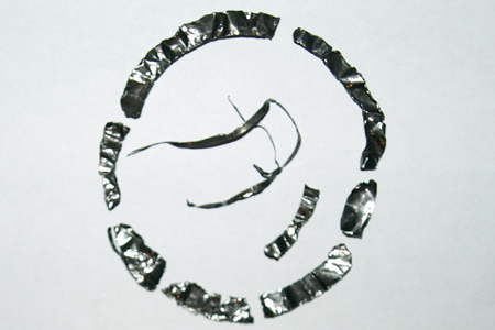

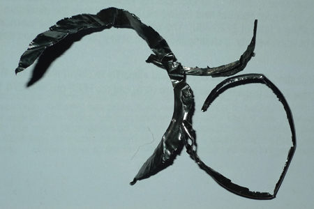

Hi Can anyone tell me why i need a filter in the sump plug .Thanks Steve
Because this can happen ..…
..... and in the case of a…
..... and in the case of another Commando owner, this:-

The pictures show engine d…
The pictures show engine debris which has been prevented from being circulated by the oil pump by the filter. You don't need the filter, but if any part of your engine starts to fail, bits of sharp metal will fall to the sump, be sucked through the oil pump and fed to the big ends and top end. Again and again. So the choice to keep it or leave it out is entirely up to you. Gordon.
Steve, The symptoms in bot…
Steve,
The symptoms in both the cases shown above would have been increased crankshaft end float. The remains in both cases are those of crankshaft shims.
