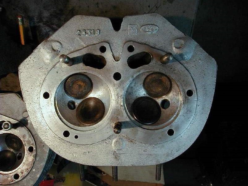

About Turn
I appreciated that camera angles can lead to distorted views but that Right Hand piston looks 180* wrong. On the 750 engines, the larger inlet valves sit inboard from the piston edges. This in turn leaves a crescent of metal between the valve cutaway and the piston edge.
Below is a late roughly post-1966 Atlas cylinder head.
