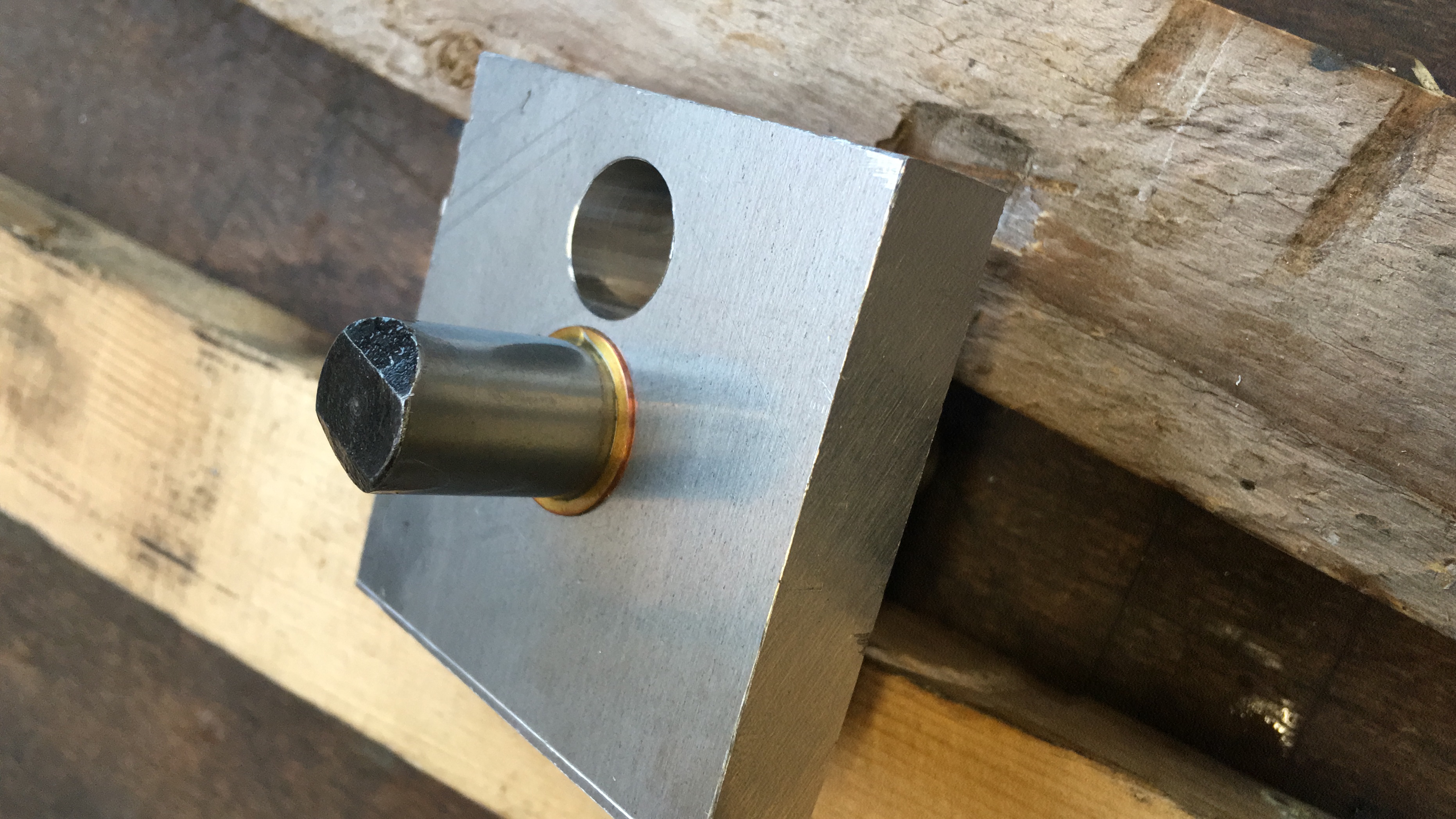

SRM have come back with a reasonable quote for what is a tricky job. It's still a hefty amount of money so I've got that on hold while I have a play with doing it myself. Bought a damaged head from the NOC shop for £25 to have a practice on.
Making progress with this…
Making progress with this. Got the bush and hole sizes (fits) sussed so I can order some reamers. A cold spindle will slide into a hot piece of aluminium (180c) but lock in place once equalised. It'll come out with the extractor when it's hot without pulling the bush out. The bush is shrunk in with dry ice when the aluminium is at 180c. Now in the process of setting up for drilling the holes out for the bushes. It'll be a few weeks before I tackle my head I expect. Saw one up on eBay for £2000 the other day so I'd better be careful. It's the 500ss head.
