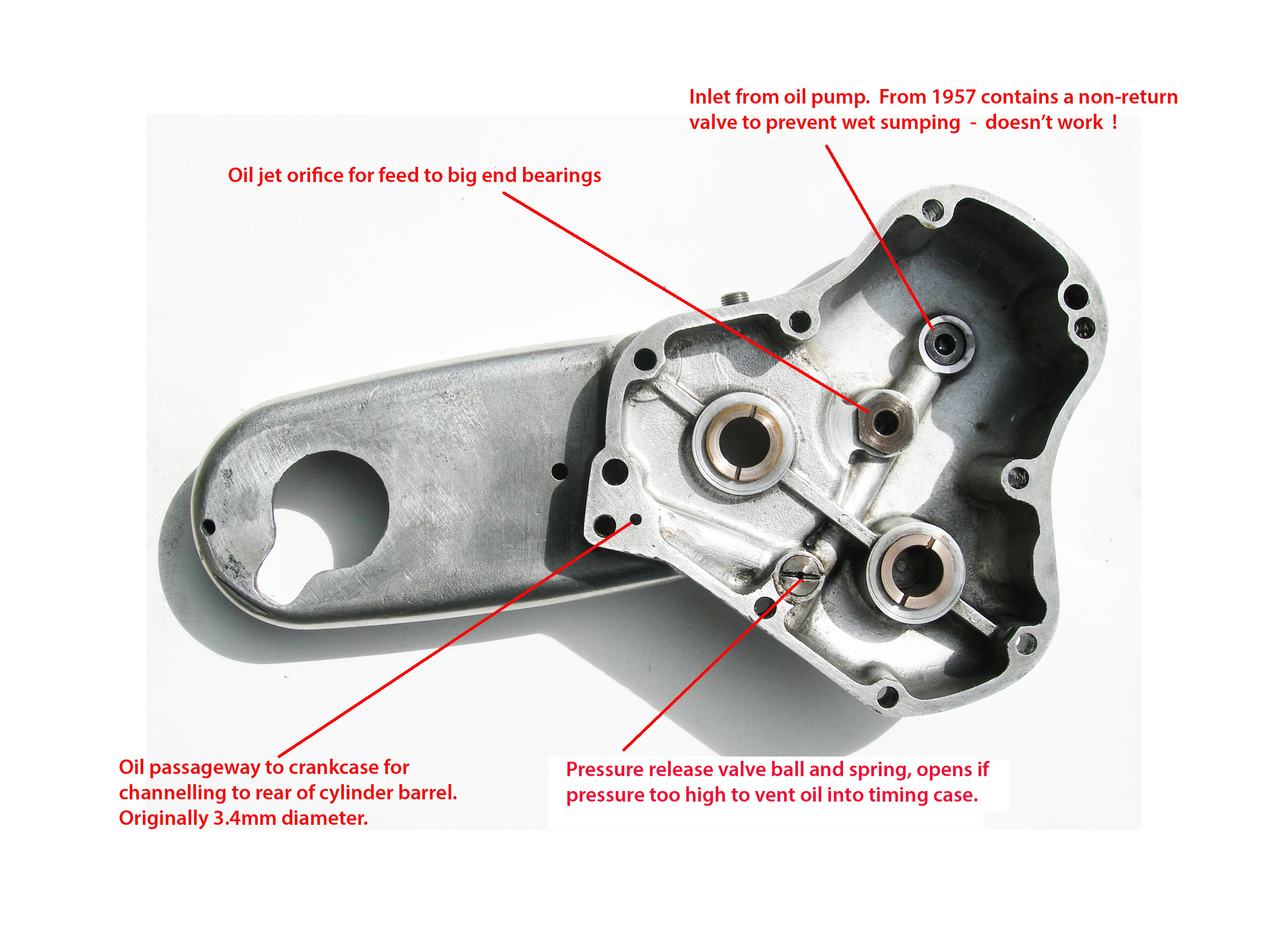

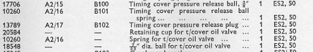

....of my '61 ES2 there was an anti-sumping valve built into the timing cover. It doesn't show in the parts list drawing but there is a spring, ball, and cup listed. This is not the pressure relief valve which is shown in the drawing.  That bike never sumped up, even after sitting for years. When was this introduced?
valve
Hi Michael.......are the parts you highlight the Singles version of a pressure relief system? But in this case using a ball and spring (singles) instead of a piston and spring (twins). The 1959 parts book shows a diagram of the single with the relevant parts marked with B100 & B101,
...seems to have first appeared in 1957 with the major redesign.  When I put my now-gone ES2 together back in the early '80s I puzzled over this and reasoned by the oil pathway that it was an anti-sumping feature. A dim memory and perhaps mistaken.  Maybe someone has one apart now to confirm.

...making the onboard antisumping valve work. As mentioned, it will work well if it is clean and intact. A downstream valve (from the pump) is far preferable to upstream and won't fail closed.
