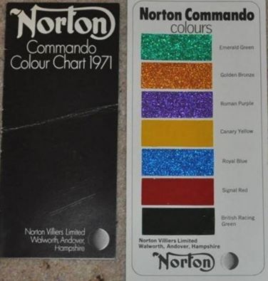

Any chance of someone posting a pic of a machine in Interstate Blue? I cant seem to find one
Which Colour
Les. I'm not sure if this is Interstate Blue as I have only had my 1972 Combat for five years. I normally ride Velocettes, not in the usual black and gold but in willow green just to be different.
Thanks for the photo and the…
Thanks for the photo and the confirmation. Does anyone know of either a source for this paint or a colour code reference?
Try these
https://www.rsbikepaint.com/en-gb/colours.php#makeid=114&modelid=3915&prodyear=1972
I used these to supply the signal red paint for my roadster.
I have been through all the…
I have been through all the options and cant find a blue for the Interstate, so I will have to give them a call
Water based paint
I bought my paint from RS but the stuff they sent was the water based stuff which I hadn`t used before. You have to get it on perfect first time as you can`t rub it down to put another coat on as it just peels and so is a nightmare. Ask them if they can do your colour in celly if you`re not used to this new stuff and save yourself a load of grief!
Regards, Al.
