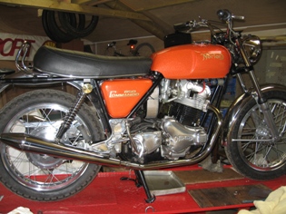

I re trued the front wheel today .. what a fab job. So pleased was I with the almost faultless rotation, until that is I put it on the bike. Now the wheel rim was sitting 1/8 inch nearer the l/h fork leg. I have Akront wm2 rim and Mk2a Disc hub, does anyone else have this set up? If so could you please tell me what the correct measurement is from a straight edge accross hub to the rim edge.
Many Thanks
Gary
Ps this is what it is looking like now the bike not the wheel!
Attachments NORTON-OC.jpgPreviously wrote: Hello Al…
