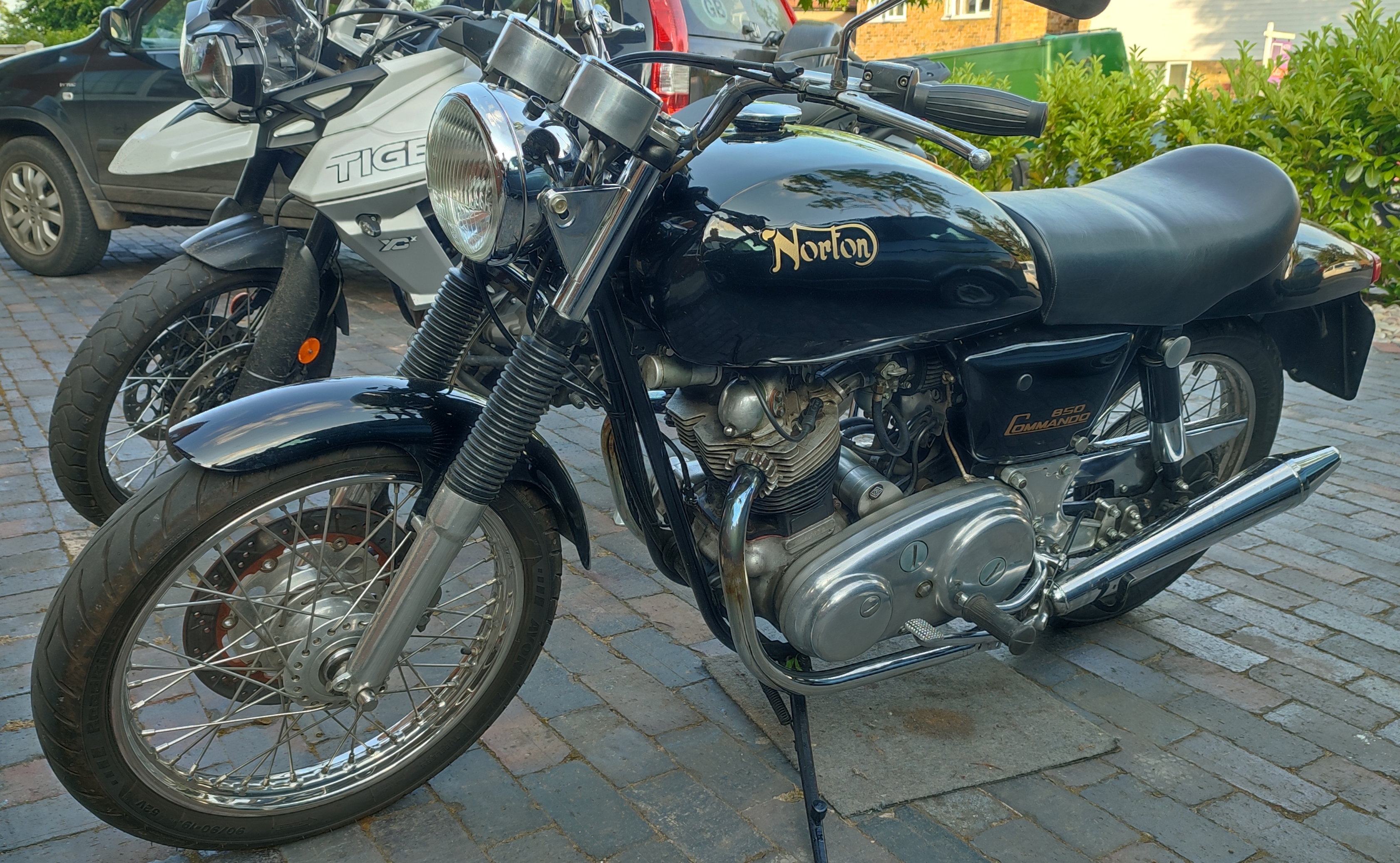

Despite having owned over 25 motorcycles over the last 40 years ( mainly Laverda), I've never had a British Bike before. I decided I should put this right, and as I always liked the look of the Commando's I've recently purchased a Mk2A fastback from the NOC classifieds. Picture attached.
It's been recently rebuilt by someone who seems to know what he was doing, it starts and runs well and pulls like a train. However,......( there is always a " however" !)
...I am not impressed with the handling. It's great at low speeds round country lanes, but as soon as it's on the open road, above approx 65 mph it has a tendency to weave like a demented chicken being chased by a fox. The first time it nearly had me off the bike.
After much reading of the forums, t'internet, and talking to the more knowledgeable, I have tightened the vernier iso-elastic blocks up hard ( I understand the police used to do this ?) I have just about new Avon RoadRider tyres, and have increased the pressures to 30/32. This has slightly improved matters and I can normally get to about 72 before the weaving starts...but I still do not feel it's correct, and am very unhappy with the handling.
The forks and shocks appear ok, with decent rebound damping, and the wheel alignment seems ok to the best of my knowledge. Rear shock is set to least spring preload ( would increasing this help - I'm 15stone?)
The head bearings etc are as they should be.
Questions..is this the best I can expect from a Commando 850 ?
I know it won't hurt, but is wheel balancing something I should look to as a root cause?
Any other suggestion as to most likely areas to work on would be gratefully received.
Many thanks,
David

Killer weave sorted.
The dangerous element of the handling has been eliminated. It was as simple as increasing the preload on the rear shock absorbers !
I'm happy to ride the bike at over 90 mph now without the impression that the bike is trying to kill me.
I'm sure that the handling can be refined significantly however, so will go through everyone's suggestions in turn.
Thanks so much for everyone's input and advise, it's all been greatly appreciated.
